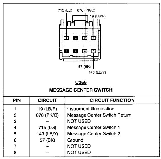

Recently my instant milage per gallon stopped working in my dash. (I recently had a heater core replaced). How would I fix this issue without buying a new dash? It doesn't work on metric also.

That s the only issue I have. The milage will work somewhat for a few minutes then it rolls up to 99 and stops. the metric stops on 2 the goes to 99 the same. thanks

The local mechanic was unable to repair this, cannot isolate part to replace.

Thanks for the update. Electrical issues can be such a headache. You indicated this happened after the heater core was replaced. I suspect the wiring under the dash was disrupted. It could be a ground wire that was disconnected.

The local mechanic ran through all the checks and couldn't find anything, so he quit working on it, hopefully I hear something sometime. thanks

Anyway, I don't think it is a component issue. Instead, I suspect it is a wiring issue.
Check behind the message center to make sure the wiring isn't damaged, and the connector is good. I attached a pic below showing the switch connector for your reference.
Let me know. When the heater core was removed, they damaged something.
See pic below.
