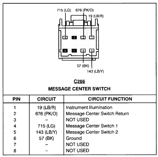

Recently my instant milage per gallon stopped working in my dash. (I recently had a heater core replaced). How would I fix this issue without buying a new dash? It doesn't work on metric also.

Have you inspected the wiring to the circuit? Also, are there any other issues that resulted from the heater core being replaced?
Let me know if there are any other issues. For example, if there is an ABS sensor light on, that could be preventing the computer from calculating MPG. It's a theory. However, since the heater core was replaced, I feel it is likely a loose wire at the dash.

That s the only issue I have. The milage will work somewhat for a few minutes then it rolls up to 99 and stops. the metric stops on 2 the goes to 99 the same. thanks

The local mechanic was unable to repair this, cannot isolate part to replace.

Thanks for the update. Electrical issues can be such a headache. You indicated this happened after the heater core was replaced. I suspect the wiring under the dash was disrupted. It could be a ground wire that was disconnected.

Anyway, I don't think it is a component issue. Instead, I suspect it is a wiring issue.
Check behind the message center to make sure the wiring isn't damaged, and the connector is good. I attached a pic below showing the switch connector for your reference.
Let me know. When the heater core was removed, they damaged something.
See pic below.
