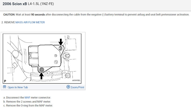

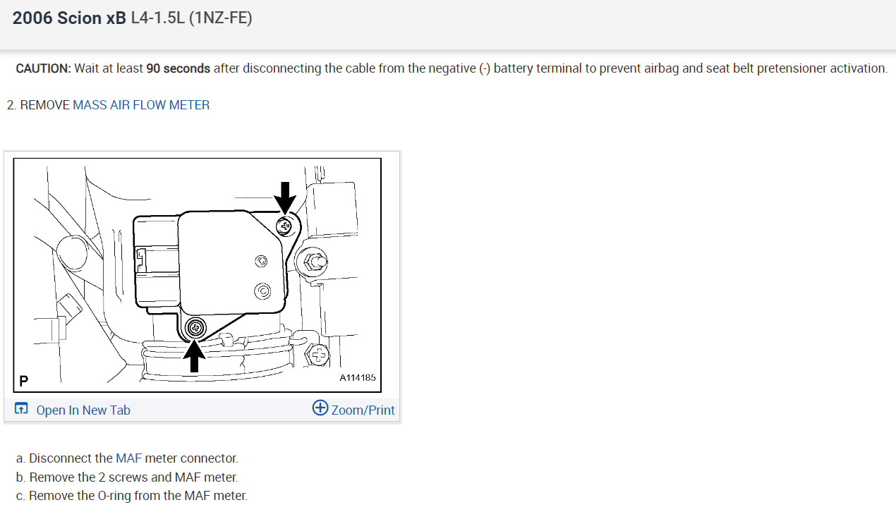

An exhaust leak will cause this issue as well, does the engine have one?
P0171 - System Too Lean (Bank 1)
P0133 - Oxygen Sensor Circuit Slow Response (Bank 1, Sensor 1)
P2195 - O2 Sensor Signal Stuck Lean (Bank 1, Sensor 1)
Please go over this guide as well.
https://www.2carpros.com/articles/repair-lean-mixture-codes-p0171-or-p0174-on-some-manufacturers
If not, I would replace the MAF sensor, cleaning it will not help at this point. Here is the correct way to do the job. Clear the codes once the job is completed. Check out the images (below). Please let us know what happens.
