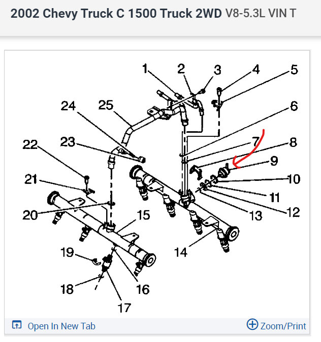

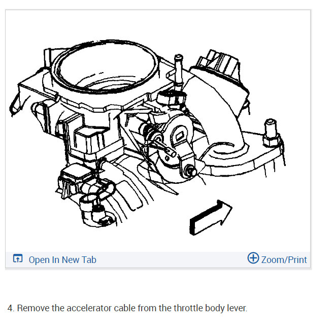

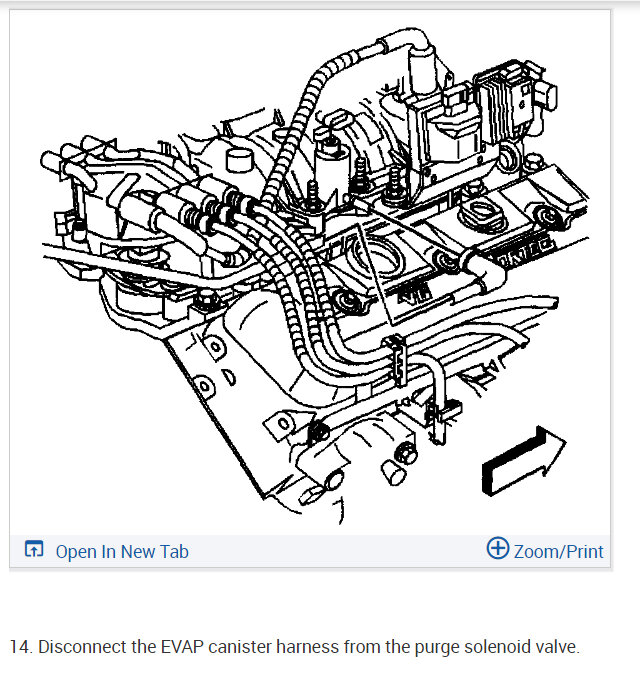

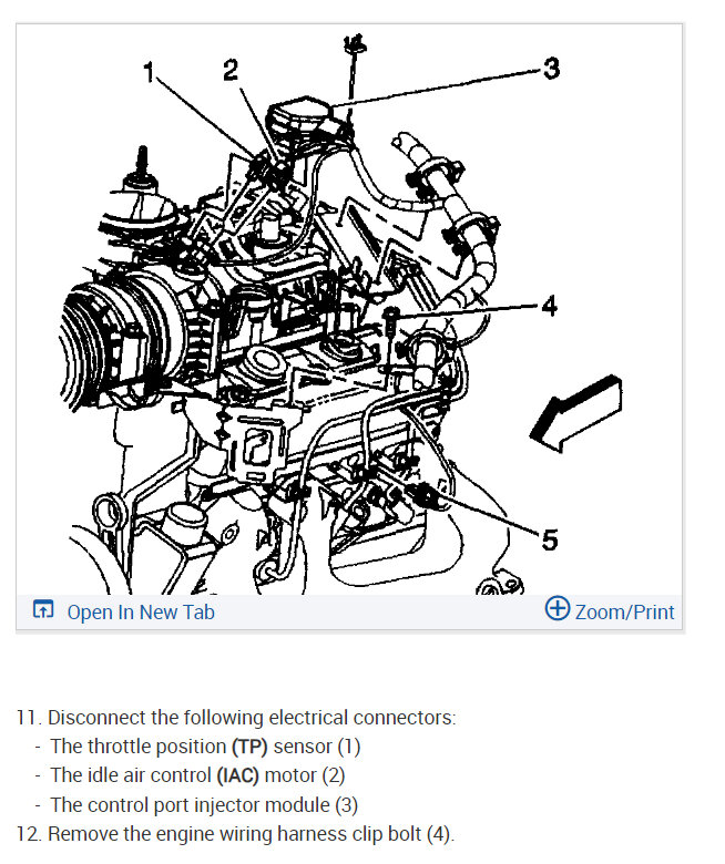

You will get lean codes with the engine misfiring; did you clear the codes after the tune up? Also, how did the spark plugs look? This engine has a fuel pressure regulator which I would remove the vacuum line from, if gas is present the regulator is bad, here is the location so you can check it out.
Even though you have a new fuel pump it could be defective. I would do a pressure test by following this guide.
You can rent the gauge at the auto parts store for cheap or free. If you have low fuel pressure you will smell gas when the engine is hard starting.

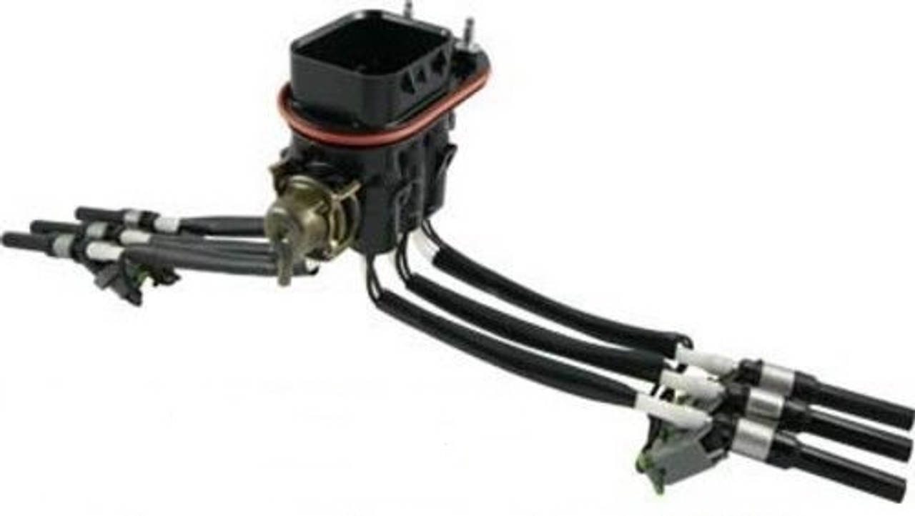

The fuel pressure regulator is attached to the back of my spider fuel injector just below throttle body, right? I have replaced the throttle body gasket both oval shaped one and the one that seals the top housing of the spider injector compartment, could I have a vacuum leak in that area?

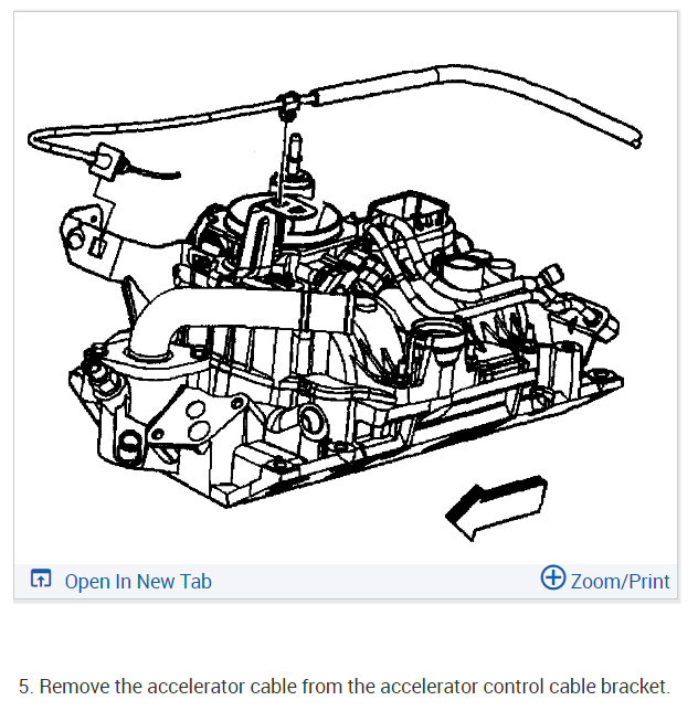

This engine does not use the spider fuel injector? Please look at the image I posted. With these numbers you could have a vacuum leak. I would use a smoke machine to check for a leak.

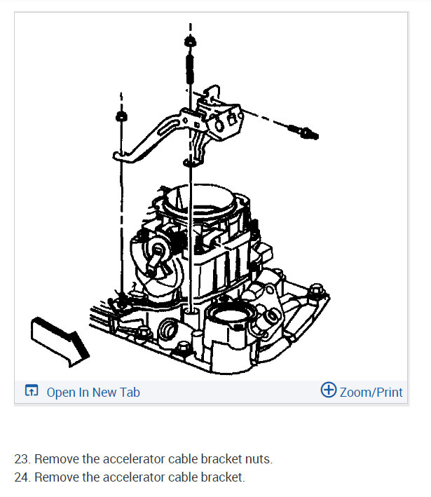

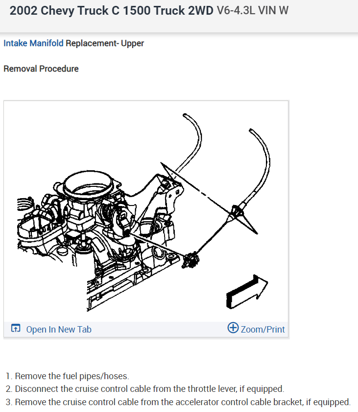

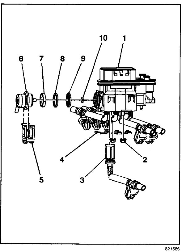

This is the fuel injection system I have on my truck I think the picture is of updated version but it’s the same physical setup.
Jul 23, 2024 at 5:50 AM
  • 55,433 POSTS
This injector is for the v6 engine. Can you confirm the engine size?
Jul 24, 2024 at 2:18 AM
TONY BRISENDINE
  • 5 POSTS
4.3 v6.

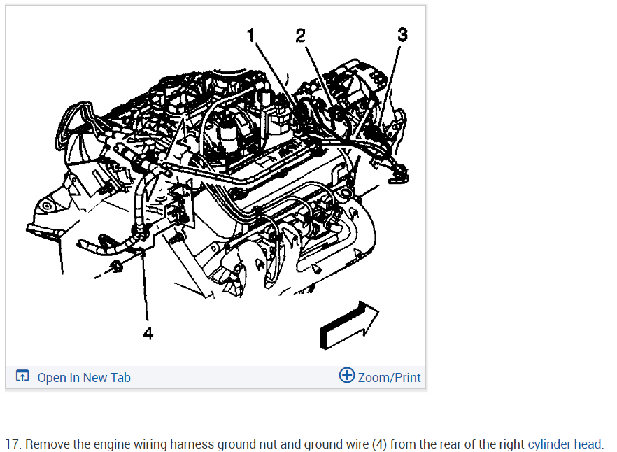

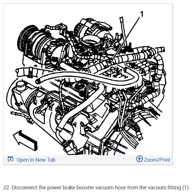

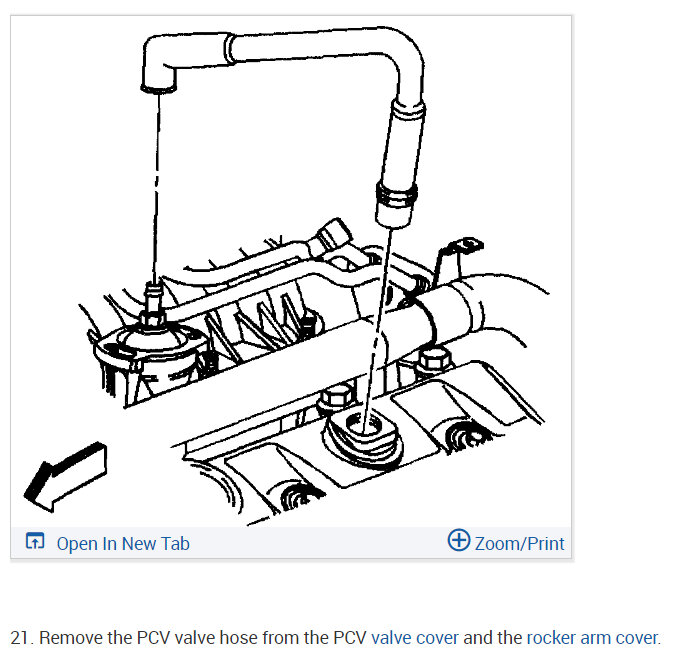

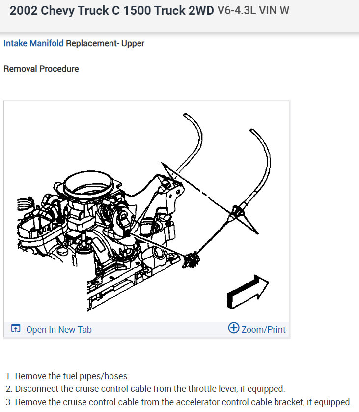

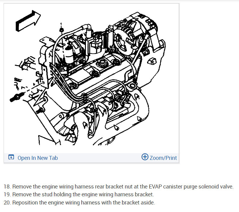

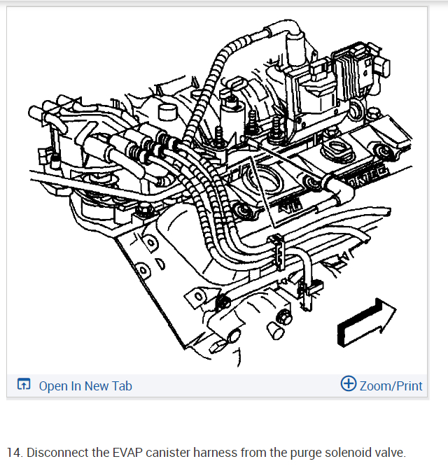

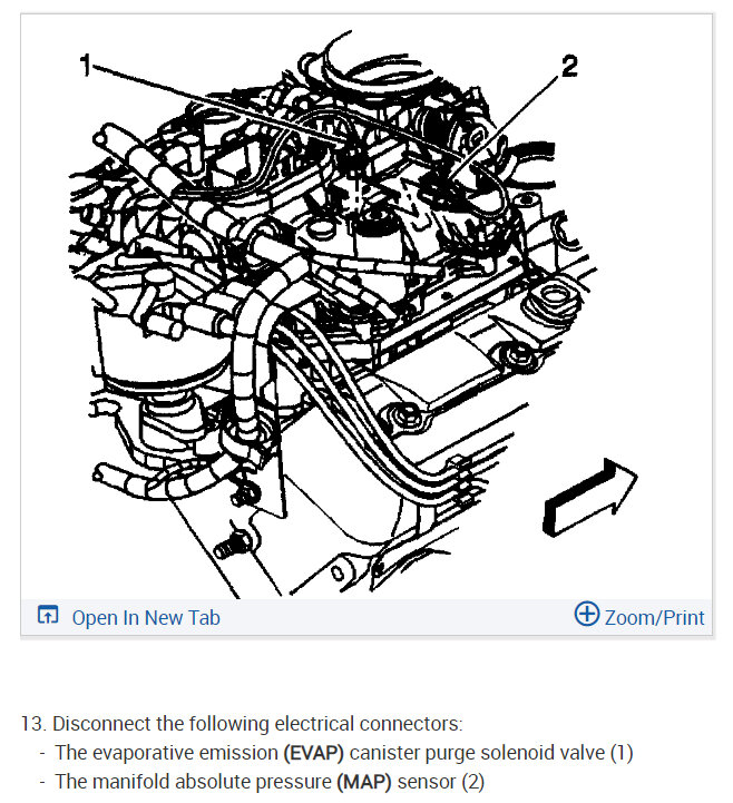

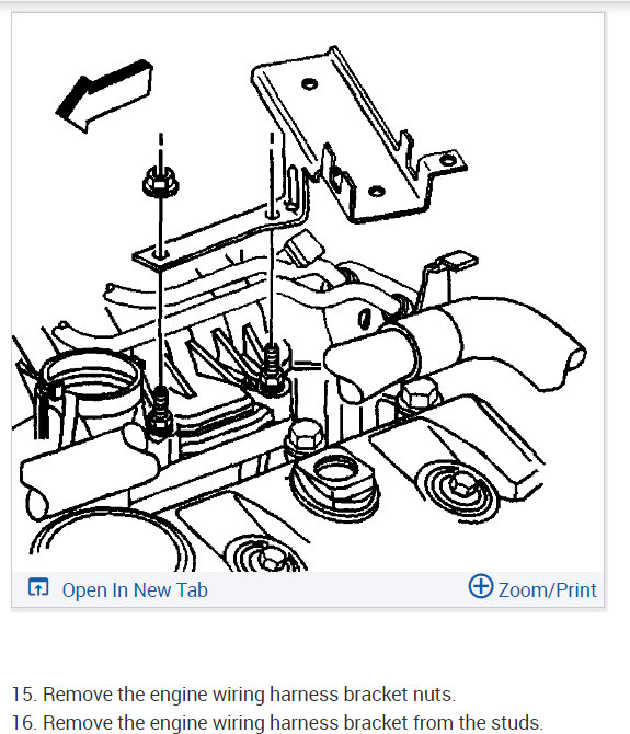

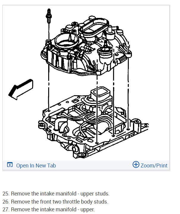

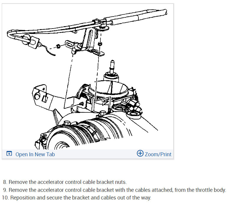

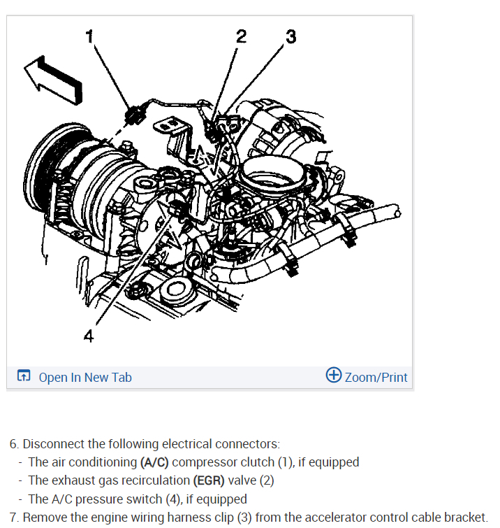

That sound can be caused by low compression. But the fuel pressure regulator can still be bad, which they are known for in these engines. Here is how you check the 4.3-liter engine. Check out the images (below). Let us know how it goes.
