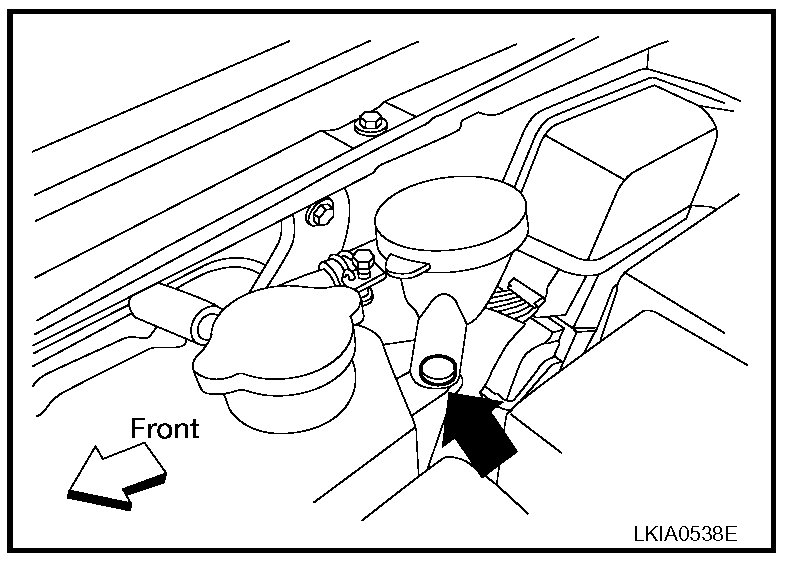

I have a leaking washer fluid.everytime i refill the washer fluid it goes out really fast.

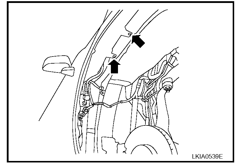

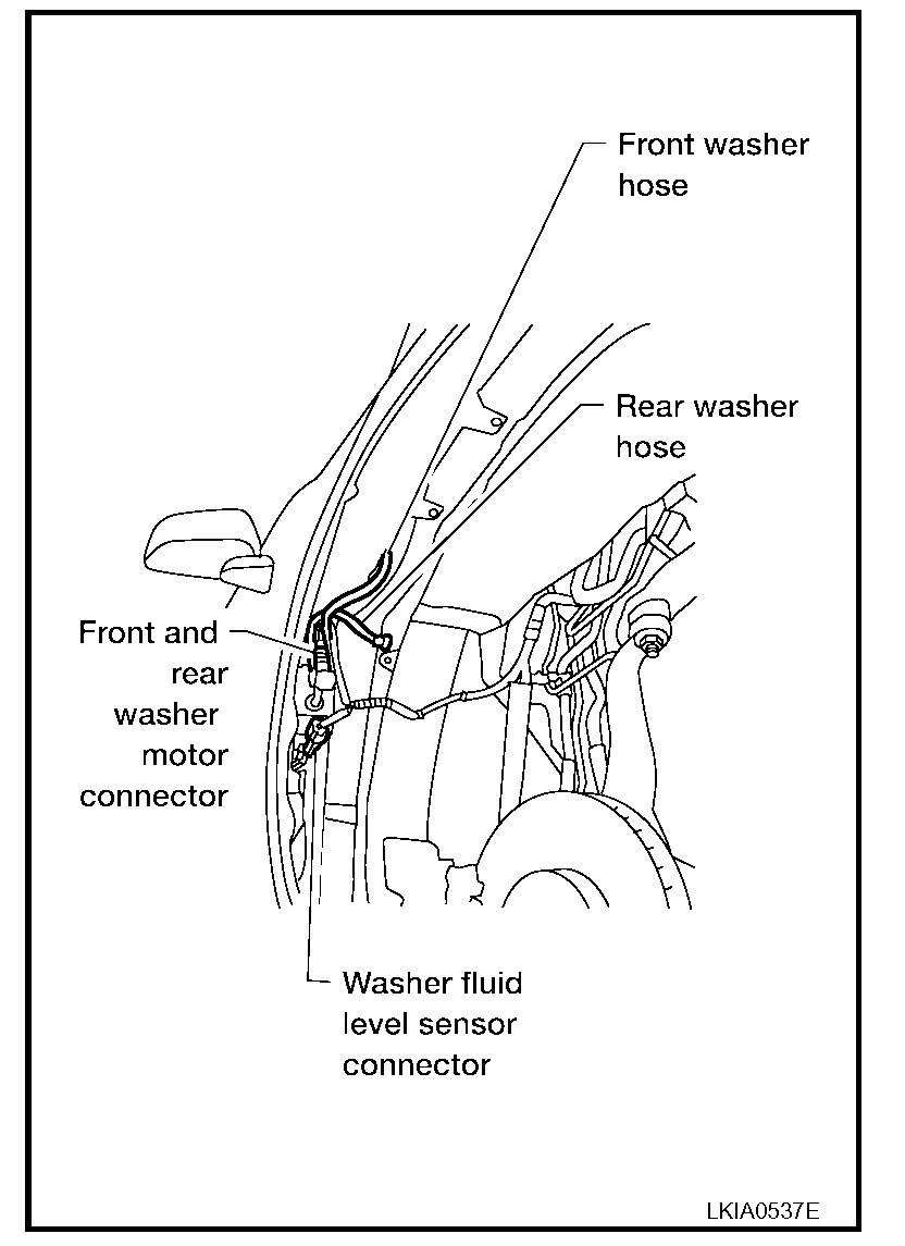

Chances are the reservoir is cracked or the pump is leaking. What I suggest is removing the tank for inspections. Here are the directions for removal. The attached pictures correlate with these directions.
_________________________
FRONT AND REAR WASHER FLUID RESERVOIR
Removal
1. Remove passenger front fender protector.
Picture 1
2. Remove clip, then remove washer fluid reservoir filler neck from washer fluid reservoir.
Picture 2
3. Disconnect front and rear washer hoses.
4. Disconnect front and rear washer motor connector.
5. Disconnect washer fluid level sensor connector.
Picture 3
6. Remove washer fluid reservoir screws and remove washer fluid reservoir.
