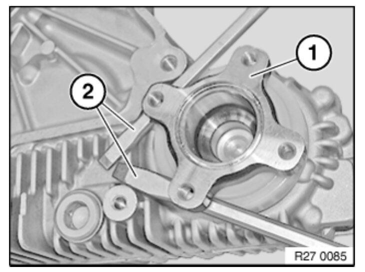

Car is leaking oil from front drivers side axle. Where and why would this be leaking.

This model isn't offered in the US, but I will try my best to help.
When you say it is leaking from the driver's side axle, I assume you are referring to where the axle is attached to the transmission. If that is correct, there is an axle seal that may be the issue.
I used a pic from a 328 x drive to give you an idea of what I am referring to. In the picture, you will see screwdrivers behind the output flange. Once the axle is disconnected, the output flange can be pried off. Behind it is a radial shaft seal. On this vehicle, which would be removed and replaced.
Let me know if this helps.
