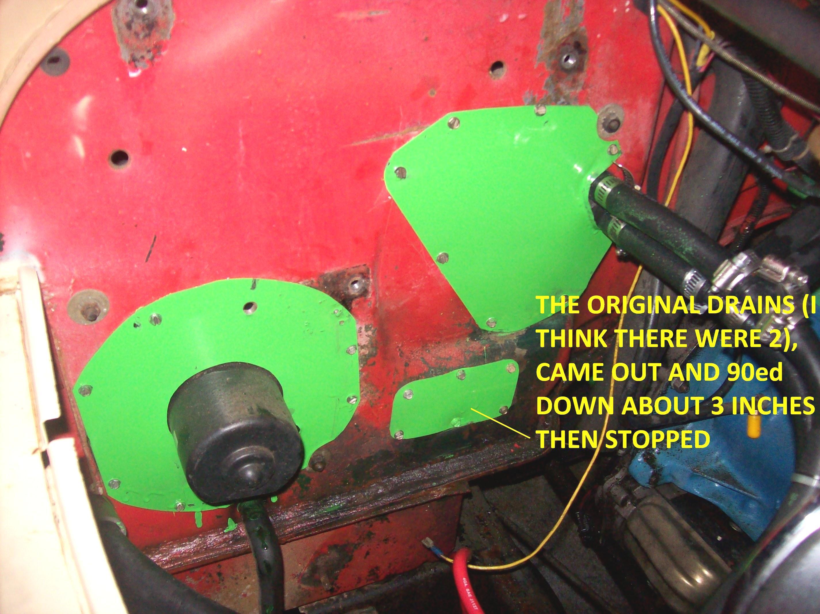

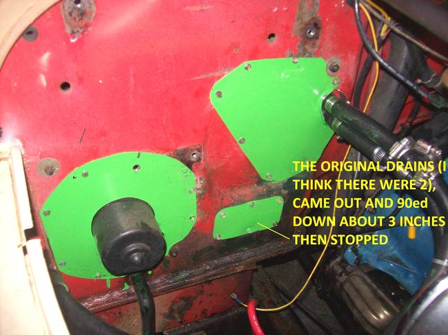

MAYBE THE DRAIN IS STOPPED UP?
SEE THIS LINK
http://www.2carpros.com/questions/2009-buick-la-crosse-clogged-drain
PICS BELOW IS HOW EZ MINE IS (AFTER A ONE TIME MODIFICATION!)
STEP 1 REMOVE BATTERY AND TRAY (USED TO BE UNHOOK EVERYTHING ON DASH, THEN REMOVE DASH AND WHOLE HEATER ASSEMBLY)

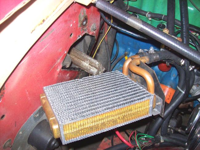

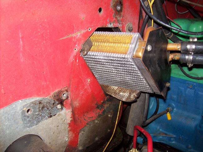

DEPENDING ON MORE MODIFYING (FOR DEFROST)
MY SECONDARY HOMEMADE HEATER (FOR THOSE REALLY COLD DAYS IN A SOFT TOP)
AT MINIMUM-MAKES YOU REALLY TOASTY
IT COULD BE AN ALTERNATIVE, IF YOU ARE SORTA HANDY!
MY 1st ONE (NOW USED IN MY '46, WHEN I PUT ON THE HARDTOP) IS MADE OF WOOD
THE 2nd I CONSTRUCTED OUT OF SHEET METAL IN MY BUDDY'S HVAC DUCT WORK SHOP, IT'S IN THE '77. PRETTY MUCH THE SAME DESIGN. A CAREFULLY PICKED OUT FORD HEATER CORE MATCHED WITH A CHEVY BLOWER MOTOR AND SQUIRREL CAGE
