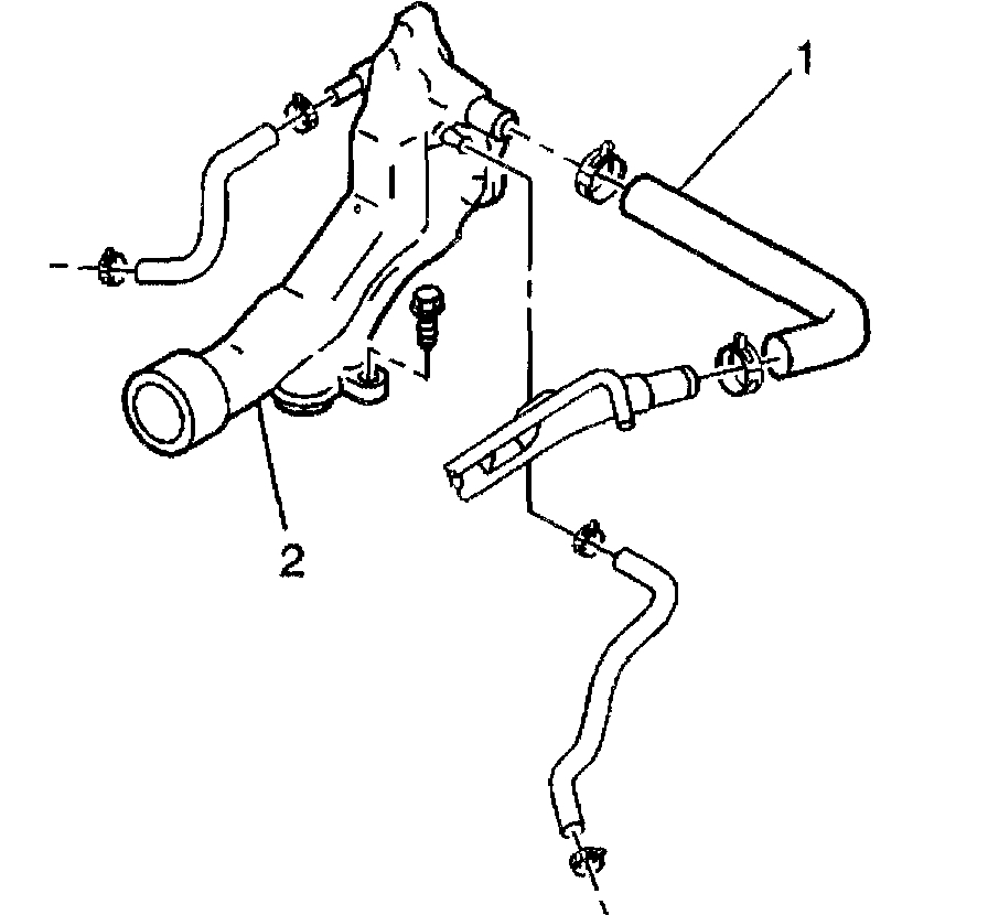

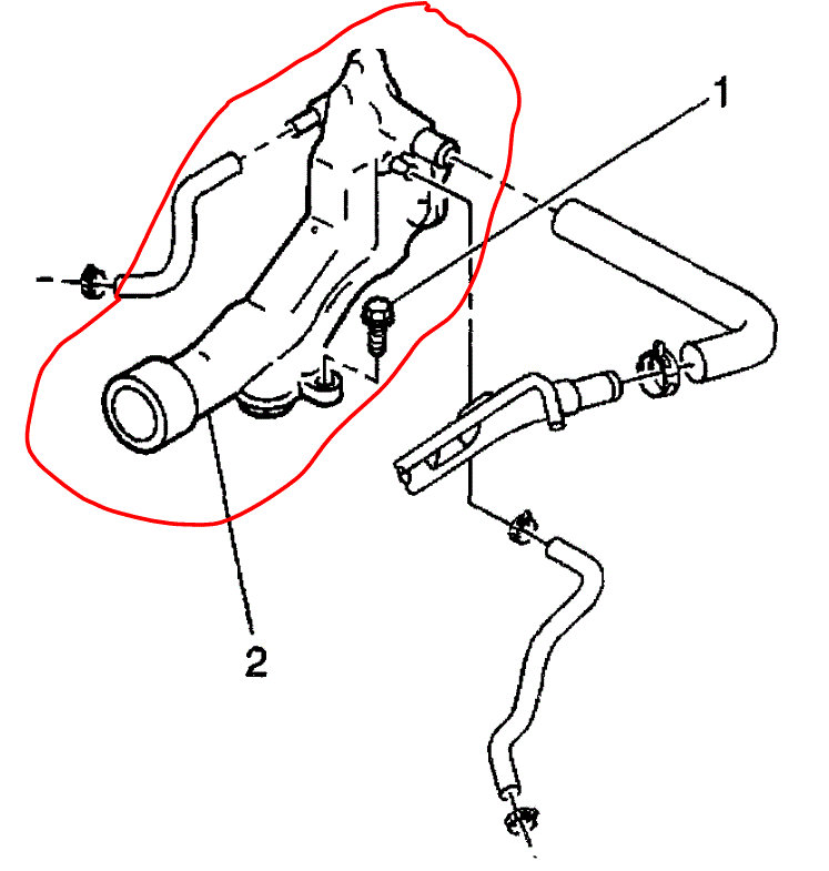

The upper hose attaches to the thermostat housing. See pic 1 below. And yes, there is a gasket. However, if there is a repair that looks like jb weld or other product, it sounds like there was a crack in the housing,
Do me a favor. Take a pic of it so I can see what you are dealing with and upload it for me to see.
If you can't, try to remove the "weld" product. I can't be sure, but chances are it's there to repair a crack or damage to the housing.

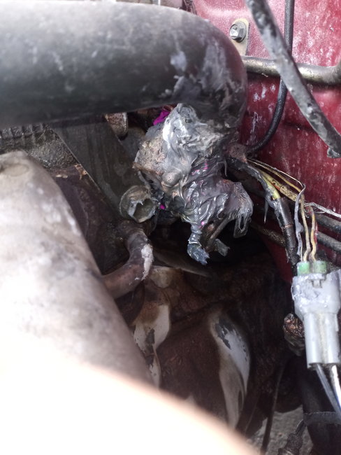

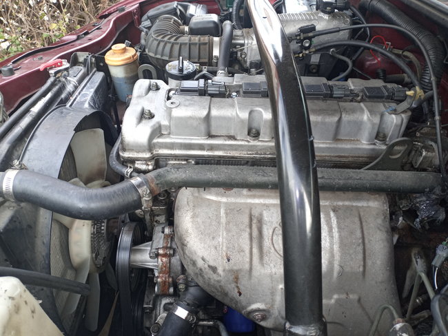

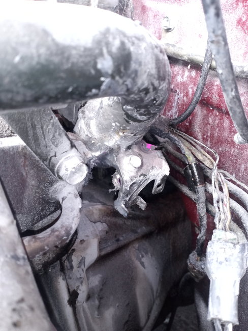

Thank you and in the morning I will try to take a picture of it. but on the Chevrolet Tracker the thermostat is on the lower hose on the radiator because I just changed the water pump and the thermostat not long ago. the upper hose is attached to a it looks like a hose but it's metal and it runs across the top of the engine and down into the back. but because of the welding I can't see exactly where it's going. tomorrow I will take a picture of it. I'm going to try to get some of that welding whatever it is off. I will post a picture of what I'm referring to. thank you very much for getting back to me. maybe with a picture you can tell me what I'm working with.
Mar 2, 2021 at 4:05 PM
SUSAN VALENCIA
  • 9 POSTS
Joe, this is a picture of what I was referring to. I haven't gotten any of that swelled off of it yet, but this is what it looks like right now and where I'm talking about. please get back to me if you know anything about this or what I can do to stop the leak there. Please

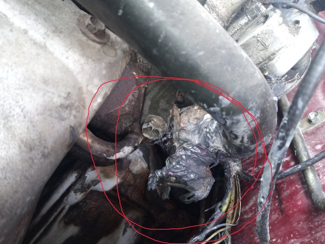

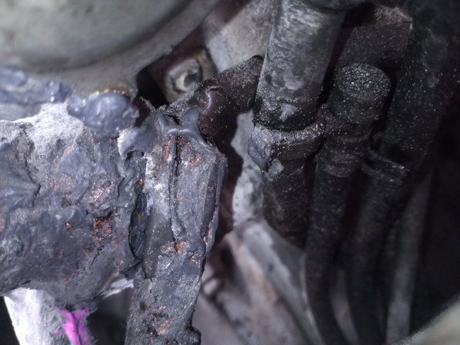

Use the pictures that I've taken one is has that weld on it the next one has where I tried to remove most of it.
Mar 3, 2021 at 8:25 AM
SUSAN VALENCIA
  • 9 POSTS
The next picture is here.
Mar 3, 2021 at 8:26 AM
  • 110,241 POSTS
It looks like something melted. If that is something like JB Weld, I can't imagine it is repairable. Try to remove some of that. It may be difficult.
I have to be honest with you. I have a feeling the best thing to do would be to replace the thermostat housing. That is your call at this point. If that is all a "cold weld" product, it had to be seriously damaged.
Try to get that off. As I said, it may be really difficult. If it is, remove the housing and replace it. However, make sure you can find one first. You may have to get one from a salvage yard. I don't know if this one is made aftermarket.

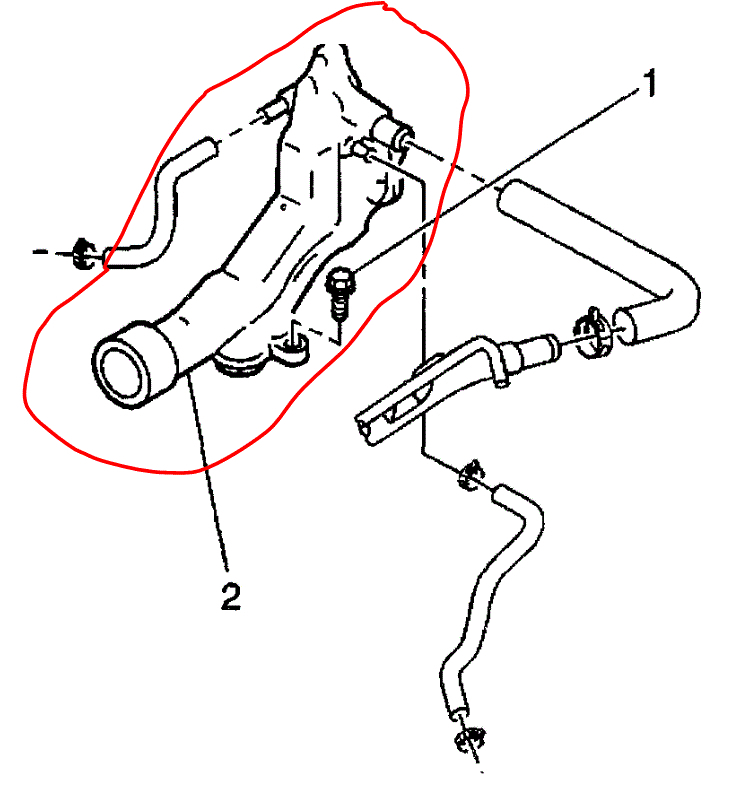

Here are the directions. The pics attached below correlate with the directions.
_______________________
2002 Chevy Truck Tracker 4WD V6-2.5L VIN 4
Thermostat Housing Replacement
Vehicle Engine, Cooling and Exhaust Cooling System Thermostat Housing Service and Repair Removal and Replacement Thermostat Housing Replacement
THERMOSTAT HOUSING REPLACEMENT
Thermostat Housing Replacement (2.5L Engine)
Removal Procedure
pic 1
1. Drain the engine coolant.
2. Remove the intake manifold.
3. Remove the radiator inlet hose.
4. Remove the radiator outlet hose.
5. Remove the heater hose (1) from the thermostat housing (2).

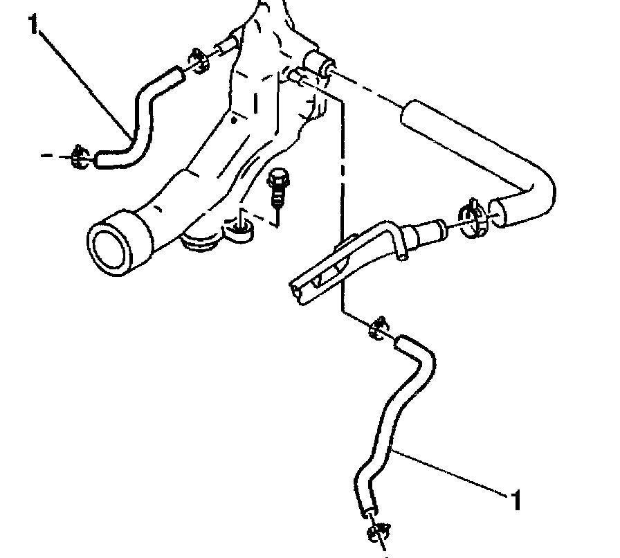

pic 2
6. Remove the bypass hoses (1).
pic 3
7. Remove the thermostat housing bolts (1) and the thermostat housing (2).

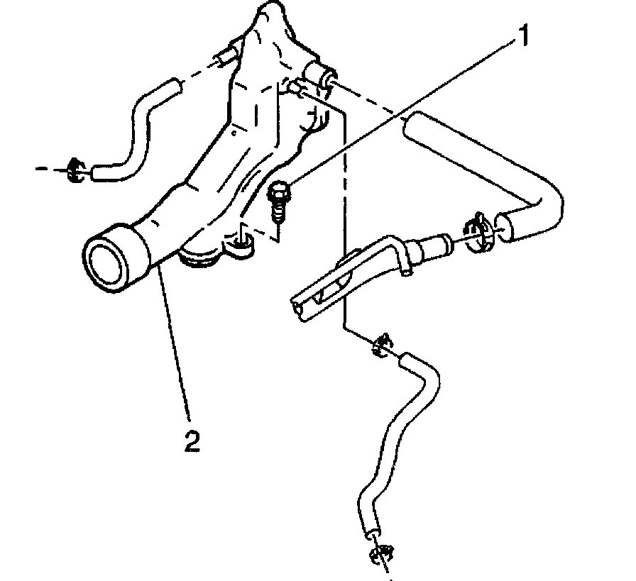

Installation Procedure
pic 4
Notice: Refer to Fastener Notice in Service Precautions.
1. Install the thermostat housing (2) and the thermostat housing bolts (1).
- Tighten the thermostat housing bolts to 45 Nm (33 ft. lbs.).
pic 5
2. Install the bypass hoses (1).
pic 6
3. Install the heater hose (1) to the thermostat housing (2).
4. Install the radiator outlet hose.
5. Install the radiator inlet hose.
6. Install the intake manifold.
7. Refill the engine coolant.
__________________________________

I posted my question last night also but this time I'm going to post a picture with this one. first picture will be with the welding that they put on there the second picture is going to be as much of the welding that I can get off it's leaking in that area. could somebody please help me tell me what I can do gasket whatever I'm in dire need of my car for work and I have no one else around here.I can't afford to take you to a shop so please can somebody give me some suggestions.

I think it's really messed up. this is a CarHop mechanic that did never again why buy a car from CarHop my own fault I guess. but I still think it's messed up.
Mar 4, 2021 at 2:43 AM (Merged)
Okay, it could be a hose or a loose clamp.
The best way to check is to pressure test the system and look for the leak. That will narrow it down. You can rent a tester at a parts store.
