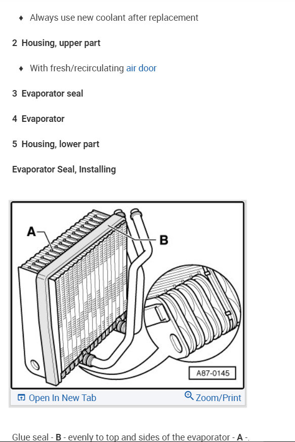

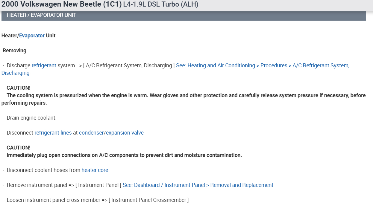

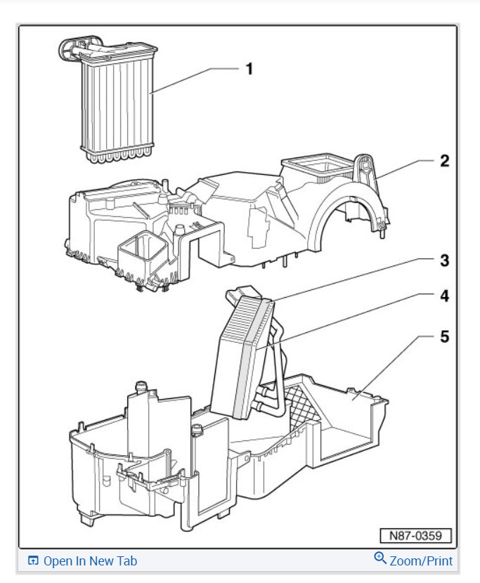

Yep this is a big job and the AC will need to be vacuumed down and recharged also here are the diagrams below to show you how the job is done on your car.
