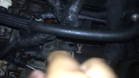

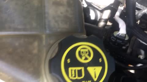

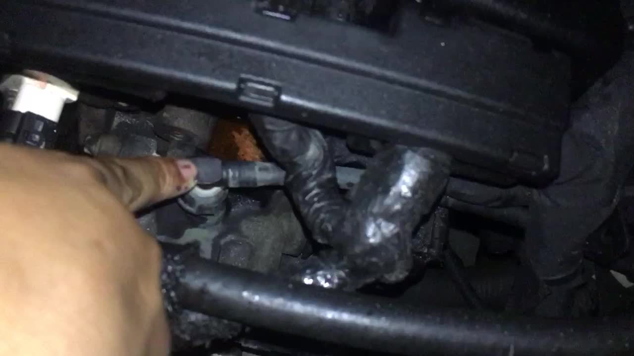

I found a leak this afternoon and then smoke or vapor started coming out from under my hood. It was leaking some orange liquid which made me think it was leaking coolant. Can someone tell me what hose this is?

The orange liquid is the newer style coolant. So it's a heater hose most likely, The video is kind of dark to identify the actual one but I think I can find a diagram of all of them and you should be able to identify it from that. Is that the drivers side of the motor in the front coming up from below along the radiator?.That diameter hose is very likely a heater hose. Can you tell where it leads to. If it leads to the fire wall and going into the cab of the car it definitely is a heater hose.

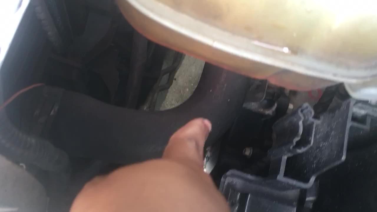

MICHELLE FELIZ
Is this a better video Tom?

Yes, I think I can see which one your talking about. Is it a hard plastic not the rubber one you can see on top but the one underneath? The upper one is a heater hose and will have coolant the lower one looks like its a emissions and it wouldn't have coolant. Your having a coolant problem though correct?

MICHELLE FELIZ
Hey Tom! You were right, it was the heater hose. I got it fixed today 20 minutes before work! Thanks for your help really appreciate it.
