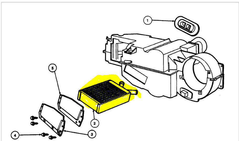

There is a coolant leak in the passenger side of the car. I replaced the radiator, thermostat, and water pump. It is still leaking in the same spot. Help!

If it is leaking coolant in the vehicle, the heater core is likely the cause. It is located under the dash on the passenger side.
First, look under the dash at the HVAC box. See pic 1. The heater core is located in the heater box. There are two hoses that will attach to it from under the hood at the firewall. Make sure they aren't leaking. If the bottom of the heater box is wet, the core is my first suspect.

Let me know if that is where it is coming from. If it is, I will provide the directions specific to your vehicle for replacement. However, it will require the removal of the instrument cluster, and the AC will need evacuated and then recharged when you are finished.
See pic below.

The leak is on the outside.

Have you checked the heater hoses where they connect to the core? If you open the hood, they will be behind the engine at the firewall.
If there is no visible leak, you may need to pressure test it. It's not hard to do but does require a pressure tester. However, most parts stores will lend one to you. Here is a link that explains how it's done:
