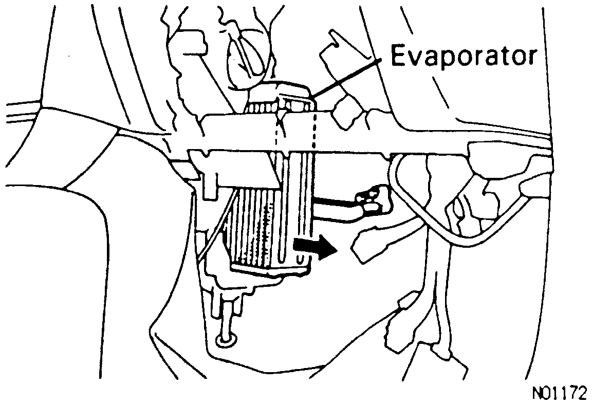

I just recently replaced the expansion valve and o-rings. Pulled a vacuum and let it sit for a few minutes and the vacuum did not hold. I did notice that the expansion tubes are loose and will not tighten against the expansion valve. Am I doing something wrong? Do I need to replace the tubes? Should I have unbolted the tubes from the two nuts inside the firewall or the two bolts outside the firewall. I could not see an easy way to take off the outside bolts behind the engine as they are blocked.

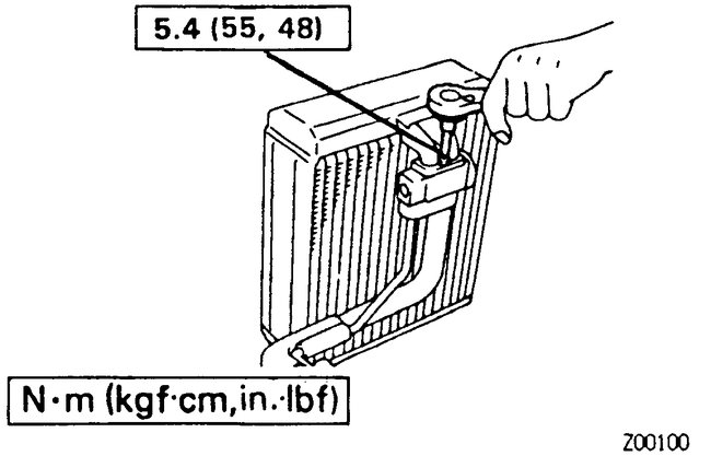

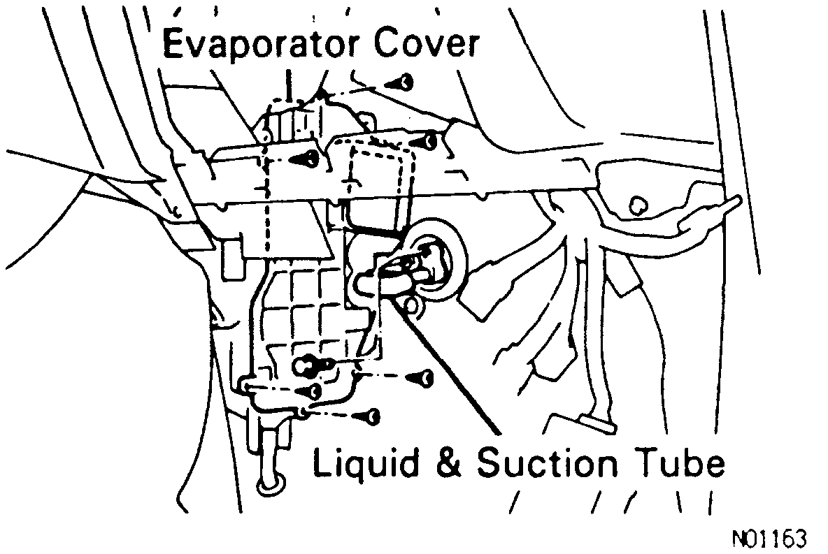

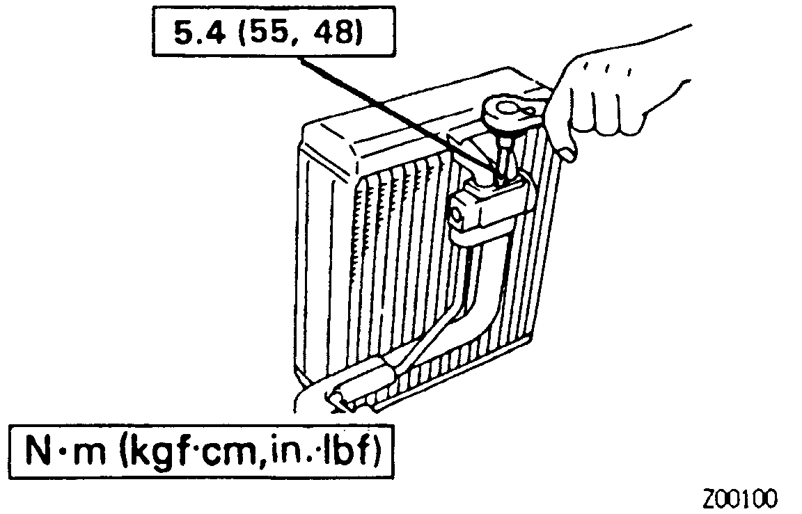

What I have are the directions for removal and replacement of the expansion valve right from alldata. Take a look through the specifics to see if you did it correctly. The attached pictures correlate with these directions.
REMOVAL AND INSTALLATION

4. Disconnect and cap evaporator liquid and suction tubes.
Removing Evaporator Case Cover
Removing Evaporator Core
Removing Expansion Valve
5. Remove evaporator cover.
6. Remove evaporator assembly, then separate evaporator and expansion tube.
7. Reverse procedure to install.
8. When new evaporator is installed, add 1.6 oz. refrigeration oil.
TORQUE VALUES
Expansion Valve To Evaporator: 4.8 lb.ft. (5.4 Nm)
Refrigerant Tubes: 7 lb.ft. (9.8 Nm)
