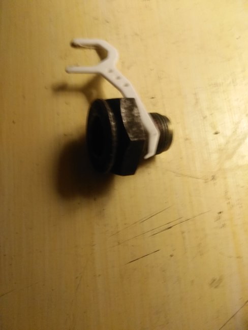

I just put a new radiator in my 1998 ford and it's leaking out from the bottom transmission line from the radiator water how seal it it came witth2 washers do i need to use the

Were the threads damaged on the line to the radiator?
Can you post a picture of what you see so I can see it?
The most common issue is the seal in the line, not the radiator.

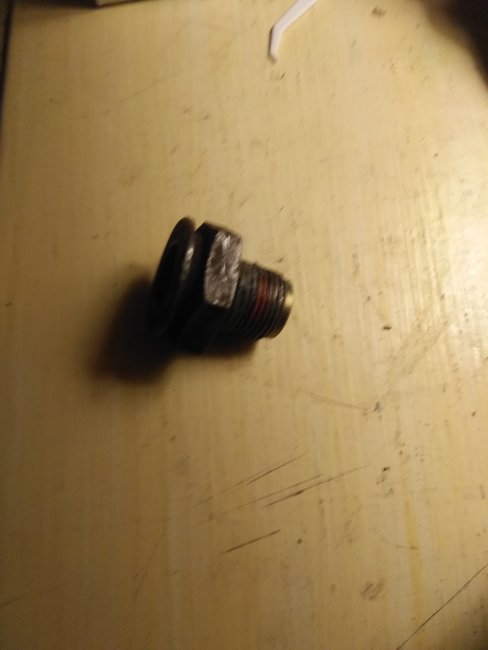

No its a brand new radiator the connection had a smmall rubber seal how much teflon tape around the connection this is the old 1where you see the white pic thats where the water leaking from

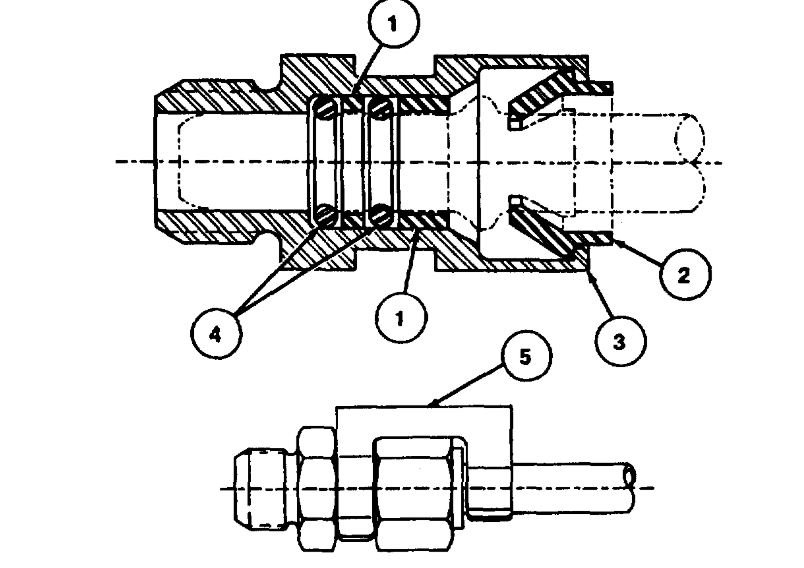

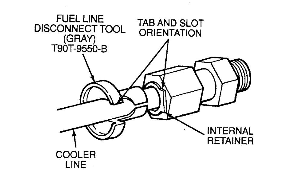

Hello again,
The fitting will have to be replaced. The ends are available from a parts store for this repair.
The internal seal is bad and it is better to replace the end to be sure your leak is resolved.
