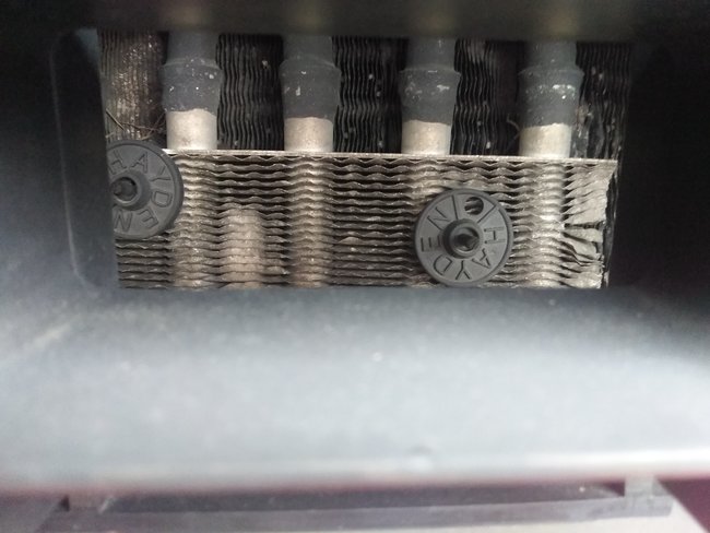

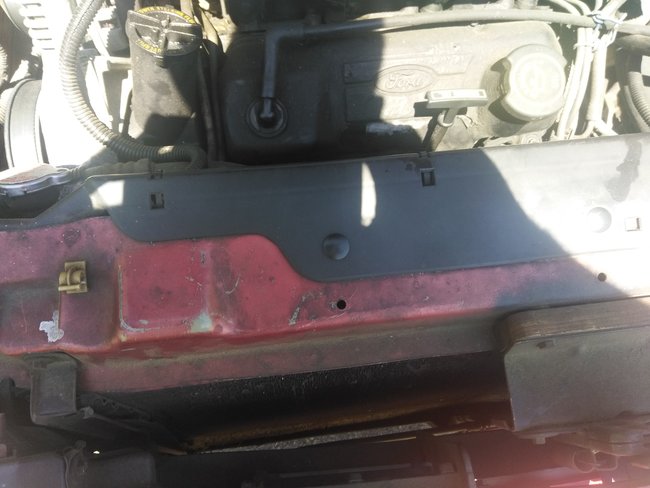

Losing fluid from the right side of the radiator when i push on the top hose. i think the radiator is plastic side and can't find any books to do it myself.

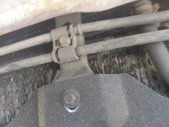

I want to replace the radiator. i just need how to take it out from the bottom or top.

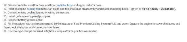

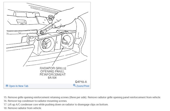

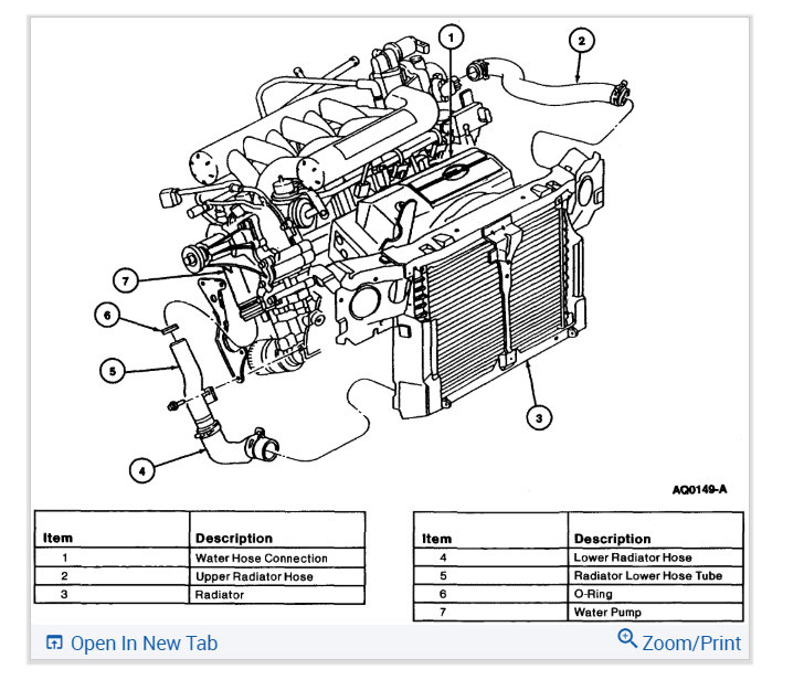

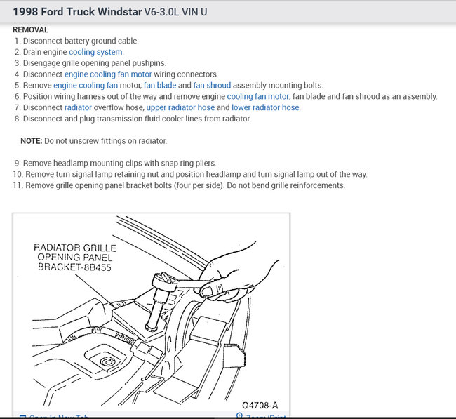

  • 55,399 POSTS

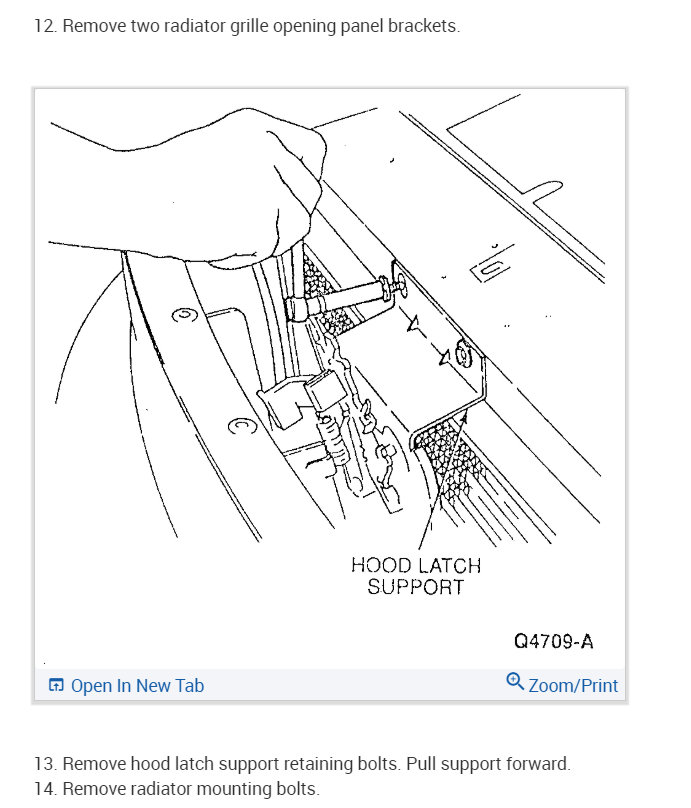

Here is a guide to help walk you through the steps with instructions and diagrams below to show you how on your car:
https://www.2carpros.com/articles/how-to-replace-a-car-radiator

  • 28 POSTS

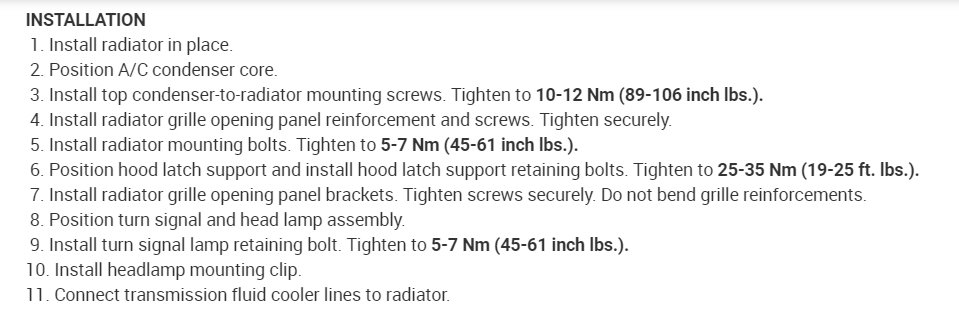

Thanks for getting back to me, but your diagram is not working. i got 3.8l engine 1998. oh my has no bracket in front of the van. i need a different way if you can.
Apr 22, 2019 at 7:23 AM
  • 55,399 POSTS
Its the same for the 3.8. Can you please shoot a quick video with your phone so we can see what's going on, that would be great. You can upload it here with your response.

Yes, it does have the center bracket either way i still need away to take it out from the top or bottom. Ken is there anyway you can show me or another diagram?

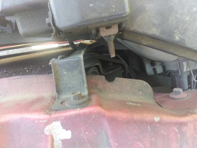

It should come out from the top, if you shoot a quick picture of what the problem is I can walk you through it.
Apr 23, 2019 at 3:53 AM

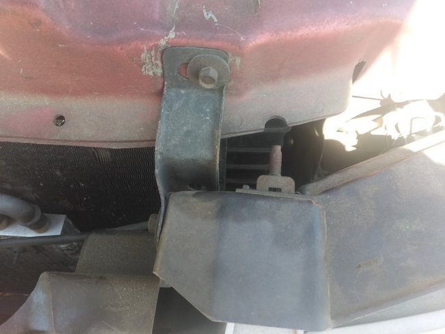

KUCHLER 123
  • 28 POSTS
Hope this helps.

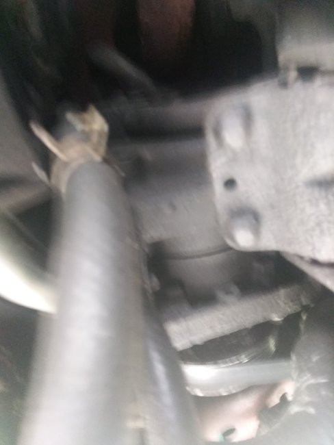

Apr 23, 2019 at 4:17 AM
KUCHLER 123
  • 28 POSTS

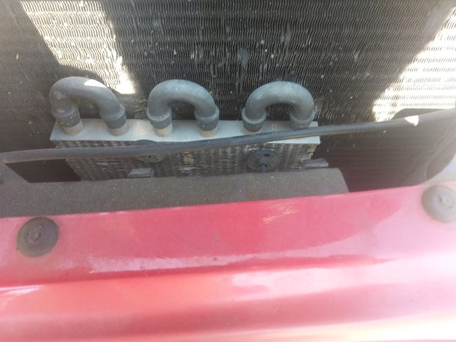

Hope this helps. What's the difference between the two? Miz 1609 or rea 1609 a
Apr 23, 2019 at 4:21 AM
  • 55,399 POSTS

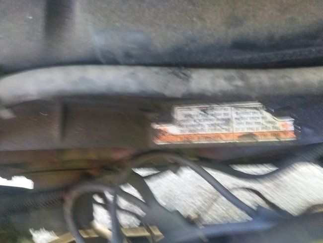

I see an aftermarket transmission cooler which will need to be removed, try to remove the top plastic piece to gain access. also you may need to loosen the engine mounts to rock the engine backwards in the engine bay to get room to pull the radiator. Can you take pictures of the bottom where the radiator would come out if it could? I don't think it comes out from the bottom but I want to be sure.

  • 55,399 POSTS
I got it. but hard to tell what is going on. I am going to say it comes out from the top. roll the engine back while loosening the engine mounts. Let me know.

You said i got an after market condenser. i see four plastic screws. how do i release them and put back on?
Apr 25, 2019 at 3:50 AM
  • 55,399 POSTS
After market transmission cooler, you will need to cut the plastic ties and then get new ones.

They look like i can unscrew it off.
Apr 25, 2019 at 3:57 AM
KUCHLER 123
  • 28 POSTS
Do you see the plastic screw? what is the name of them?
Apr 25, 2019 at 11:00 PM
  • 55,399 POSTS
Those are cooler ties, they need to be cut you will need to buy new ones when reassembling.
