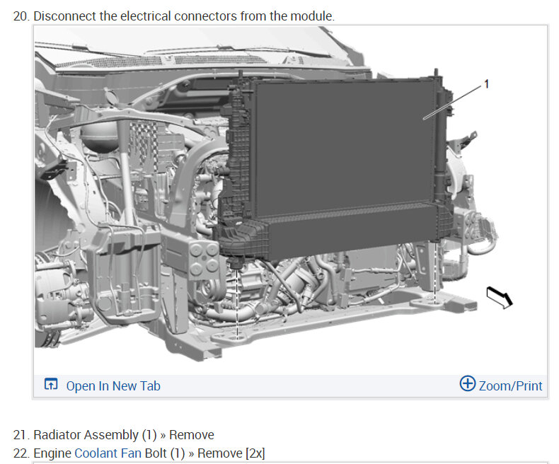

I was in an accident with front end damage. Immediately after the accident I noticed a leak under the front of my car. Whatever was leaking was coming from the front passenger corner of the car. It was clear and odorless. A tow truck driver said I busted the radiator, but it was off to the side and certainly did not look like coolant. My car is still drivable somewhat (reduced engine power).

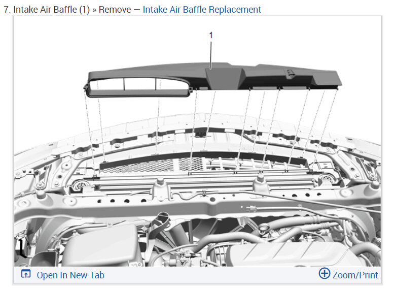

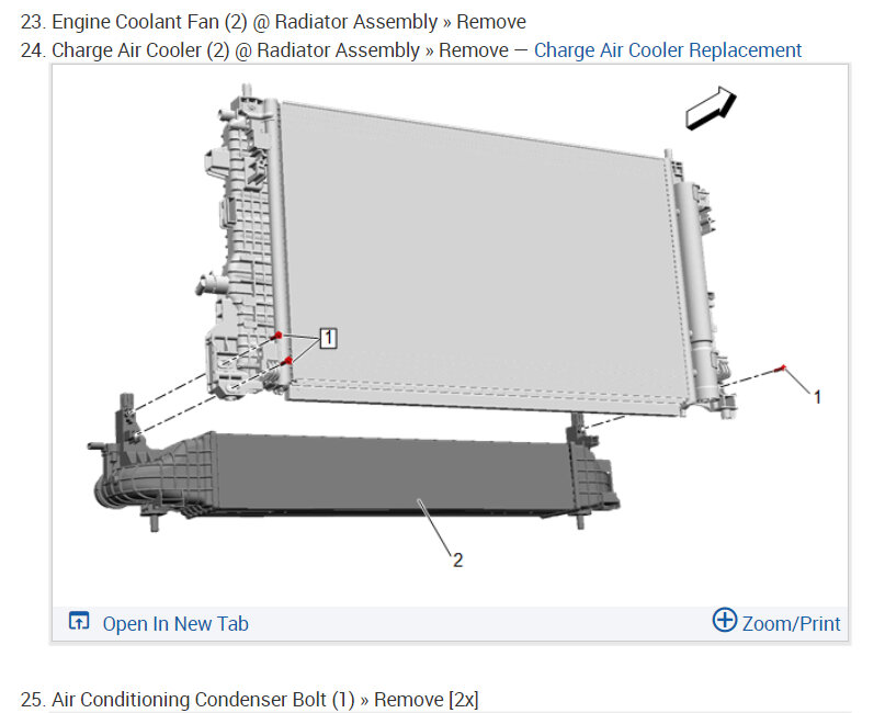

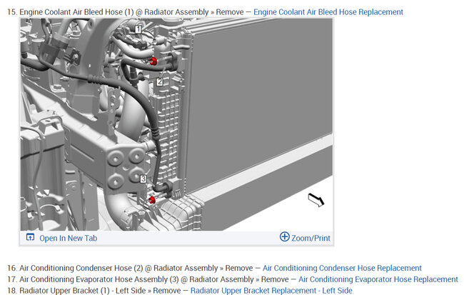

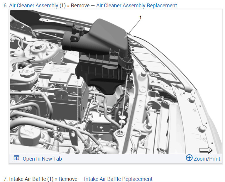

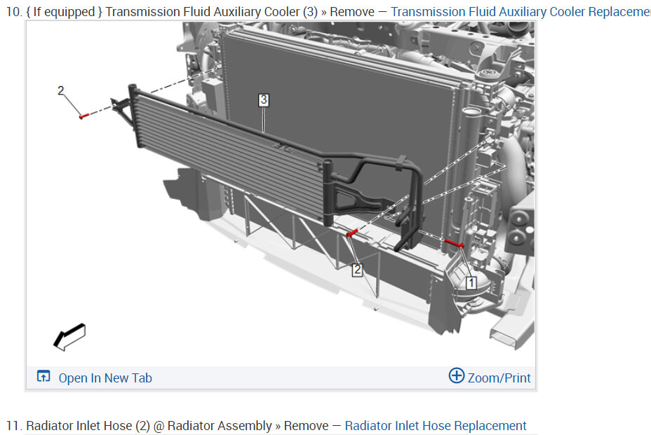

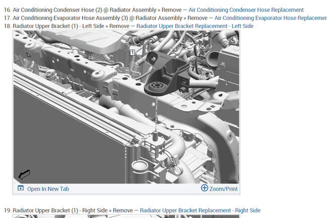

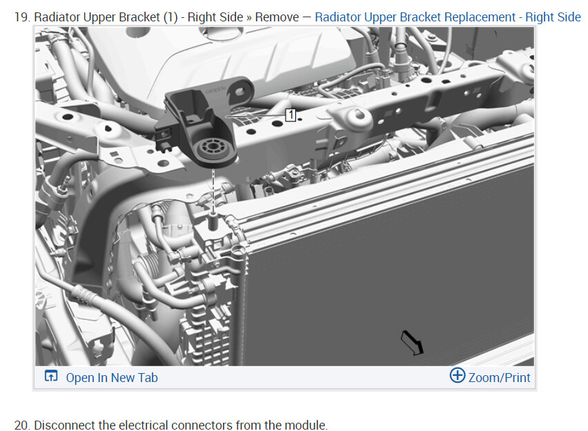

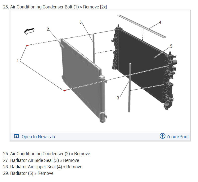

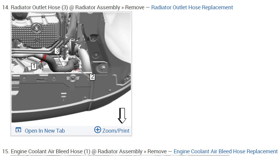

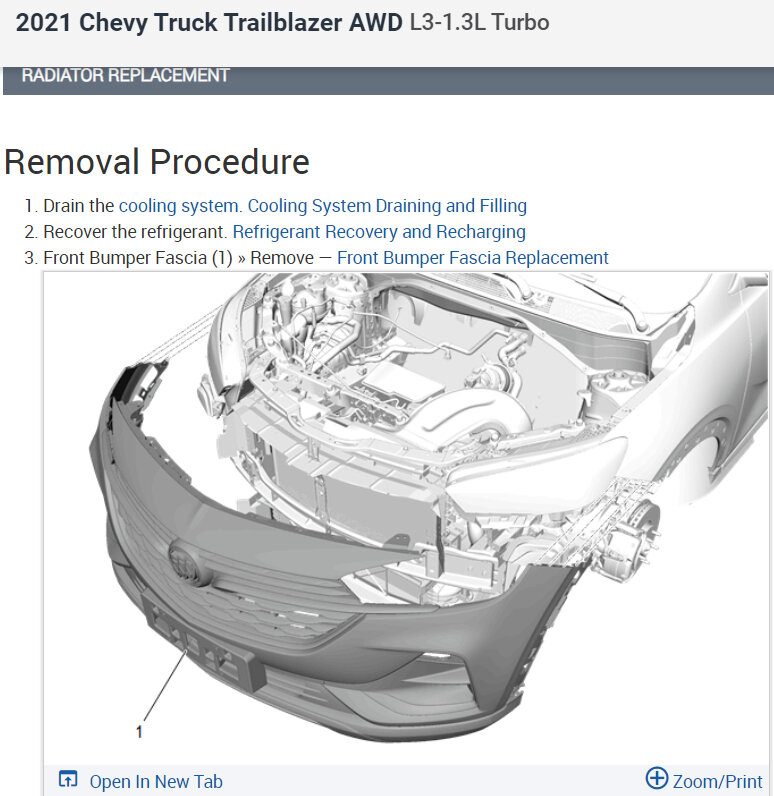

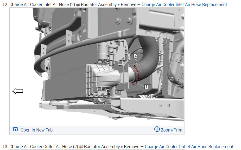

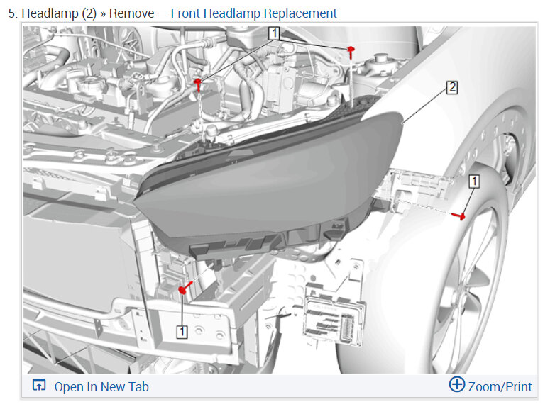

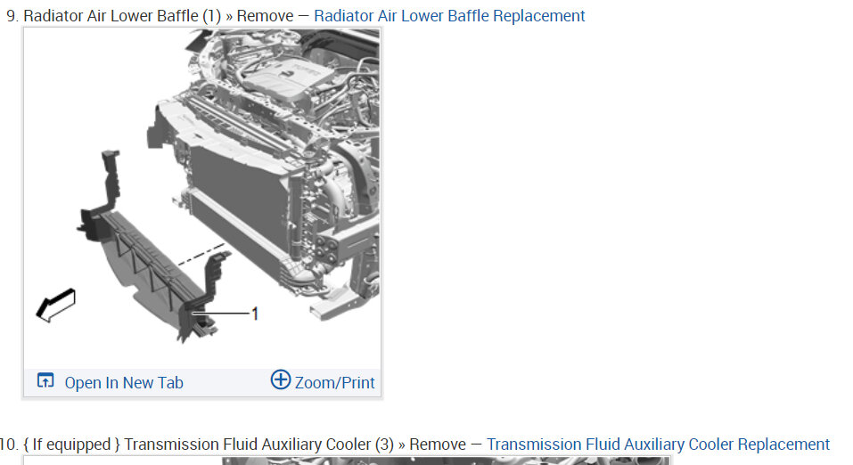

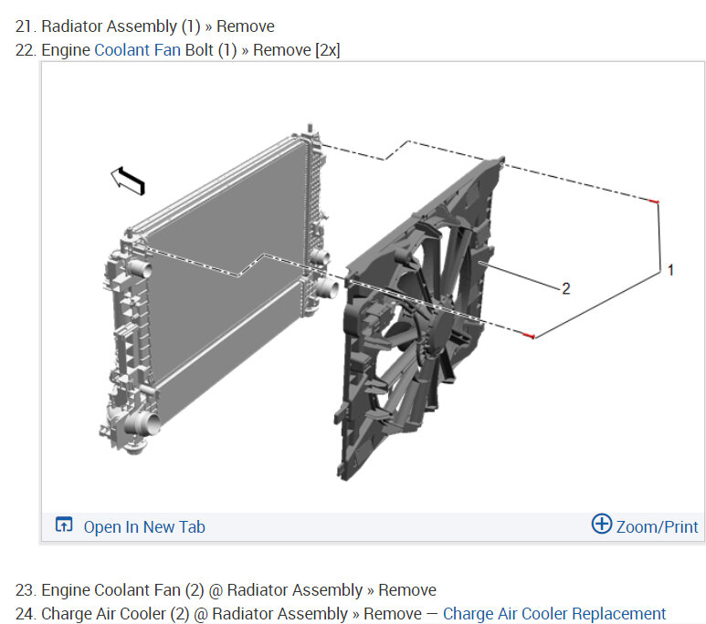

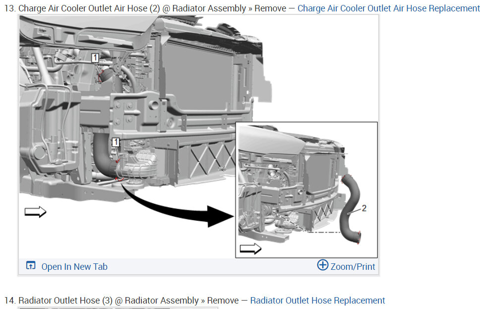

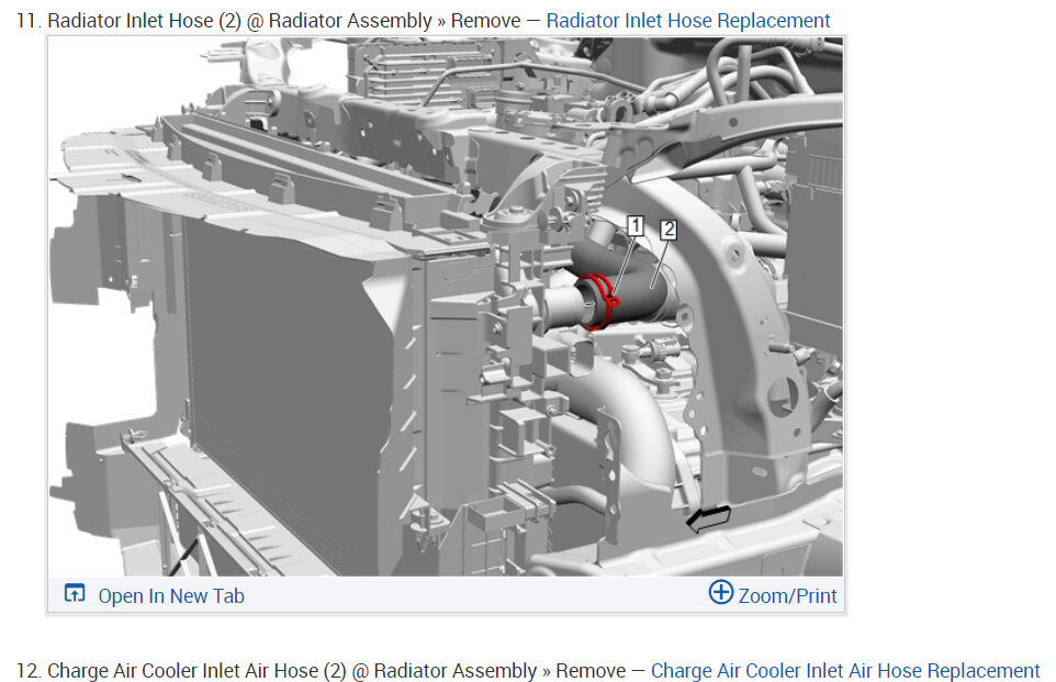

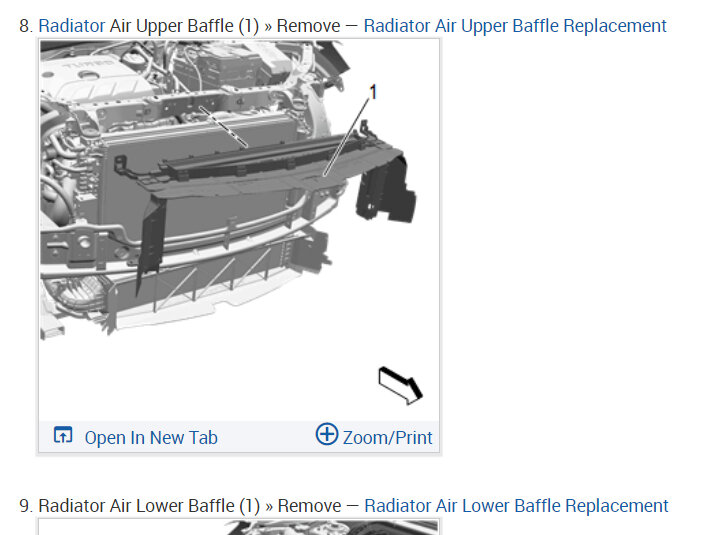

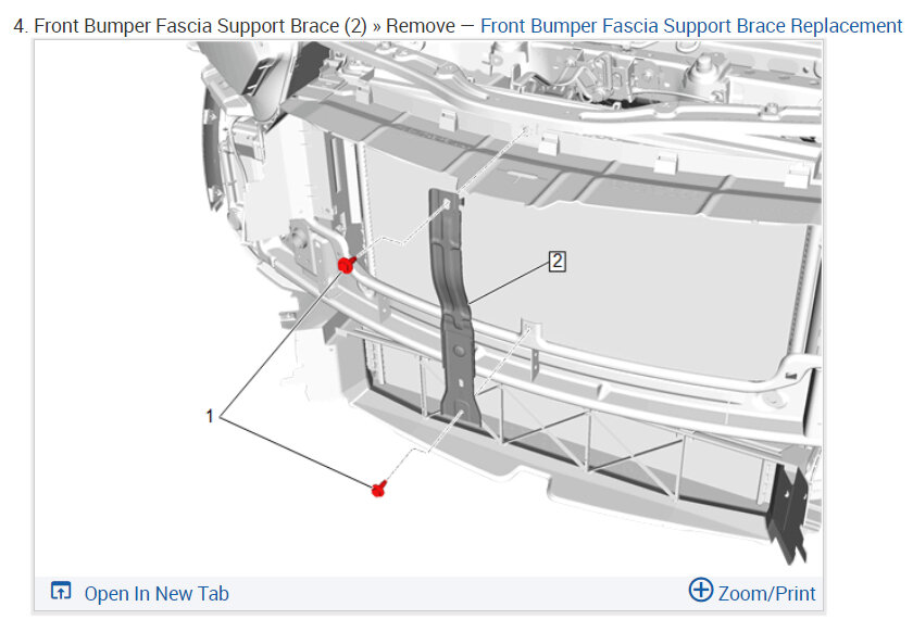

It probably is coolant from the radiator which is orange or pink-colored and can be clear when on the ground. Here is a guide to help with the leak and I have included how to change out the radiator in the images below in case you want to fix it.
https://www.2carpros.com/articles/car-is-leaking-coolant
Wow, replacing the radiator in this car is no joke, they get 5 hours in the book and you need to vacuum down and recharge the A/C system. This video will help:
https://www.youtube.com/watch?v=4EqdrBVb0sY&t=55s
Check out the images (below). Please upload pictures or videos in your response of any problems so we can see what to help you with.
