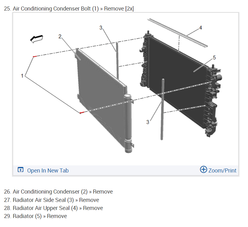

I was in an accident with front end damage. Immediately after the accident I noticed a leak under the front of my car. Whatever was leaking was coming from the front passenger corner of the car. It was clear and odorless. A tow truck driver said I busted the radiator, but it was off to the side and certainly did not look like coolant. My car is still drivable somewhat (reduced engine power).
Oct 17, 2024 at 8:27 PM
  • 55,421 POSTS

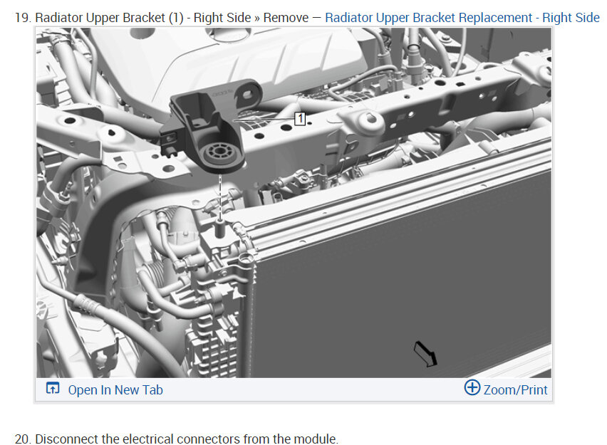

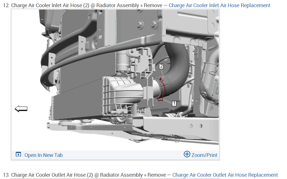

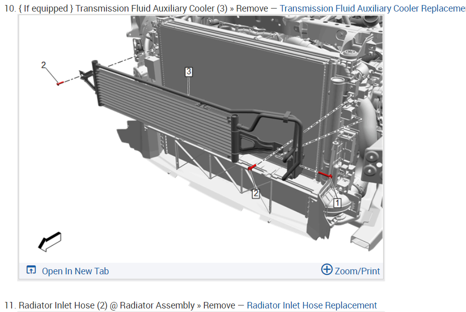

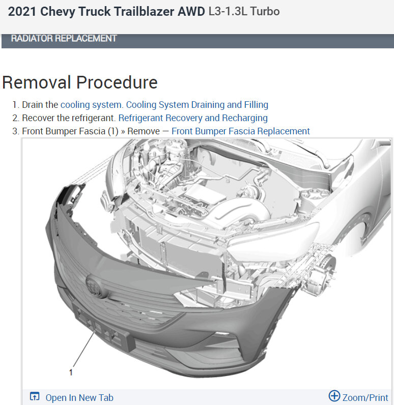

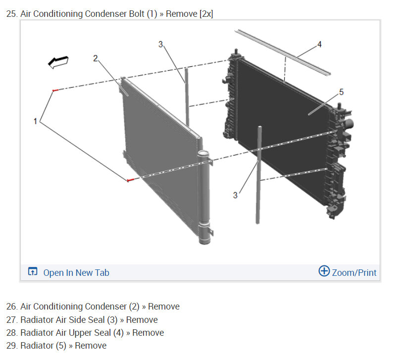

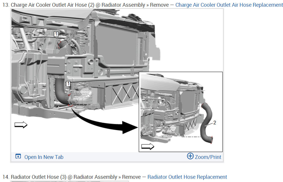

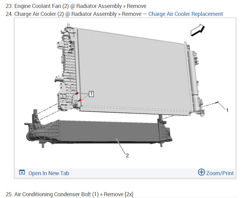

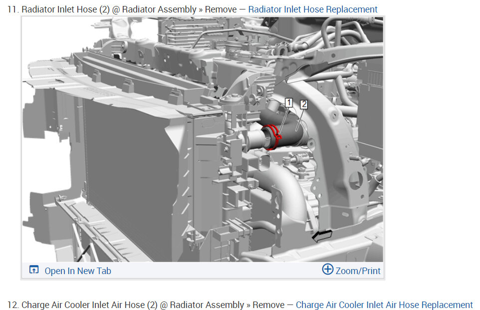

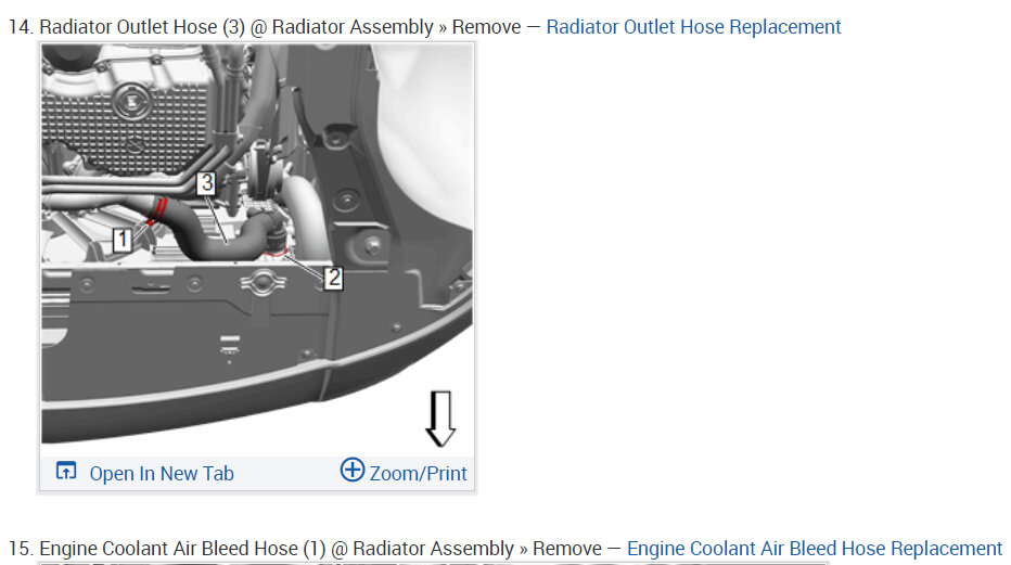

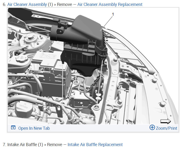

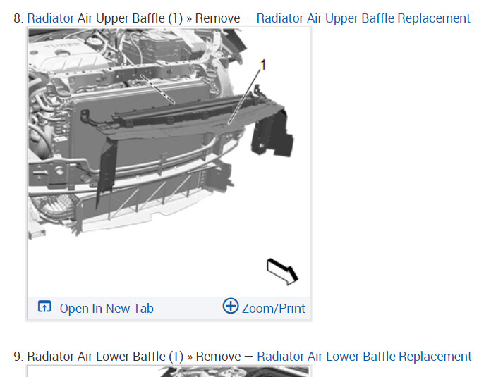

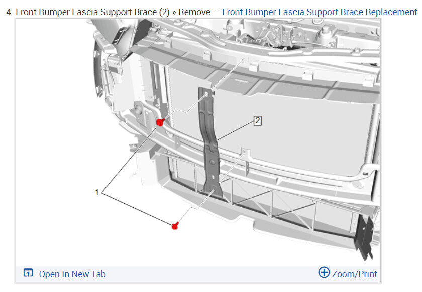

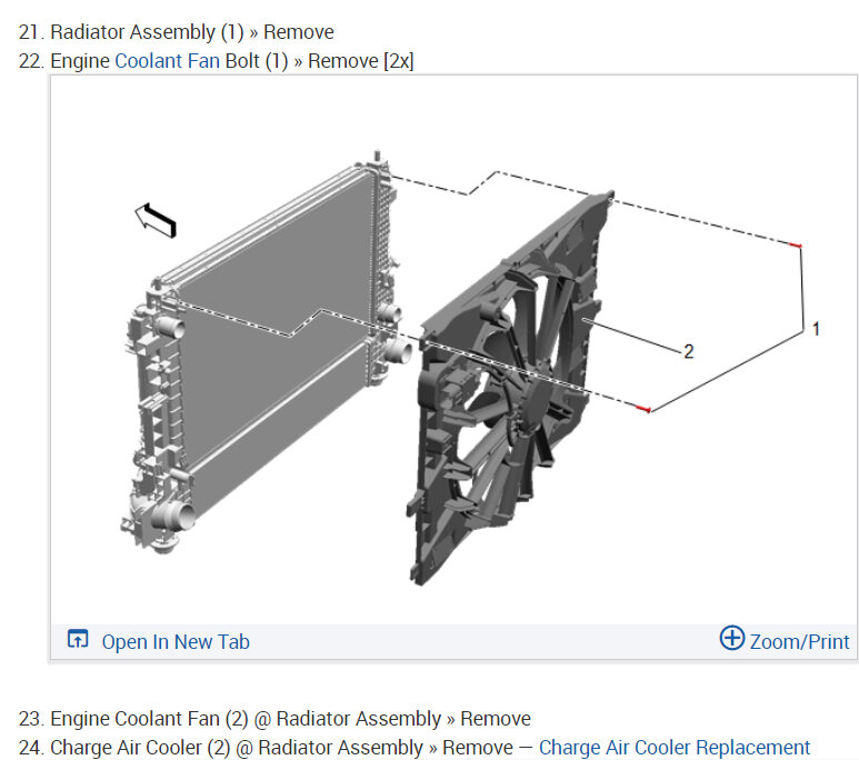

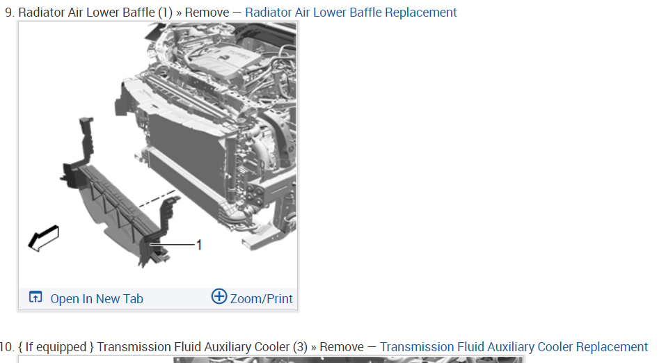

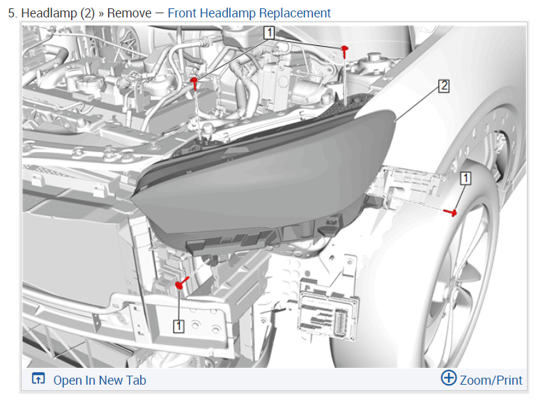

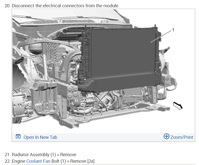

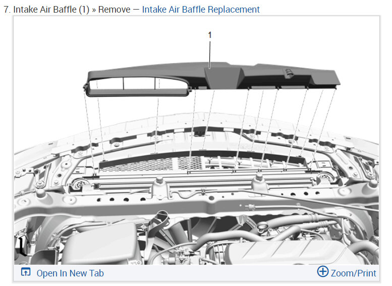

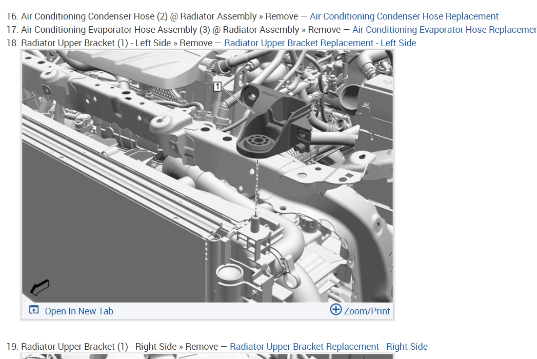

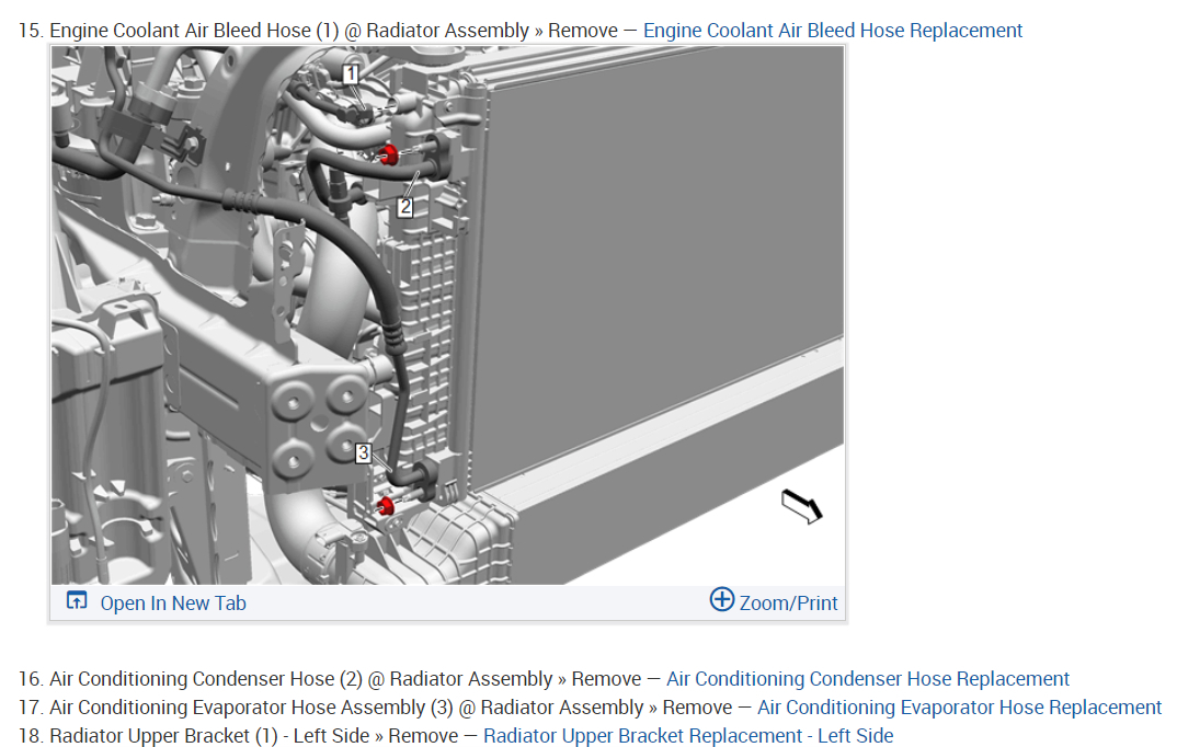

It probably is coolant from the radiator which is orange or pink-colored and can be clear when on the ground. Here is a guide to help with the leak and I have included how to change out the radiator in the images below in case you want to fix it.
https://www.2carpros.com/articles/car-is-leaking-coolant
Wow, replacing the radiator in this car is no joke, they get 5 hours in the book and you need to vacuum down and recharge the A/C system. This video will help:
https://www.youtube.com/watch?v=4EqdrBVb0sY&t=55s
Check out the images (below). Please upload pictures or videos in your response of any problems so we can see what to help you with.
