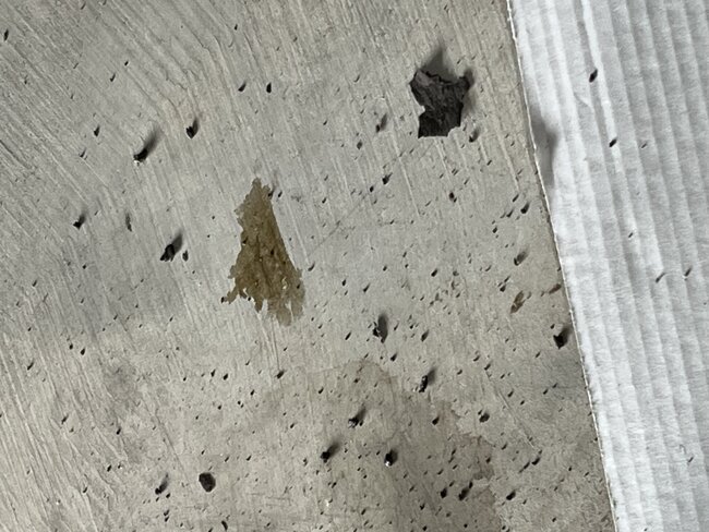

Hi Joe,
Here is a picture of the leak near the middle of the front of the car underneath.
Aug 28, 2023 at 4:11 AM
  • 110,240 POSTS

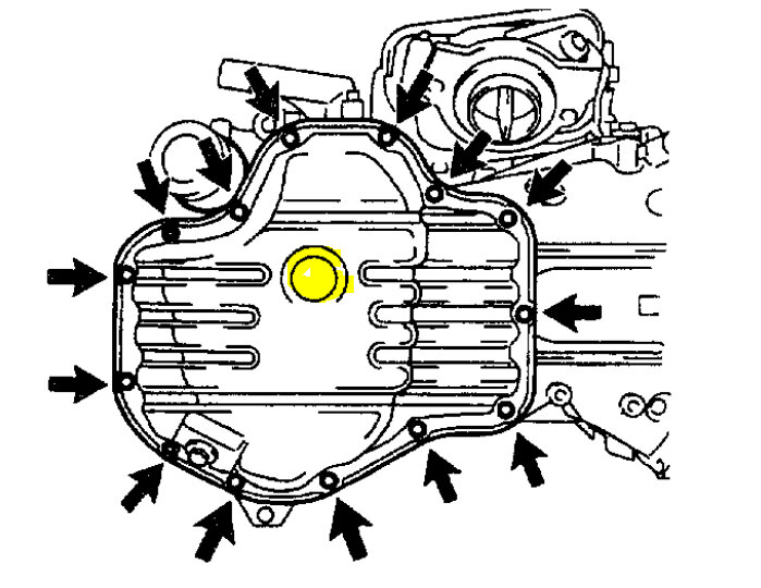

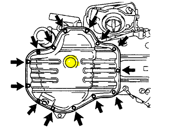

That does look like engine oil. Since it is in the center of the front, I would first check the oil drain plug on the oil pan under the vehicle. See pic 1 below.
When you check the plug, keep in mind it may be tight, but there is a gasket that may have failed, so to make that determination, if the plug is wet, confirm nothing above it is wet. If everything above the plug is dry, chances are that is the problem.

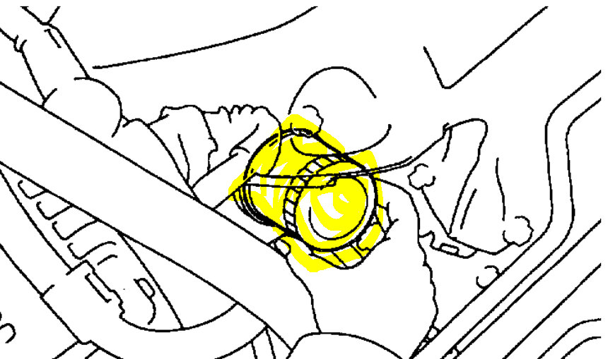

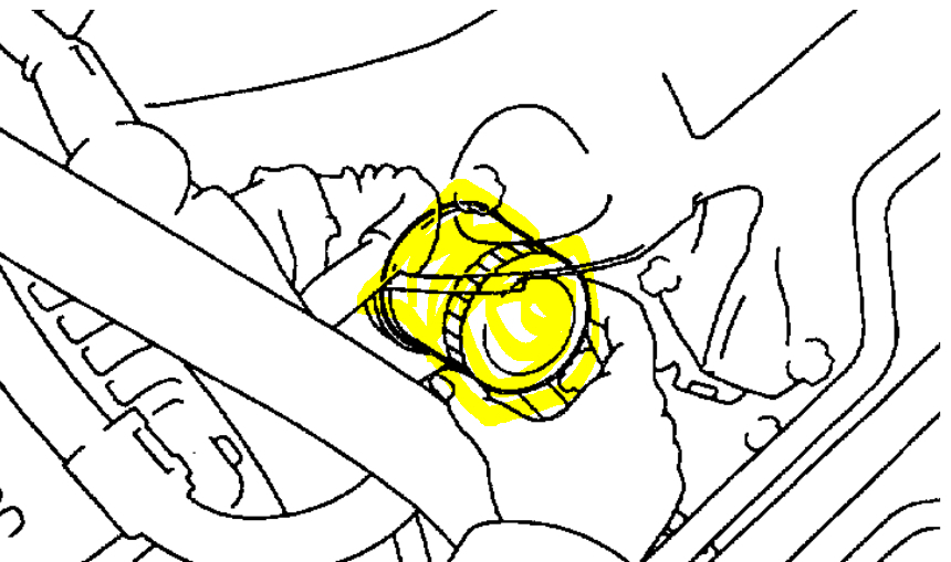

On the other hand, if there is evidence of oil coming from above, next check the engine oil filter located on the side of the engine (driver's side). Check for evidence of a leak from it as well. See pic 2 below
There may be a cover under the engine. If there is, before removing it, see if there are any wet spots on it.
