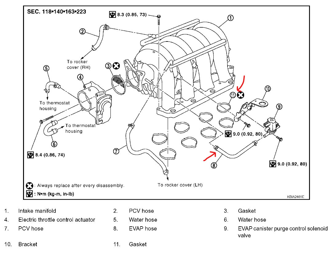

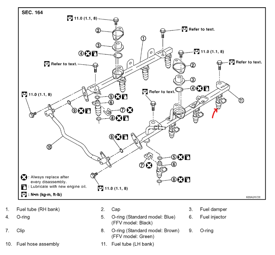

I recently discovered a leak beneath the air intake on my vehicle listed above. Therefore, I'm trying to figure out what it can be.
Aug 22, 2024 at 6:37 PM
  • 55,616 POSTS
It could be the intake gaskets, a vacuum line or the fuel injector O rings have let go, you may be able to figure it out better by going over this guide:
I have included the typical leak areas in the images below. Please upload pictures or videos in your response of any problems so we can see what to help you with.
