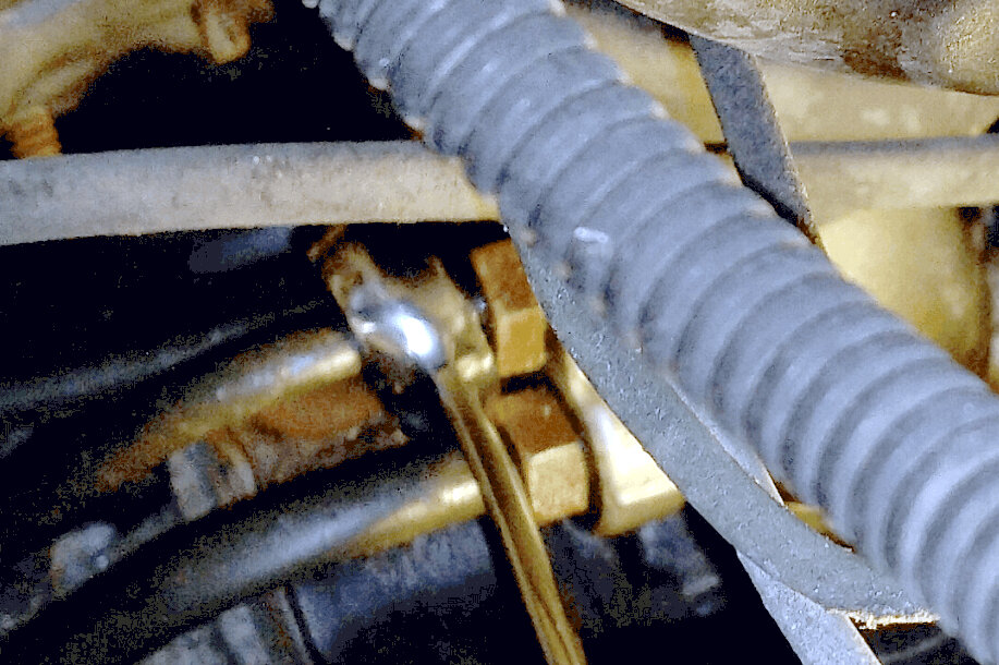

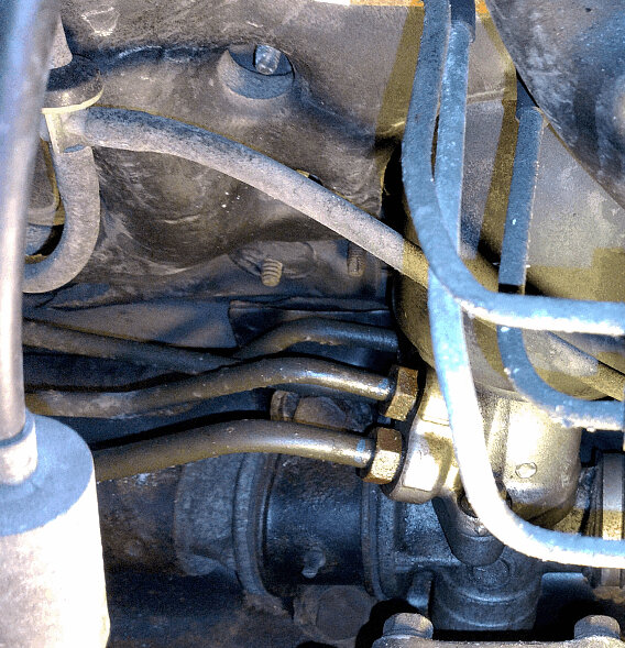

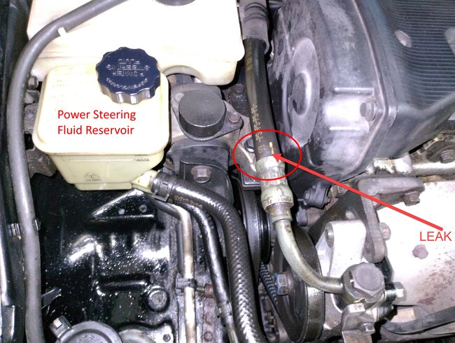

Found the aggressive Power Steering fluid leak. It's on the high-pressure line. A photo is attached that shows the joint where it is leaking from.
How can I fix this? Is there a way to temporarily stop the leak with epoxy or something like that until I get the part and actually replace the line/hose?
Now, the belts are chirping because they are soaked in Power Steering fluid. Is there a good video on how to clean the belts easily without taking everything apart? Thanks.
Aug 18, 2023 at 12:02 AM
  • 110,194 POSTS
Yep, I see the problem as well. As far as a repair, there really isn't one. The pressure is too high to use a sealant. In general, the pressure in the high-pressure power steering hose can range from around 1,000 to 1,500 psi. The hose needs to be replaced.
As far as the belt is concerned, I don't have a video. However, I would recommend removing the belt and first using a degreaser to clean all the pulleys. You could use an engine degreaser or even something like brake cleaner. Just avoid spraying it into any of the belt-driven accessories. Also, you could use something like a toothbrush to get into the pulley grooves.
Once that is done, wipe the belt itself with a cloth to remove excessive fluid. Then, take a mild detergent and water and try to get the fluid off. If the belt is older, it may be a good time to replace it.

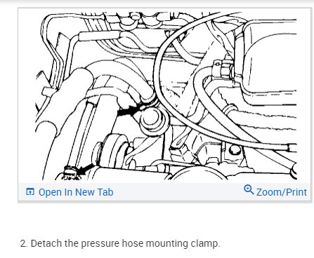

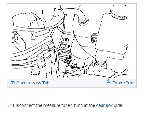

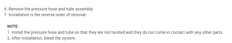

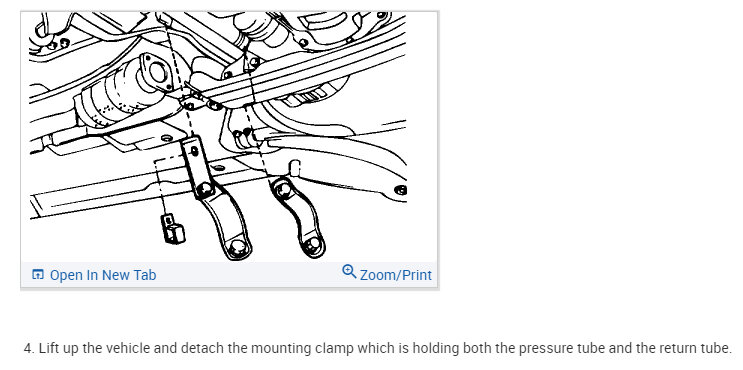

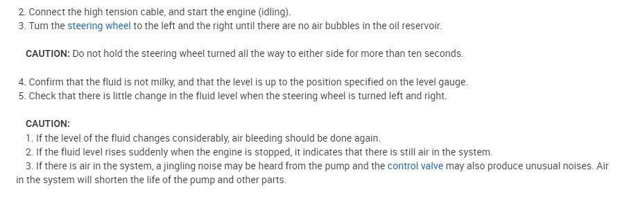

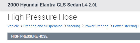

I don't know if you need them, but I attached the directions specific to this vehicle for replacing the p/s high-pressure hose.

Thanks for the info. Since the leak is coming from the hose restriction point where the metal is crimped (red-circled @ photo), I am thinking about using superglue first and then top it off with silicone RTV until I get a chance to buy and replace the part.

If you have a line wrench, that is what I would suggest. There will be less chance of it stripping. As far as the hose, if it was me, I would replace the entire thing simply because if the first one failed, the second is likely not far behind.
However, are you sure yours is a two-piece? I don't recall a union.
Aug 19, 2023 at 8:21 PM
YOURMINKY
  • 106 POSTS
I just checked, and it is a 2-piece line. The 2nd piece that runs from the mounting clamp to the gear box is all metal and looked like a brake line and is in good shape. According to the directions you posted, it seems like changing half of the line would be easier. Let me know what you think. Thanks.

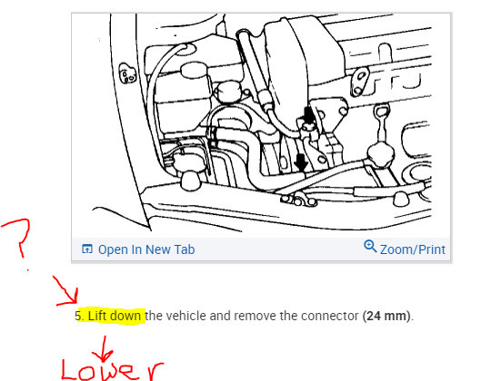

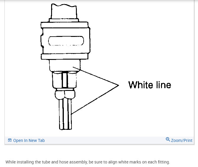

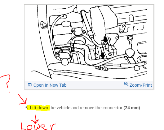

I stopped driving the Hyundai because of the leak. Now, because of the holidays, I have to fix it.
One of the how-to screenshots you uploaded states, "White line". What is that white line for?
I tried to unscrew the 14mm fitting with a line wrench, located half-way, where the upper rubber tube attaches to the lower metal tube. That way I'd have to only replace the upper part of the hose which is easy to reach and work with. But it started to round off, so I stopped.
I bought some 17mm line wrenches and tried to unscrew the 17mm tube fitting at the gear box from underneath. Again, I could not rotate it. I am afraid if I use a lever, I might round it off. I saw a YouTube video where the mechanic used a pipe cutter and cut the tube at the gear box and used a regular 17mm socket to unscrew the fitting. The regular household plumbing copper pipe cutter I have is too big and may not fit because there are other tubes right next to the PS tube. Do you have any suggestions? Should I use a lever or buy a tiny pipe cutter? BTW, I lubricated the joints with penetrating oil mixed with transmission fluid overnight.
I am also a little nervous, if I cut off the tube at the gear box and fail to unscrew the fitting, the car won't be drivable. What are the consequences?
Nov 22, 2023 at 7:48 PM
  • 110,194 POSTS
As far as the white lines, there will be one on the fitting and one on the steel line that should be aligned.
As far as cutting the pipe is concerned, if you are replacing it, that would be okay to do. Then you should be able to get a good 6-point socket on the nut to loosen it.
However, before going to that extent, I would try to loosen it first. If it starts to strip, then we can cut things. Also, I have used a product called freeze-off. It is designed to cause the temp to drop when it is sprayed on a bolt. When that happens, the steel contracts and if there is corrosion or rust stopping it from moving, it will loosen it. If you want to try it, I attached a pic below of what I'm referring to. Follow the directions indicated. I can't guarantee it, but it has helped me many times in the past.
See pic below.

The replacement part I bought does not have any white lines. The upper and lower hoses were already very tightly screwed together when they arrived.

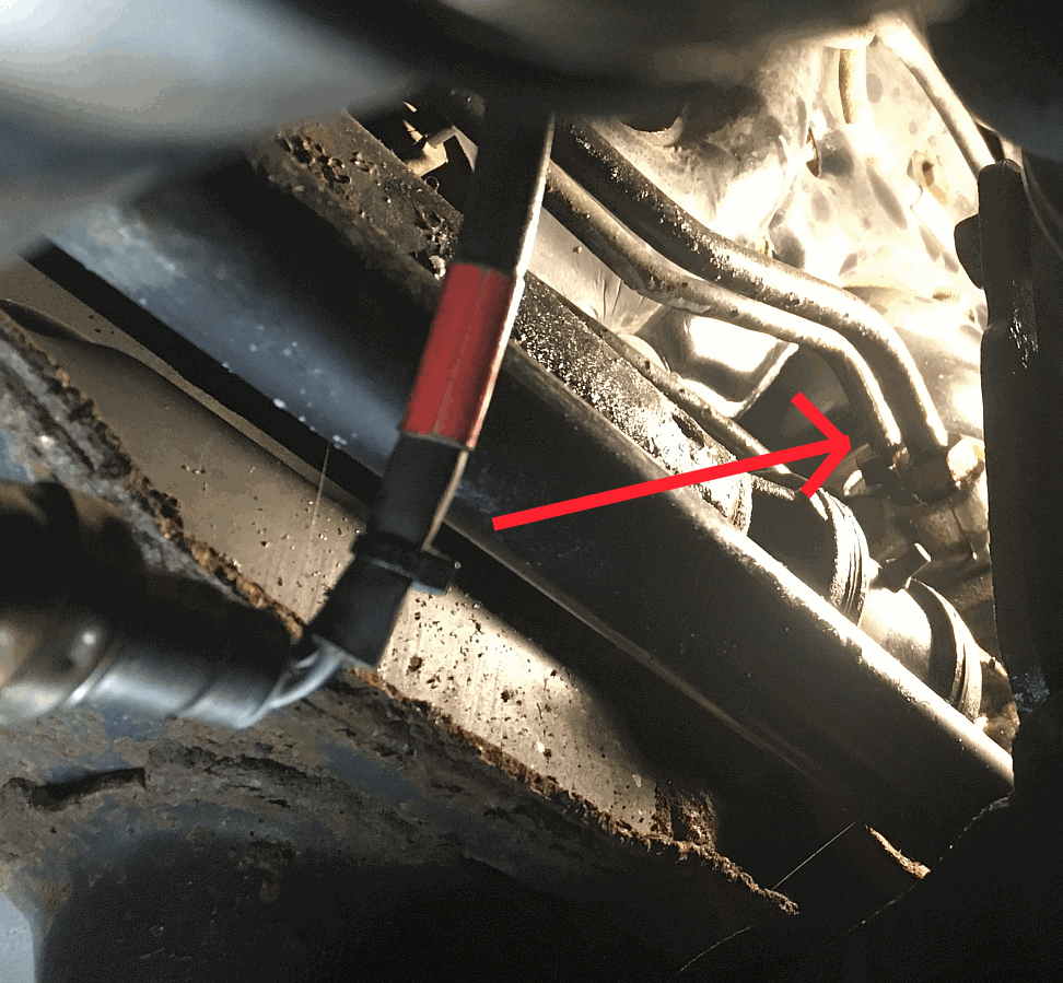

I used car ramps and tried to reach the gearbox from the bottom. There are two fittings so close that my line wrench won't fit in the small gap between the two at the gearbox junction. I am attaching photos. It was also impossible to see through the other parts what I was doing from the bottom, so I had to do everything by touch. I will try to reach from the top tomorrow, which requires removing the air intake hose assembly.

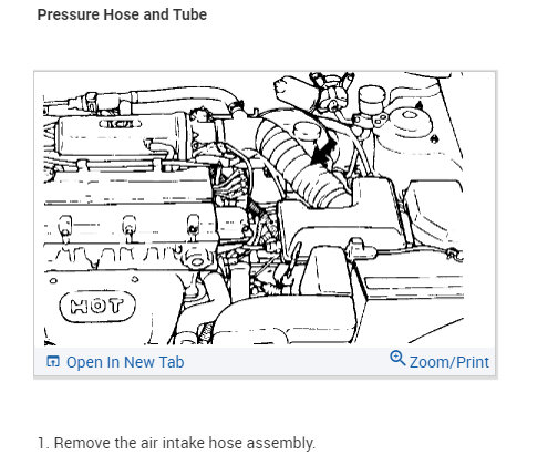

Can you please point me to a good video that shows how to remove the air intake hose assembly properly? I searched YouTube, did not find any for my model.
What should I do if I cannot fit the line wrench between the 2 fittings from the top?
I did not buy the Freeze-Off product. I saw on YouTube videos that people use handheld propane torch to heat the junctions. I already have a small propane torch. Can heating the gearbox help?

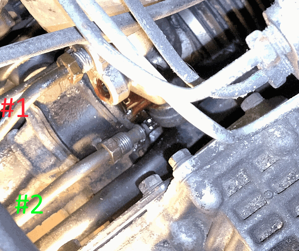

I removed the air intake hose assembly, it was easy. Now I can reach the gearbox junction from the top, but the line wrench does not have any room to fit. Photos attached. Is there a trick?
Nov 30, 2023 at 1:47 PM
YOURMINKY
  • 106 POSTS

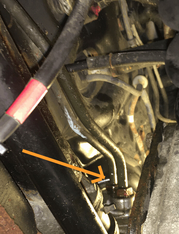

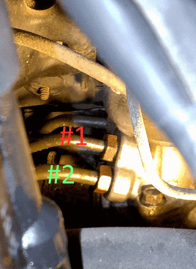

Please see the photo. I was able to loosen the #2 fastener at the gearbox. Should I unscrew #2 all the way and then use the line wrench to loosen #1 (the PS line) so it will fit? Any risk in doing so? What is #2 for and what kind of fluid will come out of it? Thanks in advance.
Nov 30, 2023 at 3:18 PM
  • 110,194 POSTS
You should be fine removing the other line. That should be the return line. Power steering fluid will come out of it.
Nov 30, 2023 at 6:53 PM

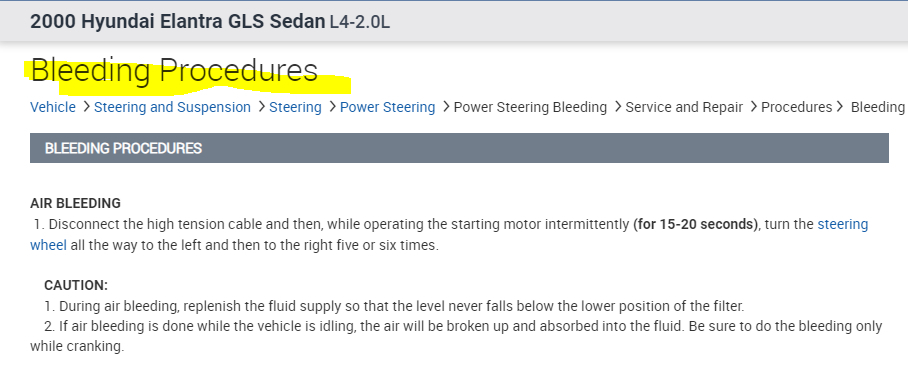

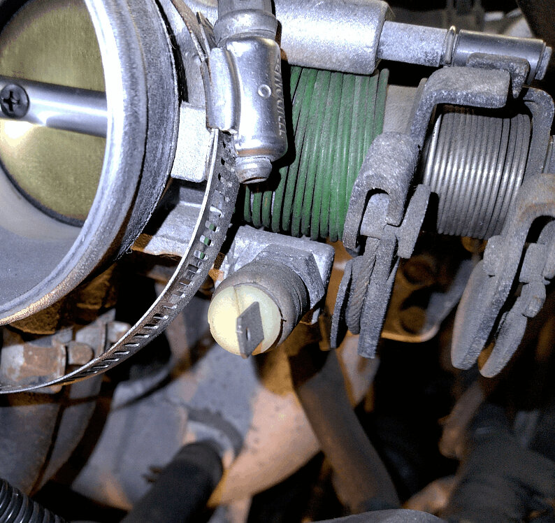

Removed the lines. 3 questions before installing the replacement part.

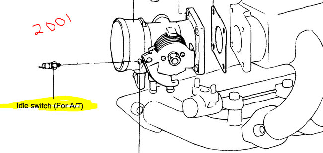

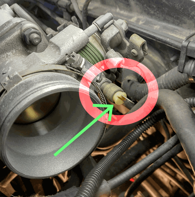

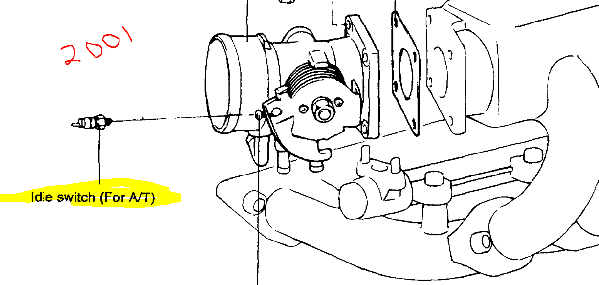

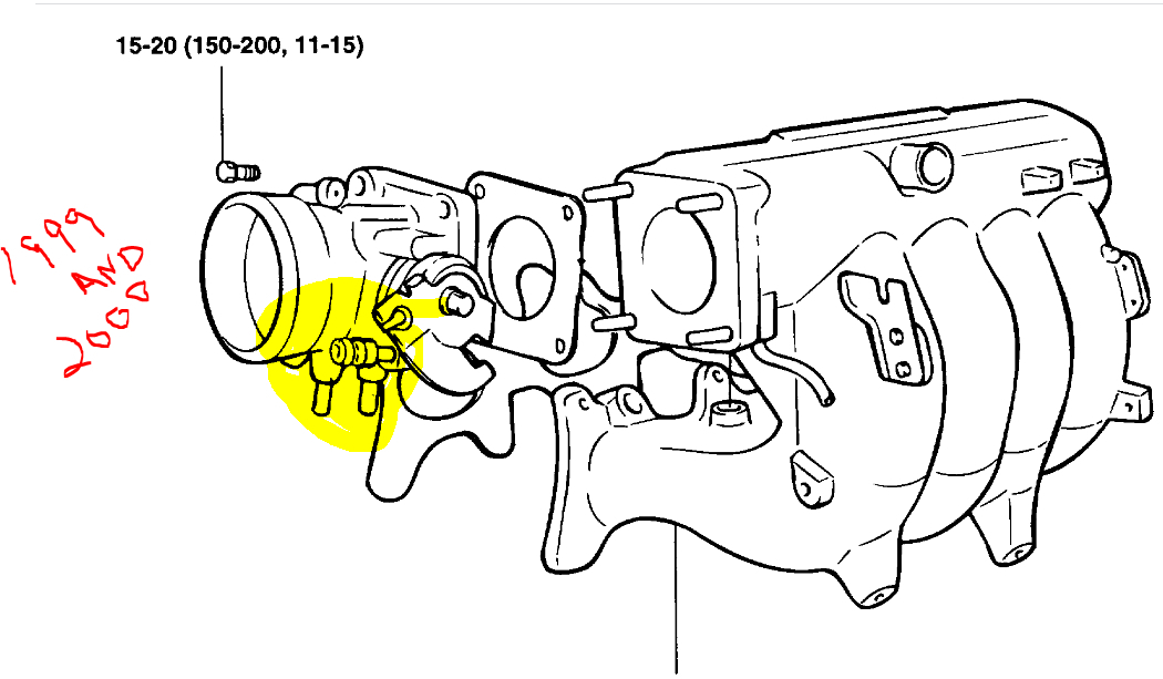

1. Please see the photo. What is this exposed electrical connector right next to the air intake? I don't think it was connected to anything but I'm not 100% sure.
2. Should I use red thread locker when putting everything back?
3. My owner's manual says PSF-3 power steering fluid should be used. But I cannot find any. What can I use? Would regular ATF work?
Advanced thanks.
Dec 1, 2023 at 8:42 PM
  • 110,194 POSTS
The PSF3 isn't even offered in the US. You can use standard power steering fluid from the parts store. If they have an Asian version, go with that. If they don't, use what they offer. It should be fine.
A thread locker would be fine. As far as the connector is concerned, I looked through the manuals because I don't recognize it. Does it appear to have ever had a connector? Since it is on the throttle body, I thought it was a position sensor, but that sensor has either a three or four-pin connector. Let me know.
Also, take a pic of the connector from the side so I can see what the pin is connected to.
Dec 1, 2023 at 10:04 PM

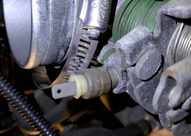

Here are 2 photos of the mystery connector from the side.

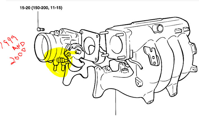

I finally figured out what that part is on the throttle body. I had to look on a 2001 model year, so I suspect your vehicle was a late production year vehicle.
It is an idle switch for a car with an automatic. I suspect they started using the new design throttle body a little early and it wasn't needed. Chances are that is why it appears nothing was ever connected to it and you don't remember a wire going to it. (see pics)
Pic 1 shows the design for the 1999 and 2000 model-year vehicle. Pic 2 is the 2001 model year.
Let me know if this helps.

Thanks for solving the mystery. In case something was attached to the mystery connector, and I didn't notice, and accidentally knocked it off, the car would probably tell me what's up by throwing an error code and turning on the MIL. Yes, it was a late year model and I purchased it brand new exactly 23 years ago.

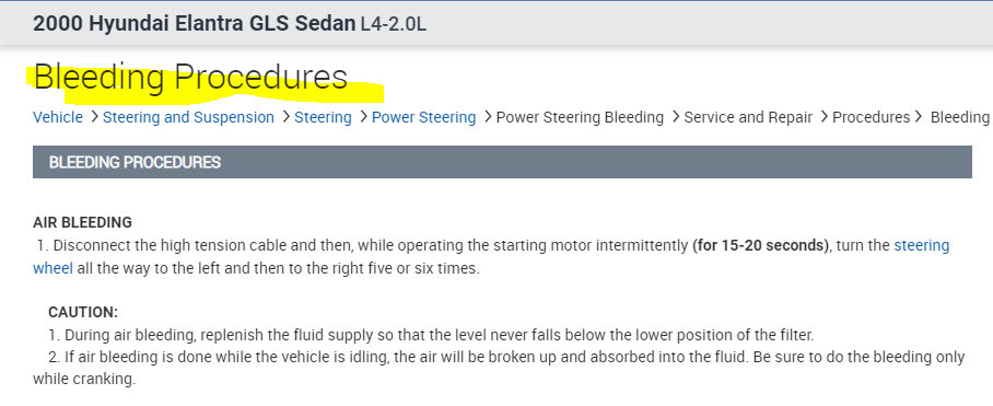

I did not put everything back together yet. I wanted to make sure that Loctite was okay to use. I'll be using 242 blue Loctite instead of the red.
I called the local auto parts stores regarding PSF3. One of them told me his store's system says it is okay to use Dex III ATF as Power Steering fluid for 2000 Elantra. They also have regular Power Steering fluid that should be compatible. The PS fluid that claims to be compatible with all Asian cars, which includes Toyota, is just Dex III according to one store. The Asian compatible PS fluid is also $18 for a quart. If they are rebranding Dex III as Asian compatible PS fluid and charging 3 times more, I don't want to fall for that gimmick. Do you think using $6/quart Dex III would be okay as one auto parts store claims?
Thanks in advance.
Dec 2, 2023 at 8:23 PM
  • 110,194 POSTS
I do feel that would be okay. It shouldn't hurt anything.
