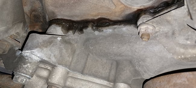

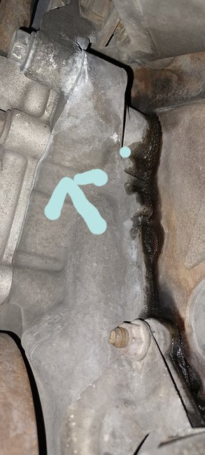

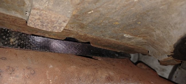

What is this leaking on the edges? Is it the water pump?

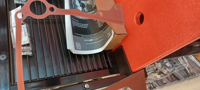

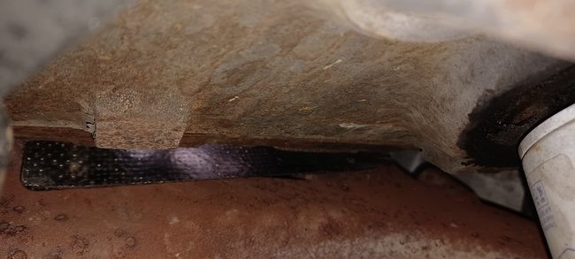

Also is this brown flat piece part of an exhaust manifold gasket i looked at bottom on both sides where. manifold is.
Mar 26, 2022 at 7:43 AM
  • 110,244 POSTS
The second pics you sent show part of the exhaust manifold gaskets. Pic 1 is a bit more difficult because I can't see if I'm looking at the water pump. As far as a leak, that is minimal. At least from what I'm seeing, it doesn't seem to be a problem. That really isn't uncommon.
Let me know if that helps answer your questions or if you have other questions.
Mar 26, 2022 at 12:00 PM
HIDDEN1
  • 107 POSTS
I just found out from looking at diagrams. That's the timing gasket! And maybe crank seal.

It's a U shaped gasket an the round crank gasket.

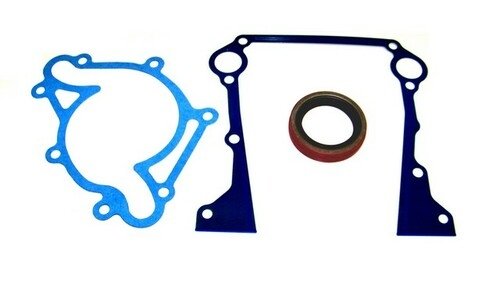

HIDDEN1
  • 107 POSTS
There is a kit with water pump gaskets, o ring to crank and the huge horseshoe shaped gasket. That's where my leak is at in pic.
Mar 28, 2022 at 1:24 PM
HIDDEN1
  • 107 POSTS
My water pump gasket is fine though.
Mar 28, 2022 at 1:25 PM
HIDDEN1
  • 107 POSTS
What is involved in replacing that timing chain gasket .. and crank seal..in the KIT?

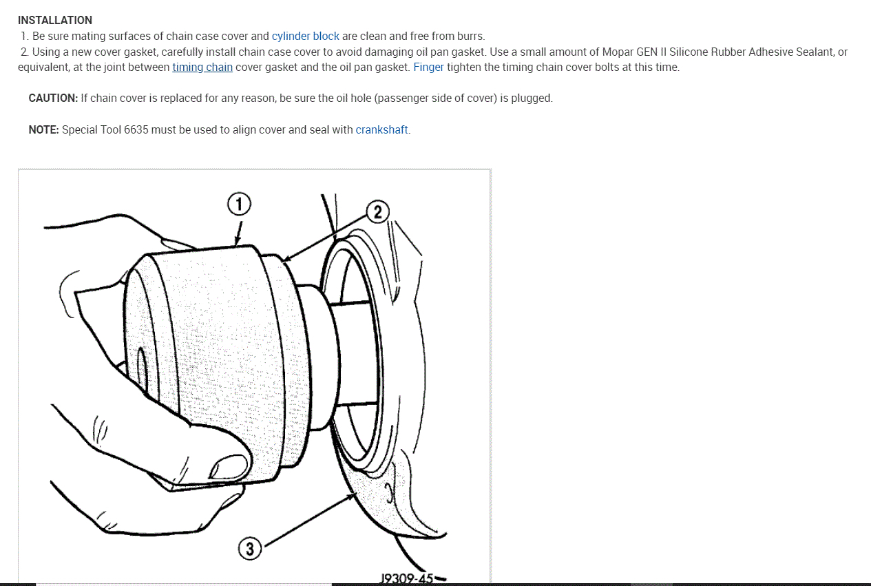

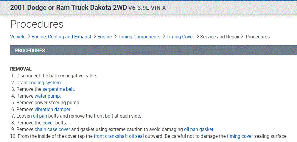

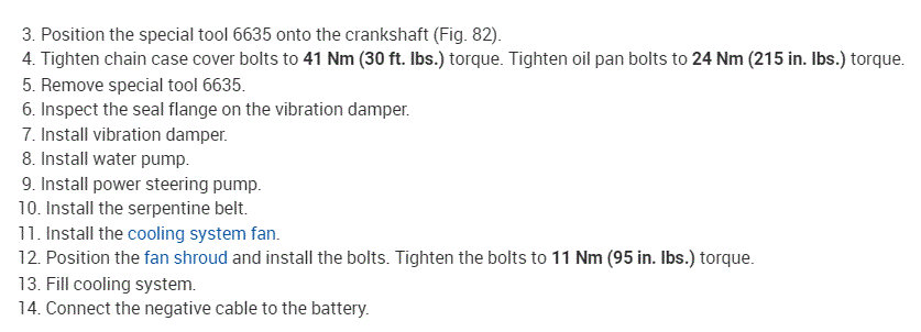

  • 110,244 POSTS

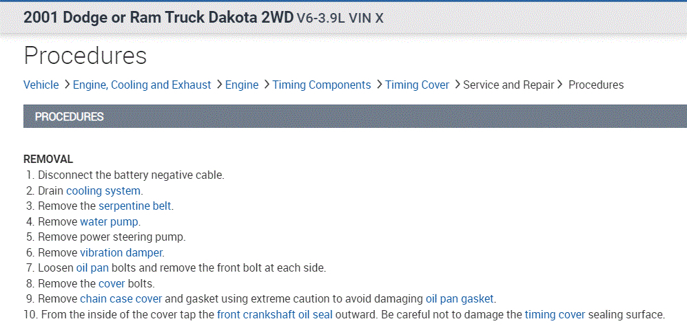

Replacing the timing chain cover really isn't too hard it does require the removal of several things to access it.
If you look below, the directions for the removal and replacement of the cover are listed. Also, based on the mileage, you may want to consider replacing the timing chain while you are in there. It will be exposed once the cover is off.
Mar 29, 2022 at 7:43 AM

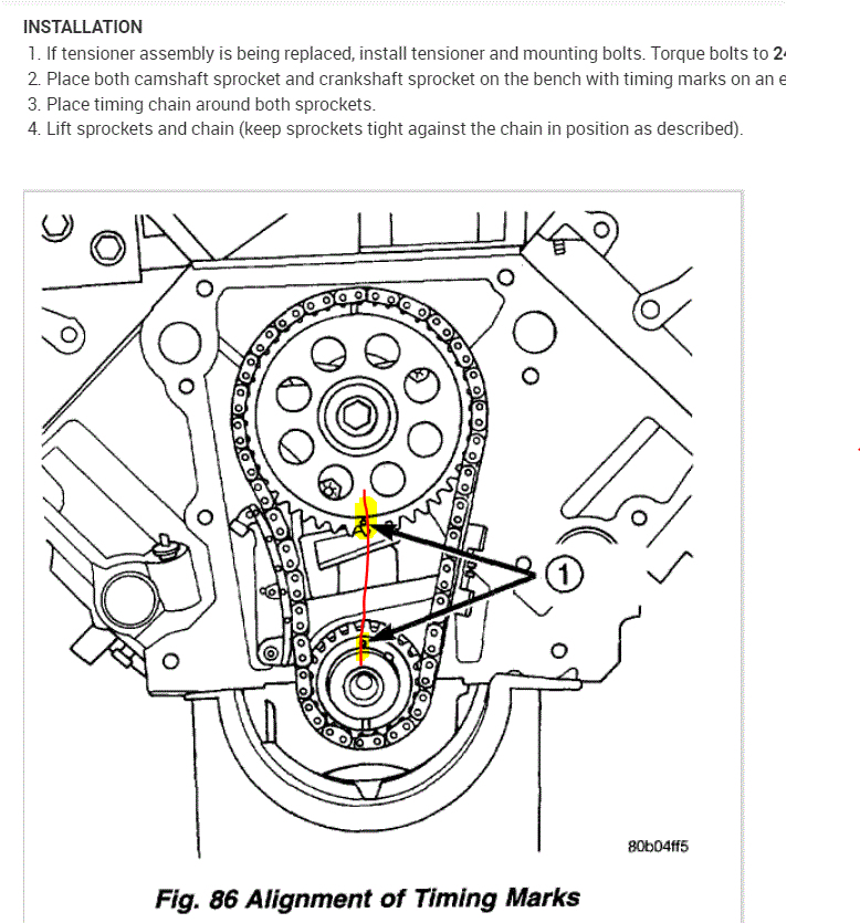

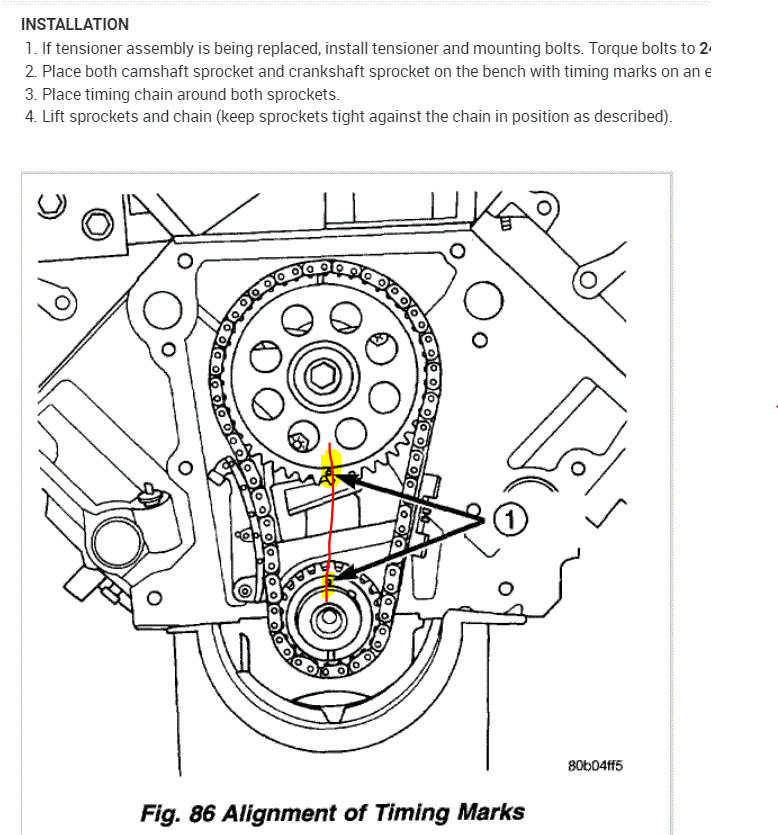

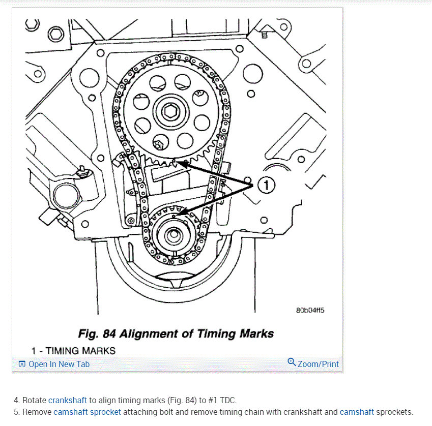

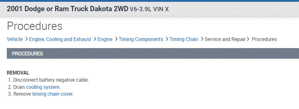

  • 110,244 POSTS

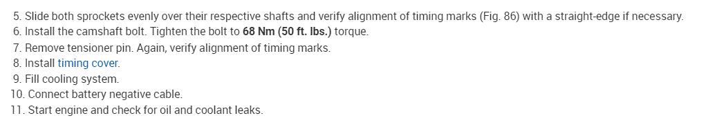

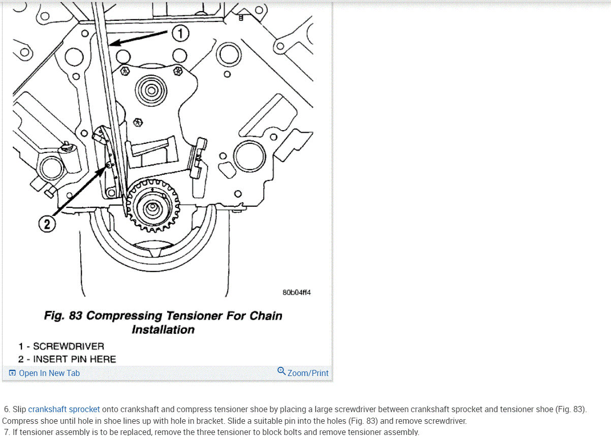

On this vehicle, it is really easy. Once the cover is off, there are only two sprockets to deal with, the crank pulley and the cam pulley.
The timing marks are really simple as well. The camshaft mark sits at 6 o'clock and the crankshaft mark sits at 12 o'clock.
If you do it, replace the tensioner as well. I attached the directions below.
