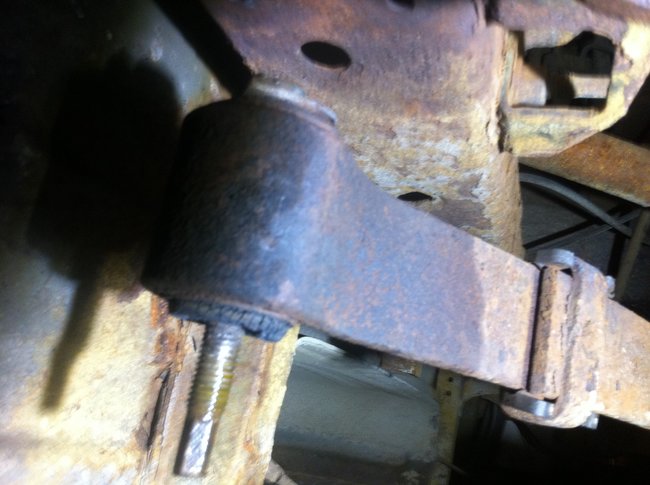

I had to change out my leaf spring shackles an hangers.I got the hangers off just fine but I can't get the bolt that holds the shackles on the leaf springs out. They won't even budge..Any ideas other than heating it? an changing the bushings also.Appreciate it.Thanks.

Both sides just have the bolt stuck.

Yep it is rusted on there hit it with wd40 and let sit overnight, then large pry bar to apply max pressure, then shock it with a hammer, don't be shy. Let me know.

Thanks.I'll try that.I did try PB blaster an a hammer but I didn't think of the pry bar.I'll let you know.

They can be life savers at times.So I put the tip of the pry bar behind the head of the bolt an hit the other side with a hammer numerous of times an no luck.I also used allot of PB blaster.That is what you were talking about right?

Just to add my two cents. I used to put jack stands under the frame to support the truck, then using a floor jack under the differential I would lower the whole assembly down after removing shackles to have enough clearance to punch bolts through to clear frame.Sometimes if equipped the tow hitch had to be removed as well. Hope this helps and thanks again for using 2CarPros.

That is what I did.I removed shocks from rear end an lowered it all the way.all that is left to take out are these bolts.I got everything else off.Thank you for the information though.

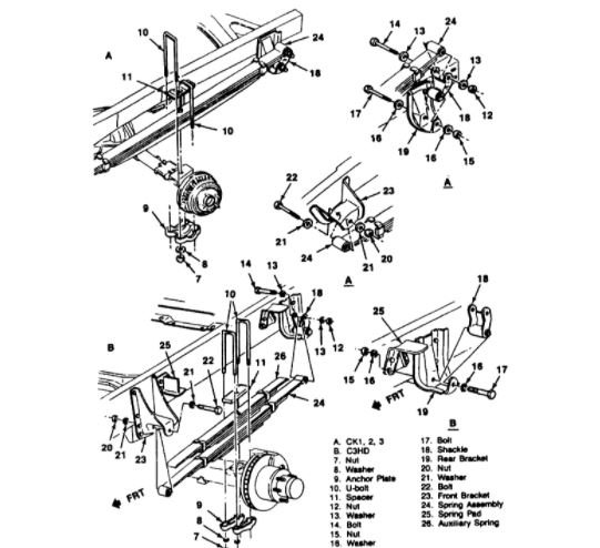

Okay, I attached the procedure for replacing the springs.
Make sure you use new U bolts and colts securing the front and rear of the spring mounts.
1. Raise and support vehicle, then the rear axle assembly.
2. Remove U-bolt nuts and washers.
3. Remove anchor plate, Fig. 5.
4. Remove U-bolts and spacer.
5. Loosen shackle to spring nut.
6. Remove shackle to rear bracket attaching nut, washer and bolt.
7. Remove spring to front bracket, nut, washers and bolt.
8. Remove spring assembly from vehicle.
9. Reverse procedure to install.
