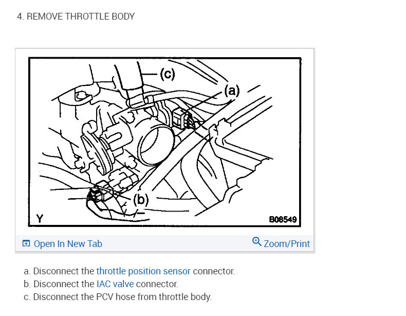

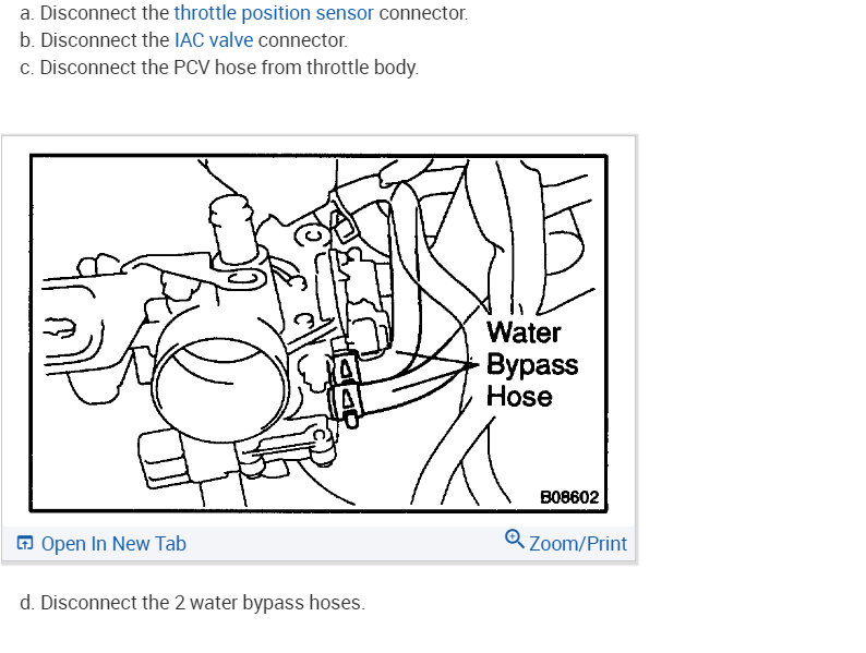

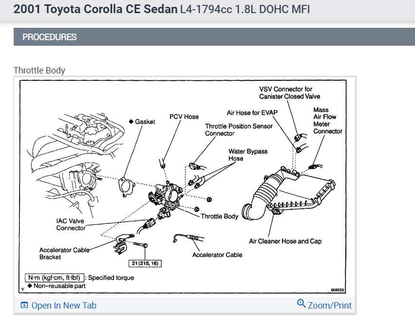

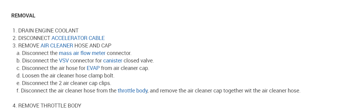

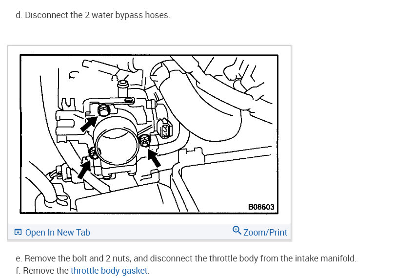

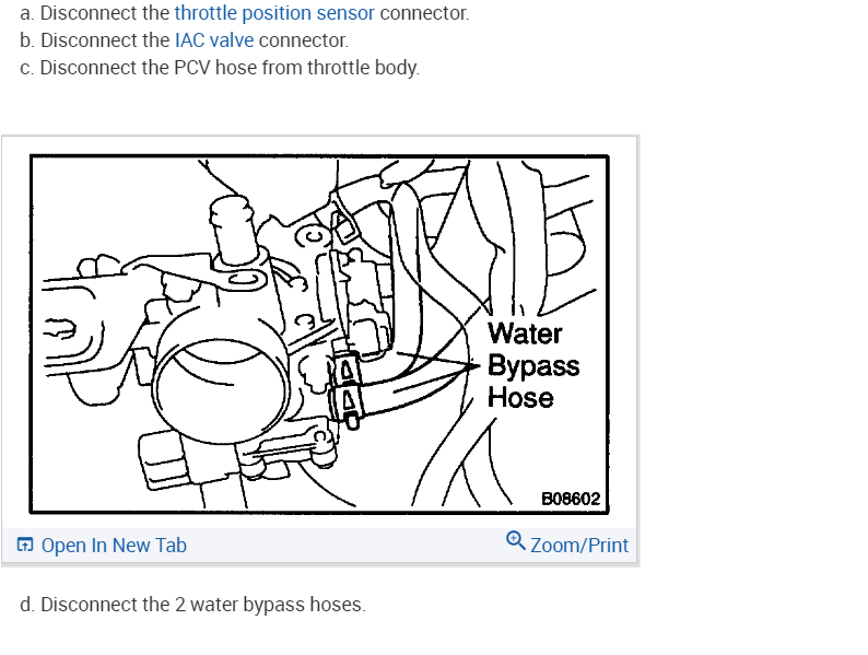

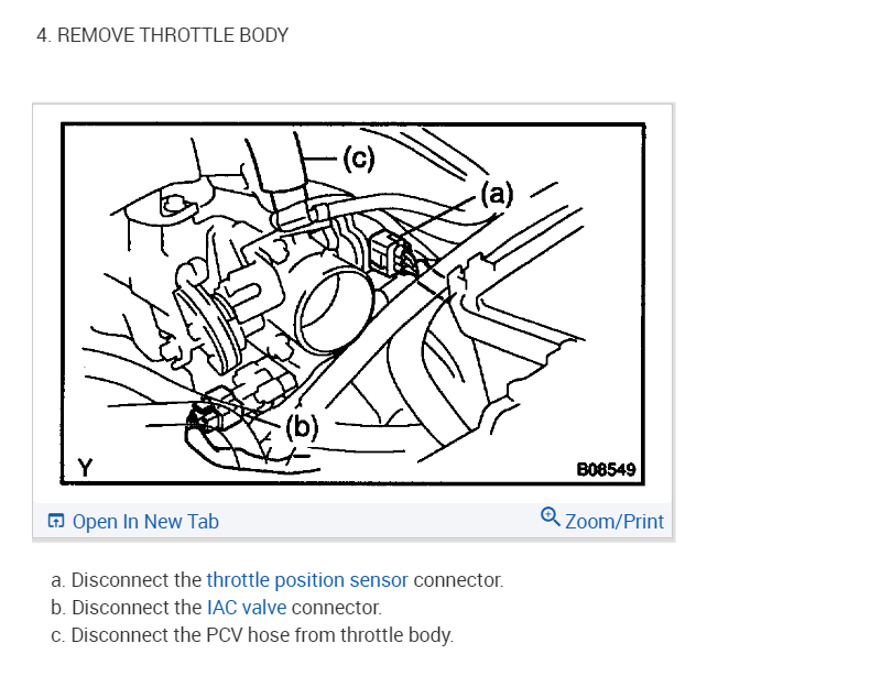

My car starts up lazy in the morning and when it warms up it becomes okay. i floor the acceleration pedal and it is not picking up speed. After a few minutes it starts moving fine.
May 16, 2023 at 6:40 PM
  • 55,456 POSTS
This sounds like you have a vacuum leak, or the throttle bore needs to be serviced, here are three guides to help with additional information below.
Use this guide when the engine is cold only:
and
and
https://www.2carpros.com/articles/engine-cranks-excessively-before-starting
