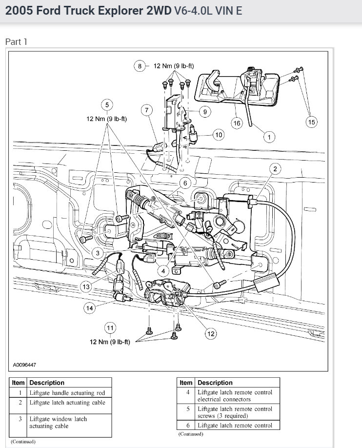

The Liftgate of my vehicle will open randomly causing not only a security issue, but the inside lights turn on. I may go for days without driving the car which means on occasion I find the battery has been drained from the inside lights. I want to take the inside cover off the latch gate mechanism but have not figured out how to do that. Can someone tell me how to remove the cover?
Thanks!
Tom
Jan 16, 2023 at 11:33 AM
  • 55,797 POSTS

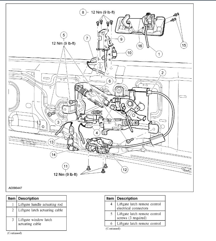

This can be because the latch is worn out or the striker needs to be adjusted outward. If the latch does not "close" completely it will pop open. You should hear the latch "click" when completely closed. If so and the liftgate still pops open the latch is bad and needs to be replaced here are the instructions to do so in the diagrams below.
LIFTGATE LATCH
Removal and Installation
1. Remove the liftgate trim panel.
2. Position the water shield aside.
3. Disconnect the liftgate latch actuating cable.
4. Remove the 3 liftgate latch screws.
- To install, tighten to 12 Nm (9 lb-ft).
5. Disconnect the liftgate ajar switch electrical connector and remove the liftgate latch.
6. To install, reverse the removal procedure.
- Lubricate the liftgate latch after installation.
Check out the images (below). Let us know what happens and please upload pictures or videos of the problem.

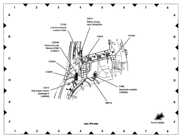

  • 55,797 POSTS

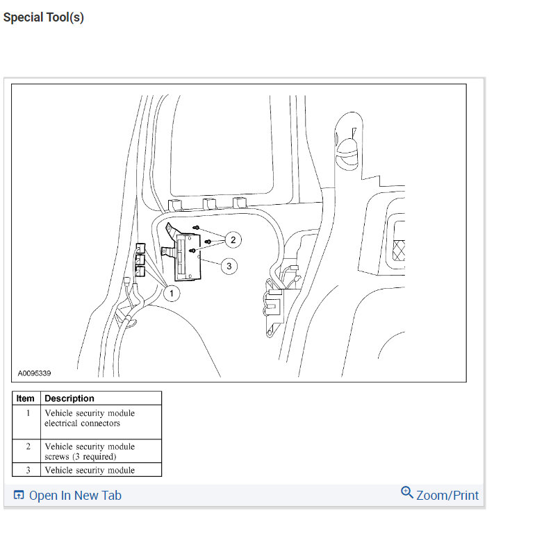

Sure, no problem, that is the liftgate window or rear window. This happens when the vehicle security module goes out here is the location and instructions on how to change it out. Please let us know what happens.

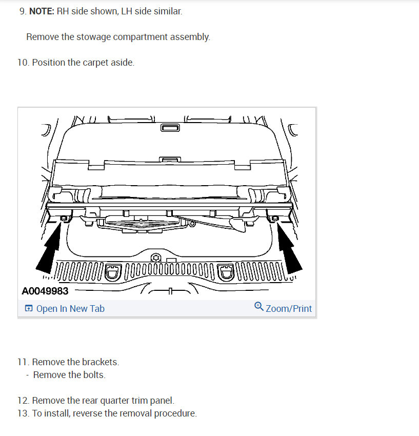

The frequency of the liftgate opening by itself has been much less... it seems it got less immediately following replacing the battery which was always going low. I would like to get to the suspect security module but honestly, I don't know where to start to remove the panels it is behind. Are there and instructions for doing that? I really don't want to make it look bad.

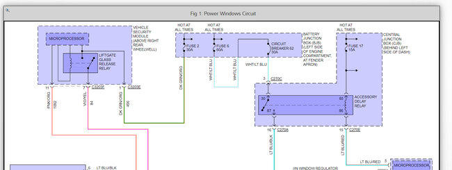

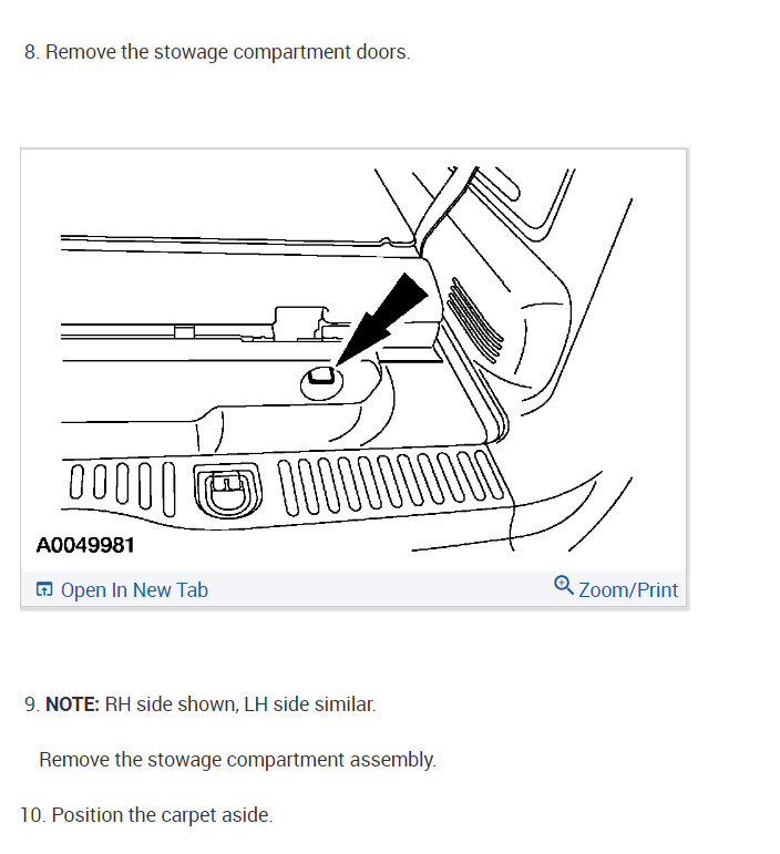

  • 55,797 POSTS

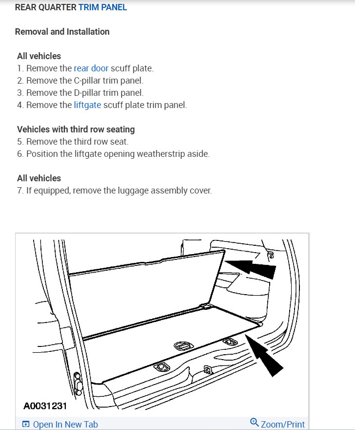

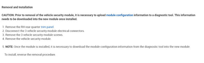

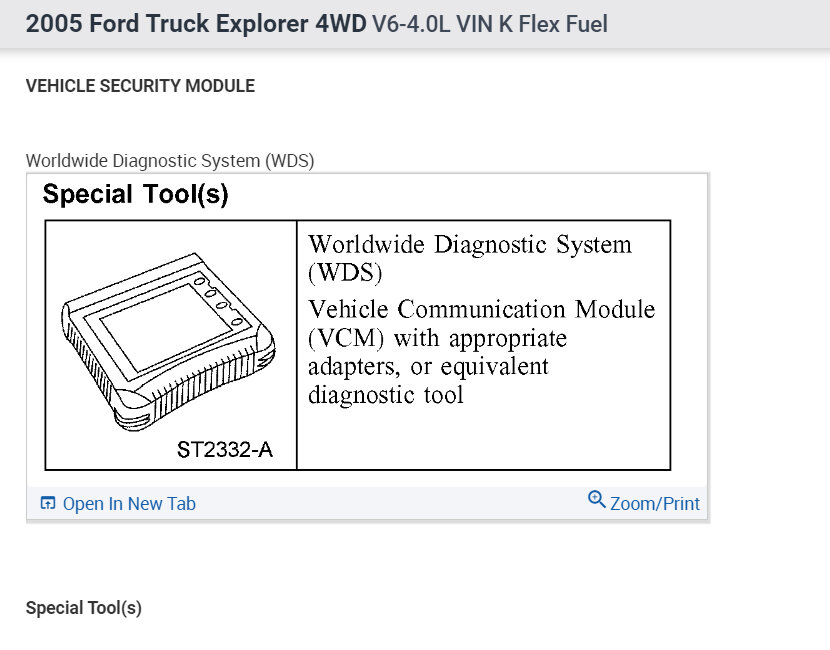

Good call on the security module here is the wiring to show you the control relay for the rear window is controlled by it, you should be able to get a rebuilt, preprogrammed unit by searching google or eBay. The module is located in the right rear quarter panel. Check out the images (below). Please let us know what happens.
Feb 9, 2023 at 2:42 AM
TECH2020
  • 42 POSTS
Hi Ken,
I finally had time and good weather to work on my ford, I`ve got no garage to work in. I located the security module and decided to try a special contact lube/enhancer on the connector pins in case the intermittent fault is somehow bad/dirty contact related before considering replacing the module- I often did this working as an electronics tech. I used Deoxit Gold, it is one of the best. I reassembled all the panels and parts that allowed access to the security module. Can you tell me if there are any connectors related to a liftgate window ajar sensor hiding under the liftgate panels? I've been afraid to pop off the plastic panels but getting to the security module pretty much cured me of that.

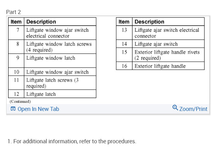

  • 55,797 POSTS
The sensor is in the latch of the liftgate. Please check out the images below to see what I am talking about. Check out the images (below). Please let us know what happens.
