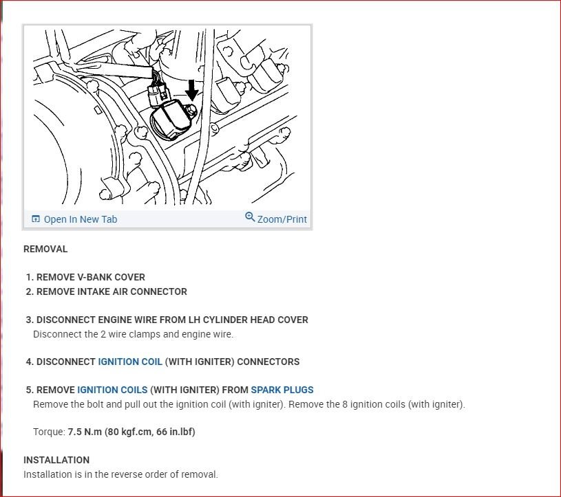

Hi! Fourth cylinder in my vehicle is misfiring. My first thought was to check the spark plug (and potentially compression while I’m there). Do you have any videos on how to change the spark plug on this type of car? (Or measure compression)

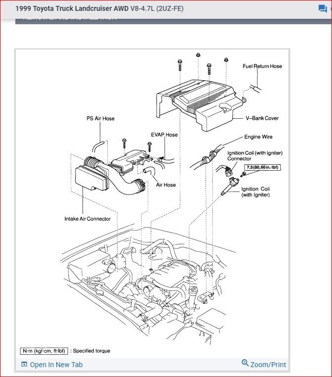

We don't have a video on this specific engine but here is how to remove the plugs according to the manual. Keep in mind this is specific to the coil but once you remove the coil the spark plug is in the hole these come out of. They didn't have a procedure for removing the plug but again, you will see the plug once the coil is out of the way.
