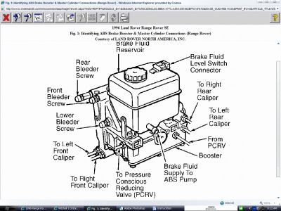

1996 Range Rover Diaghram or Picture of brake master cylind

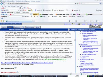

I have the connections and bleeding proceedures, no diagram for a rebuild, which by the looks of this unit, would be foolish anyway...
