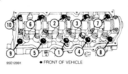

i wan wondering if anyboy knew what the torque specs and sequence would be on this 4.o L 2000 land rover discovery. I removed the heads because the head gasket blew and now i can't find the spec's

https://images.2carpros.com/forum/automotive_pictures/266999_land_14.jpg
Cylinder Head Bolt Step 1........15 (20) Step 2........Additional 90 degrees Step 3........Additional 90 degrees
