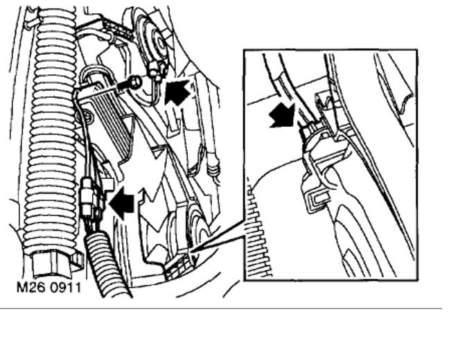

cooling fan relay location
2002 LAND ROVER FREELANDER
GIRWIN
Engine Cooling problem 6 cyl All Wheel Drive
I have a 2002 land rover freelander and the cooling fans use to run but I noticed the coolant level had dropped and the fans won't run. What should I start looking for?

I would start by checking out for a coolant leak becasue the fans wont run when the coolant is low.
Here is a guide to help you with that.
https://www.2carpros.com/articles/car-is-leaking-coolant
Next, check the fuses to see if one is blown and then check the cooling fans. These guides will help.
https://www.2carpros.com/articles/how-an-electric-cooling-fan-works
and
https://www.2carpros.com/articles/replace-electric-fan-motor
Here is a diagram from the manual as well.
Best, Ken
