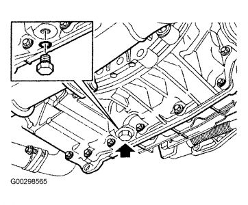

transmission fluid leaking how to check fluid level and replace fluid what kind of fluid i can use?
Apr 28, 2010 at 9:54 AM
DAVE H
  • 13,383 POSTS
JATCO A/T - Drain & Refill WARNING:Use extreme care when draining transmission fluid as the fluid is VERY hot. NOTE:Transmission fluid should be drained with transmission at normal operating temperature. Raise and support vehicle. Apply parking brake and position chocks under front and rear wheels. Remove underbelly panel. See UNDERBELLY PANEL under REMOVAL & INSTALLATION. Position suitable container under transmission. Clean area around drain plug. See Fig. 4 .

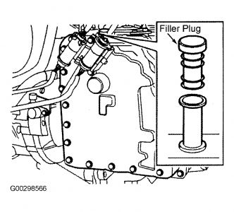

Remove drain plug and discard sealing washer. Allow fluid to drain. Clean drain plug and install NEW sealing washer. Install drain plug and tighten to specification. See TORQUE SPECIFICATIONS. Clean area around filler plug. See Fig. 2 .
https://images.2carpros.com/forum/automotive_pictures/266999_2_20.jpg
Remove filler plug. Add correct amount of fluid through transmission filler hole. See FLUID CAPACITIES . Clean and install filler plug. Check and top off fluid level. See CHECKING FLUID LEVEL . Install underbelly panel. See UNDERBELLY PANEL under REMOVAL & INSTALLATION. Fig. 4: Removing Transmission Drain Plug & Sealing Washer Courtesy of LAND ROVER NORTH AMERICA, INC. FLUID CAPACITIES FLUID CAPACITIES ApplicationPts. (L) Intermediate Reduction Drive2.3 (1.09) JATCO A/T7.4-8.5 (3.50-4.00) RECOMMENDED FLUID CAUTION:Use of fluids other than those specified may result in serious damage to components. RECOMMENDED FLUID ApplicationFluid Description JATCO Automatic TransmissionTexaco N402 Intermediate Reduction Drive (IRD)(1) Texaco S5 75W90 Synthetic Oil (1)Or equivalent with API GL5 specification.
