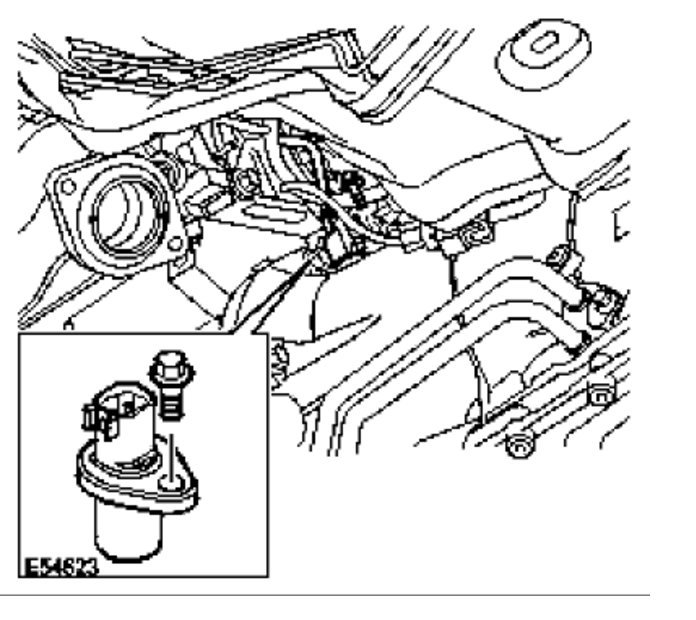

I have had an intermittent starting problem on my D3 this week. The starter motor turns as normal but engine does start. There are no system error displayed.
Usually OK from a cold start but not a hot start.
Thanks.

Two things come to mind first is the crankshaft angle sensor is bad and needs replacement. Here is a guide that will show you what you are in for when doing the job. (diagrams below).
The next would be the fuel pump has failed which the pressure will need to be tested.
Here is a guide for the engine not starting
Please run some tests and get back to us so we can continue helping you.
