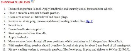

My question is, where do you check the transmission fluid level on my Landrover? Thank you, Marie
