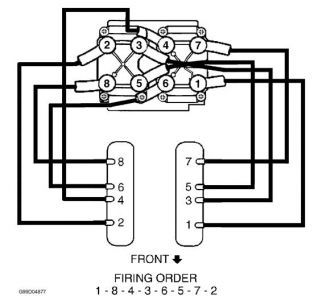

i changed my valve head gasket and put everything back together now it wont start ..that was one problem after someone said i was"nt getting a spark i checked the distributer cap the order has been mixed up now i dont know how too hook it back up on the cap the wirse are labeled for the spark plugs from 1-8 and on the cap one side say 1-4 then the other has 1237.......can u help me with both problema
