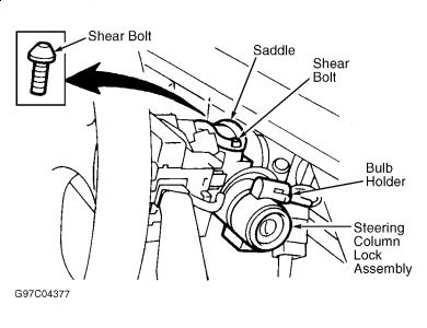

I have looked till i'm ready to blow the car up for a way to r&r the key and barrel but find no way to release the old one or to remove the whole switch.

remove the shear bolts by tapping in a counter clockwise direction !!
https://images.2carpros.com/forum/automotive_pictures/266999_land_4.jpg
