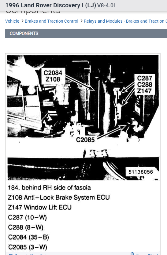

i push hard the break is not holding and it looks something burning what happen?
Jun 4, 2009 at 6:14 PM
SQM
  • CAR REPAIR CONTRIBUTOR
  • 6,383 POSTS

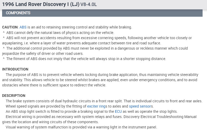

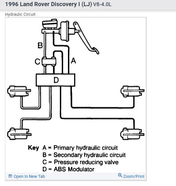

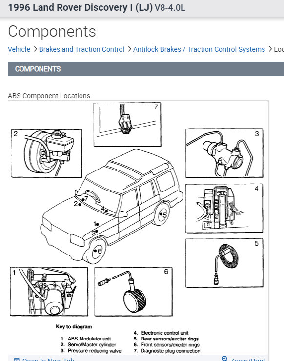

Brake locking up could mean an issue with the ABS system of the vehicle.
It could be an issue with the electronic brake control module, which is part of the ABS system. It provides pressure to each wheel.

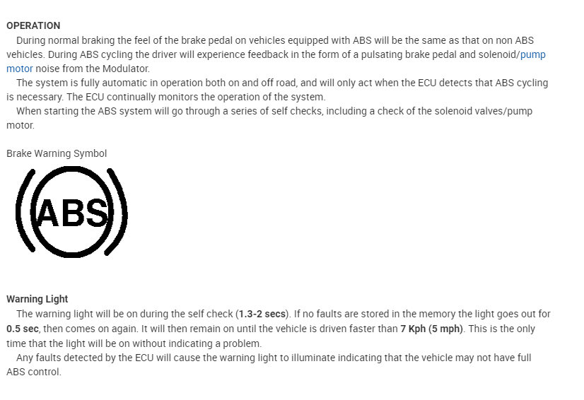

Typically, when there is ABS malfunction the ABS light get illuminated.
Is that light illuminated on the dash?
If so the first step would be to scan the vehicle and retrieve the ABS code(s).
Here is a helpful video on how to scan for ABS codes:
https://youtu.be/rTtAnsOlZU4
By retrieving the trouble codes, it can help with the diagnostic process.
