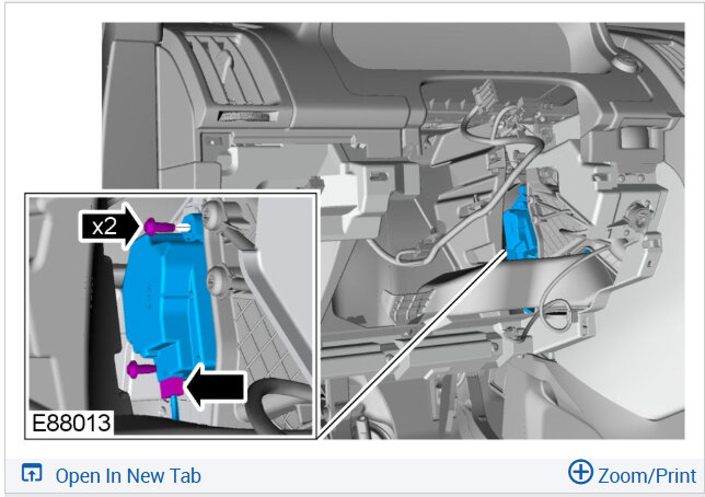

How do I find the blend door actuator for the driver side on my vehicle listed above? I see the parts moving on my passenger side when I turn the air on but how do I get my air to blow cold on the driver side ? Help Please.

Yep, this happens when the drivers side blend door actuator goes out. Here is the location so you can swap it out and fix the problem. The actuator is on the drivers side so you will need to remove the lower part of the dash on that side with the metal brace as well to gain access. Once the part is replaced reset the HVAC system so it will calibrate. this guide will show you how, also check out the image below to help do the job.
https://www.2carpros.com/articles/step-by-step-guide-to-reset-your-cars-hvac-system-an-essential-for-every
Check out the images (below). Let us know how it goes.
