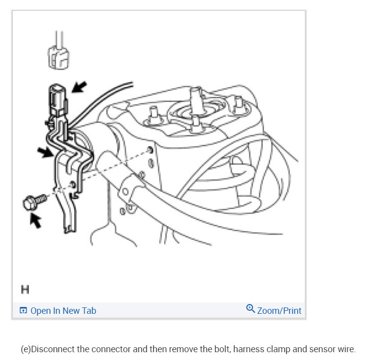

Vehicle listed above is a model 202 ZX Japan Vision. My VSC , engine econ , 4LO EON and slippery car econ lights up. what is wrong? how do i fix it ?
Dec 7, 2019 at 5:48 PM
  • 54,840 POSTS

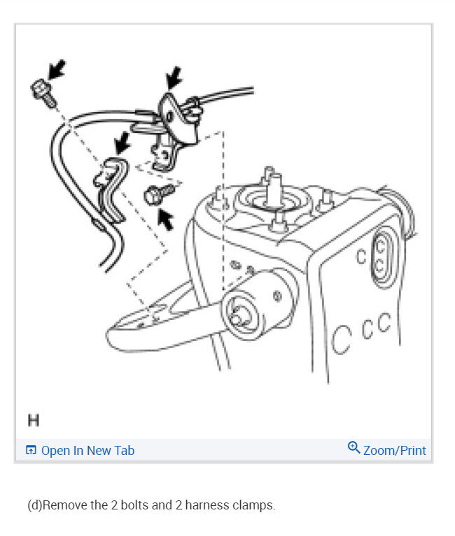

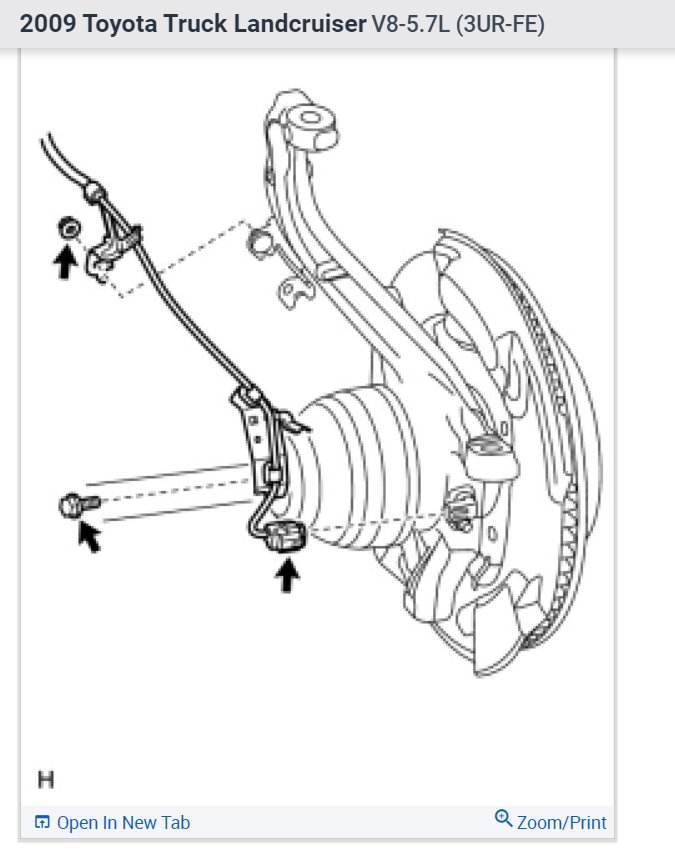

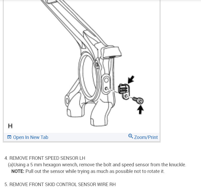

These lights usually come on when one of the wheel speed sensor goes out. To be sure lets run the codes to tell us which one or if something else is wrong here is a video to show you how. Please check the front bearing hubs because if they are loose the sensor cannot read correctly which will cause the issue as well.
https://youtu.be/rTtAnsOlZU4
Dec 8, 2019 at 6:15 PM
WYK9123
Hello, Ken. Thank you for your rely. Today I have my car diagnose . The result say that some of the wire connection is not connect properly and loosen. I have it fix and come out okay for my car. Thank once again for your reply.
