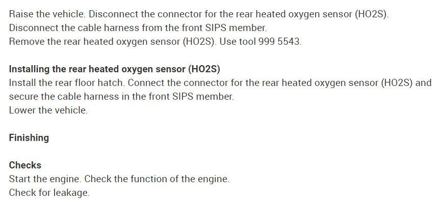

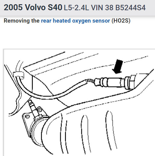

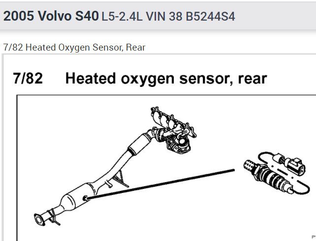

Hi looking location for rear lambda sensor on my car. Got a diagnostic done told me lambda probe two bank one.
Got this confirmed as rear sensor not the first one on the manifold. Is it on the exhaust after the catalytic converter or before?

Here is the information you requested. This is a tutorial for you to view showing how to replace an oxygen sensor:
https://www.2carpros.com/articles/how-to-replace-an-oxygen-sensor
I've attached picture steps and the location of the bank1 sensor2 oxygen sensor and replacement steps below for your vehicle. Hope this helps and thanks for using 2CarPros.
