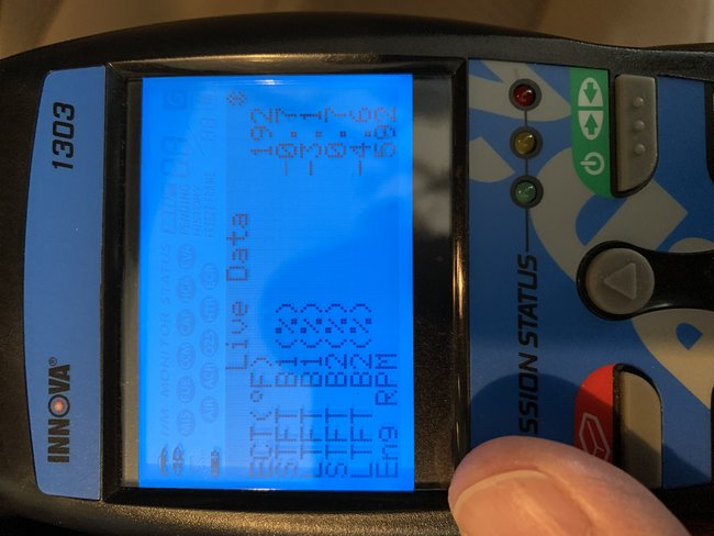

This truck feels like it's lost power and accelerates poorly, especially at lower RPM's. Gas mileage also down about 2 MPG and it seems like it even cruises on the freeway at a higher RPM and with worse gas mileage, at least according to the instant mileage on the dash. The other strange thing is that it seems much better early in the morning when I first start it and the longer it runs the worse it seems. Dealership has checked it a couple times and says everything is as it should be and it's never thrown any codes.

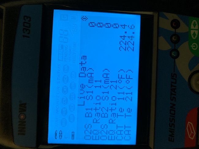

I've replaced the MAF sensor and the spark plugs, I've checked for vacuum leaks with carb cleaner while the engine was running and couldn't find anything. The last thing I was supposed to check was the catalytic converter but hadn't gotten around to getting an infrared thermometer, but I noticed on my scan tool there are 2 readings (see first picture) which I assume are the intake and exhaust temperatures which are almost identical, so it's not the cat then correct?
I disconnected the battery and pulled the throttle body yesterday to clean it. It didn't really seem dirty but after I reinstalled it, the truck seemed to run much better. But this is the same thing that happened after changing the MAF. It seems great initially but then relearns all of it's bad habits and the good feeling doesn't last very long.
Any other things I can check with my older consumer scan tool? I'm going to be towing in the summer and if there's a problem I'd really like to get it resolved before then.

I think I was working with you. As far as the catalytic converter temperatures, yes, there are two. See pic 1. Also, the temp shown on the scan tool is low. For a catalytic converter to operate normally, it should be between 400° F and 600° F.
I noticed the scanner offers live data. Can you let me know what the short term fuel trims are? The will be listed as STFT.

Yeah, I’m an idiot, when I quickly glanced under the truck yesterday, I only saw the one catalytic converter, the other one kind of hides behind the frame. So those readings don’t tell me if they’re clogged or not then. The temperatures were low because I took that after a real short drive yesterday to show you the readings. But the 400-600 you quoted has me concerned because I swear after a long drive yesterday while I was watching those temperatures were in the 800-1000 range.
I’ve attached a picture of the fuel trim readings below. That was taken idealist in my drive after a short ride home this afternoon.

The fuel trims look good. As far as the temp, 400 to 600 is where it truly starts working. What you saw is normal. Actually, they can reach up to 1600°F.
Here is a link that explains how to check a catalytic converter. See if it helps.

Hi, so I was able to get a thermometer and finally checked the catalytic converter’s. After a short drive home from work the scan tool said the catalytic converter sensors were about 640 degrees. With the thermometer these are the readings I got on each catalytic converter with the engine running.
driver side 308 incoming 340 exhaust.
passenger side 312 incoming 350 exhaust.
So based on these readings and the guide you sent me the catalytic converter’s are working okay then? If that's the case what else can I check?

The temperatures seem normal. When power loss and a decrease in MPG occur, the first things I look at are the catalytic converters, which you have done, fuel pressure, the need for a tune up, and even a coolant temperature sensor.
Since the fuel trims are in line, that eliminates fuel pressure and likely the coolant temperature sensor. You have eliminated the catalytic converters and tune up. Is there any drag on the vehicle when driving? Also, are there any smells or sounds you can think of that may help me?
