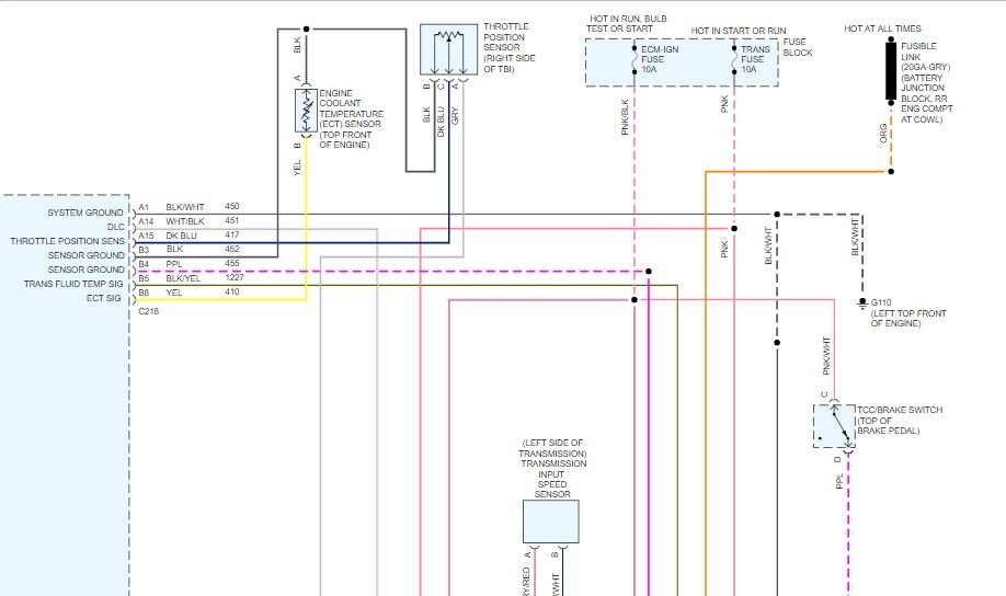

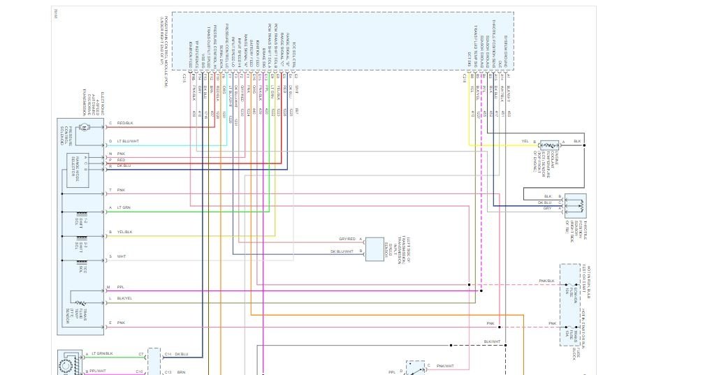

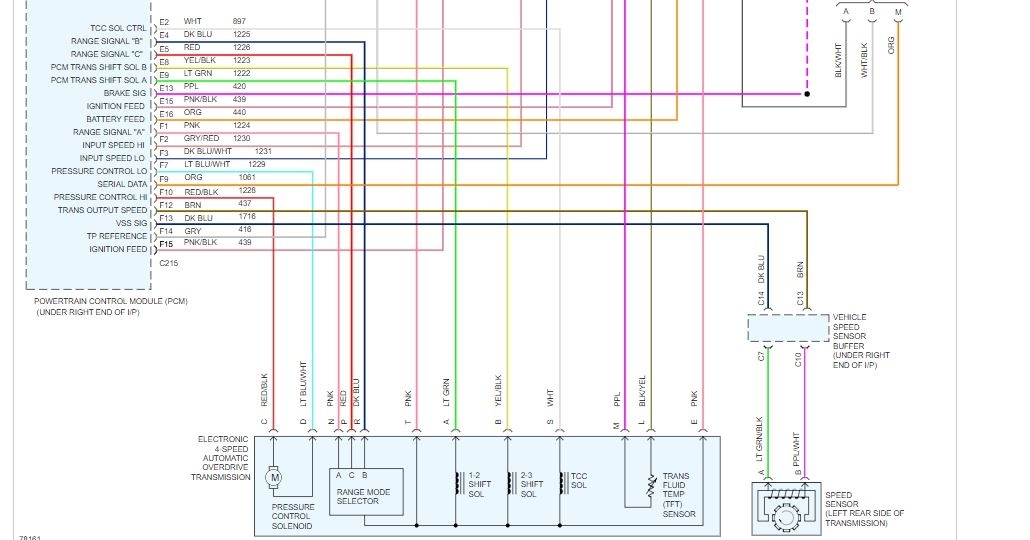

Got it.
The transmission is the issue. You may not be in first gear when you pull out. The torque converter can still be locked in as well.
Again, you need to repair the harness to work with the ECM and let the ECM control the shifting.

No, it will not affect it at all.
You need to put all the wiring back together and let the engine control the transmission as it should.

Put the wiring back and now transmission is stuck in limp mode no shifting what so ever. can’t even shift with selector and doesn’t run any better acts like it’s flooding out. Will the ECM from a 4l60e control a 4l80e? With the added VSS and the 3-2 shift disconnected.
May 24, 2019 at 12:21 PM
No, it will not. You need the correct ECM with the prom for the 4L80.
Added VSS ?
May 24, 2019 at 9:18 PM
MANZOLARRY24
  • 28 POSTS
The 4l60e only runs the VSS off the transfer case tail shaft where the 4l80e runs 2 VSS one one the tranny case and one on the transfer case. I got some power out of the engine by advancing the timing to about 8 degrees at idle with the tan and black wire disconnected and when connected its about 28 degrees it now picks up speed faster and doesn’t bog down as bad going up hill but still have to drop to second gear to make it up the hill but I’m talking like steep 1/2 mile plus stretches up hill and it will run 80 plus on the hi way. Thanks for the help I will look for another ECM that was connected to a 4l80e with a 350 engine I just don’t want to have to change the connectors to the ECM or the wiring harness I think I’ve spliced wires enough
