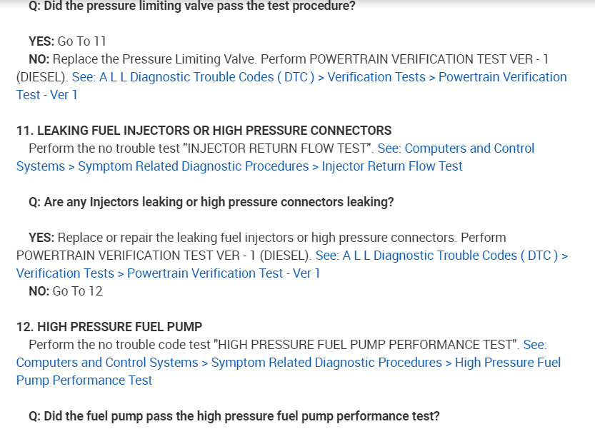

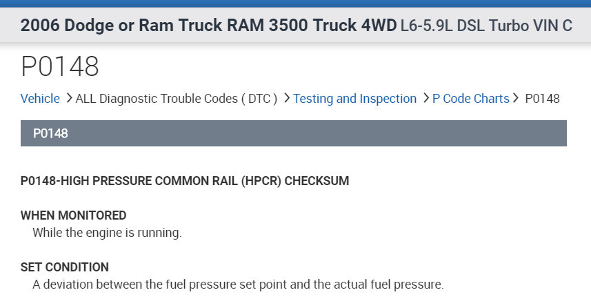

i have a Ram 3500 diesel 5.9 Cummings. code p0148 is coming up. not sure why. i have change the fuel pump and the FCA but still getting same code. also truck has a dead pedal.
Apr 6, 2019 at 4:13 PM
SCGRANTURISMO
  • 4,897 POSTS

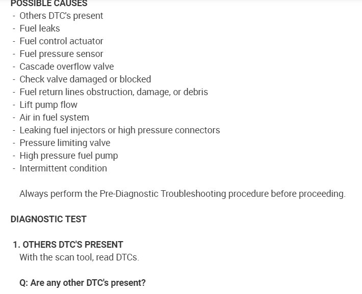

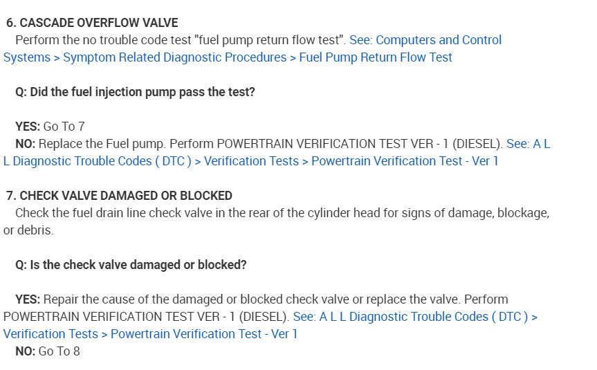

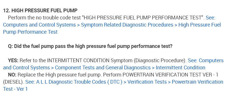

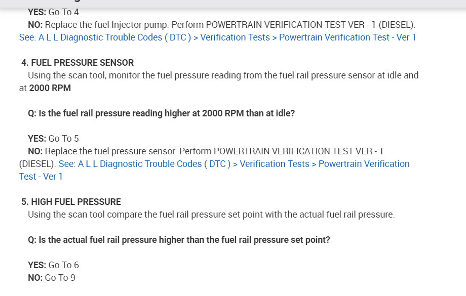

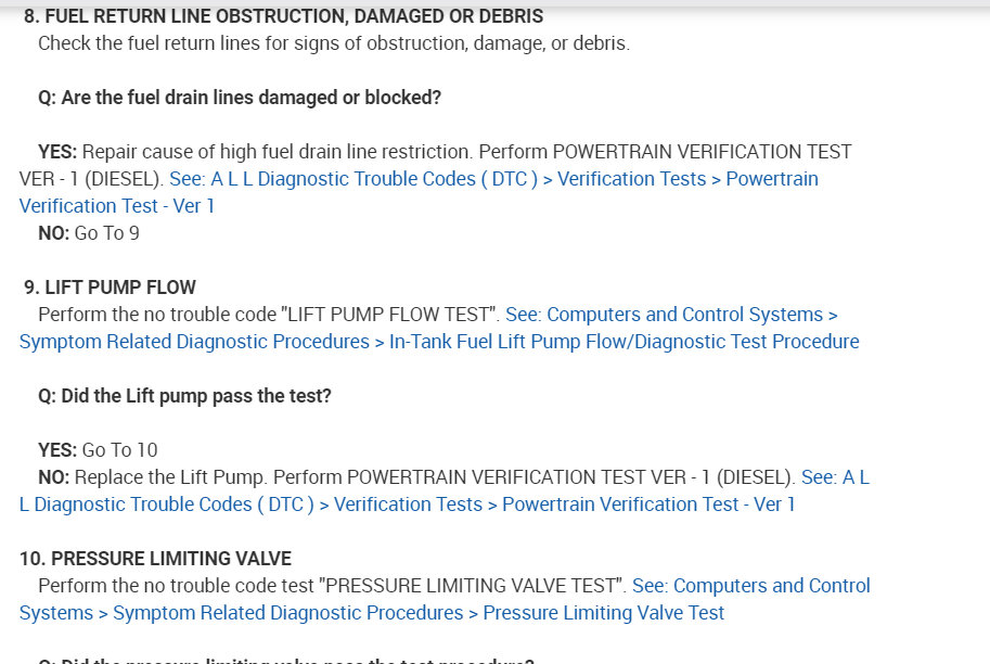

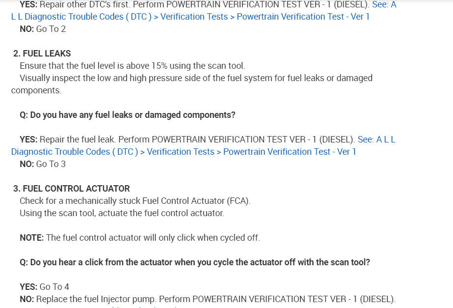

Did you reset your Power-train Control Module (PCM) AKA, computer" after you fixed the Direct Trouble Code (DTC)? If not do that. If you are still having a problem in the diagrams down below I have included a factory diagnostic troubleshooting flowchart for DTC P0148. Please go through it and get back to us with what you find out.
