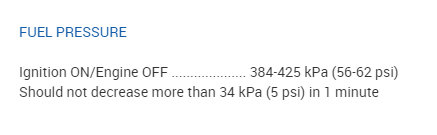

10, 25, 45, 55, and 60psi took five times of priming to get to 60psi.
44-50 at idle.
44-46 under load ( holding brake pedal and giving gas).
I also attached a video of me driving up a freeway on ramp. You can hear it shift and the psi goes from 44 to 62psi. I let off and then pushed the pedal to the floor and the psi goes from 42 to 72psi. Thank you for your help.

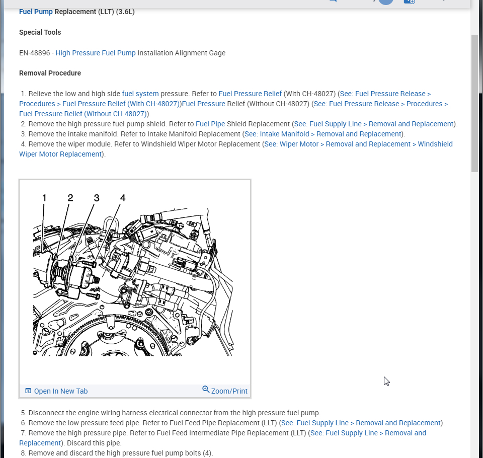

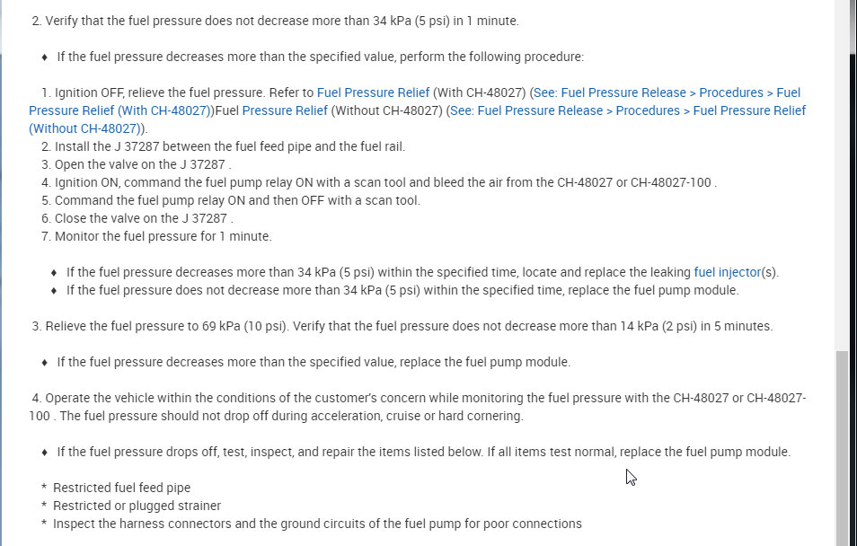

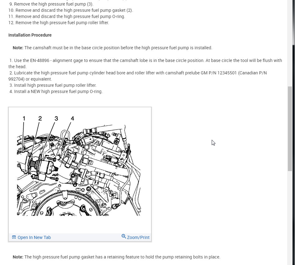

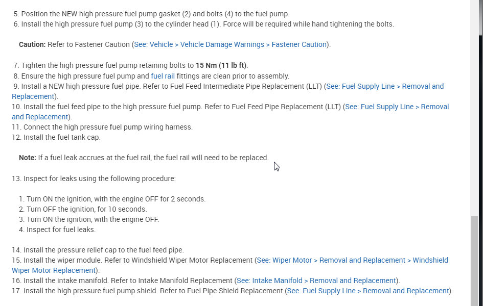

So I suspect you have a pressure issue. Not only during key on, you should have 56-62 PSI at first key on. Lack of priming is enough but then running pressure should stay pretty constant around 55 PSI and then it increases as you accelerate harder. With it bouncing like that and then being low around 40 just isn't correct.
So you either have an issue with the pump or a restricted fuel system. The filter on this vehicle appears to be part of the fuel pump module so it is not something that you can try changing.
Based on this info, I would change the pump and retest the vehicle. If you want more proof, I attached more testing of the pump. Let me know if you have more questions. Thanks
