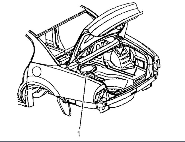

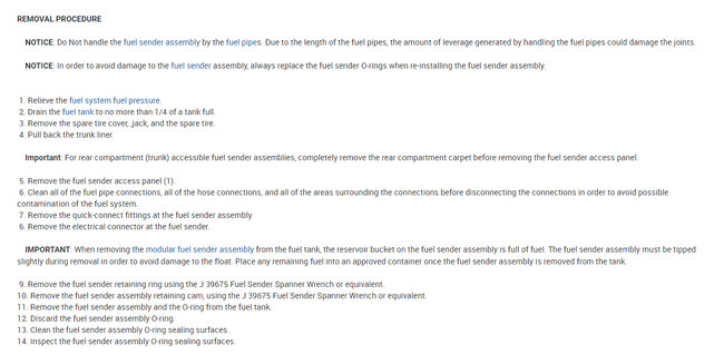

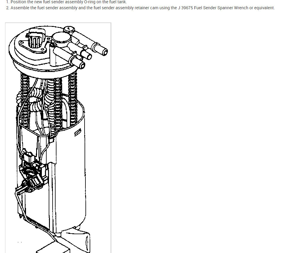

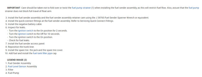

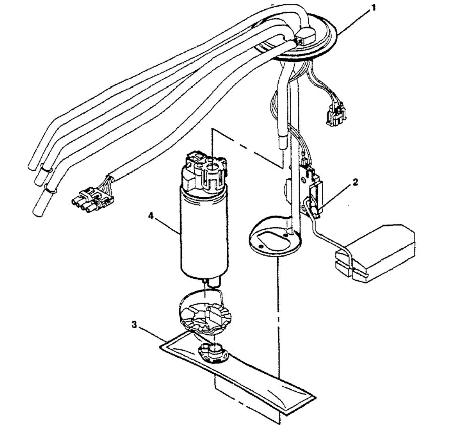

I also attached the procedure for replacing the pump. This one you can access from the trunk. You do not have to remove the tank from the car.
