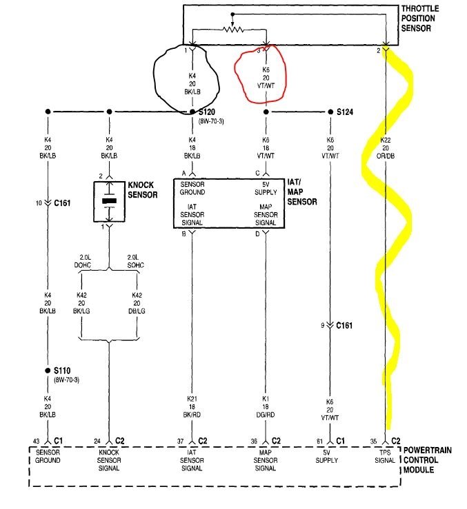

Check light on starts up. Drives, however when shifting in 1, 2, 3, 4, 5 gears works clutch pushes in there is hardly power. it lacks power have to rev it high to get it to go.

Hello Steve, thank you for your info. i did go to AutoZone coded po120 po121 po122 po123.
Came up throttle/pedal sensor, i replaced that sencer, however looking more into it on back side i believe on transaxle and the speed sensor is not hooked up, also speedometer is not working. don't even think speed cable in. now the car since changed throttle sensor drives better but still lacks power to go, feels like i'm always starting in low gear when i'm really in first gear. thank you for any of your help.

Those are all TPS circuit codes, they do not normally mean the sensor itself is the issue, they mean that there is an issue with the signal from the sensor. That commonly means a connector or wiring problem. In this case it is showing the signal is going high and low from what is expected which could be as simple as a bad connector. Testing this shouldn't be difficult. You will need a simple multimeter that can show voltage. There are 3 wires that go to the TPS. One (Black wire blue stripe) is the sensor ground, The next (Violet with white stripe) is the 5 volt power feed to the sensor and the third, (Orange wire with dark blue stripe), is the signal back to the PCM. In operation the signal wire should show a voltage from zero to almost 5 volts in a smooth change as the gas pedal is pressed. For it to show the codes you have the signal line is sending a signal different than expected. I would first check at the connector itself for any corrosion or loose fit. Next I would use the meter to verify that the ground and power wires to the sensor are both correct.
Then I would inspect the wiring harness from the sensor for any damage like rubbing through or broken wires.
The lack of a speed signal will also cause a similar low power issue, for that you will need to check to see if the wires that are disconnected are broken or damaged and reconnect them.
