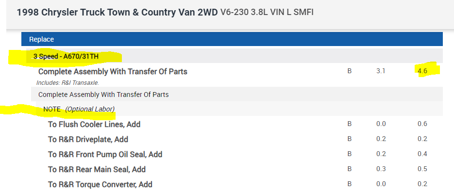

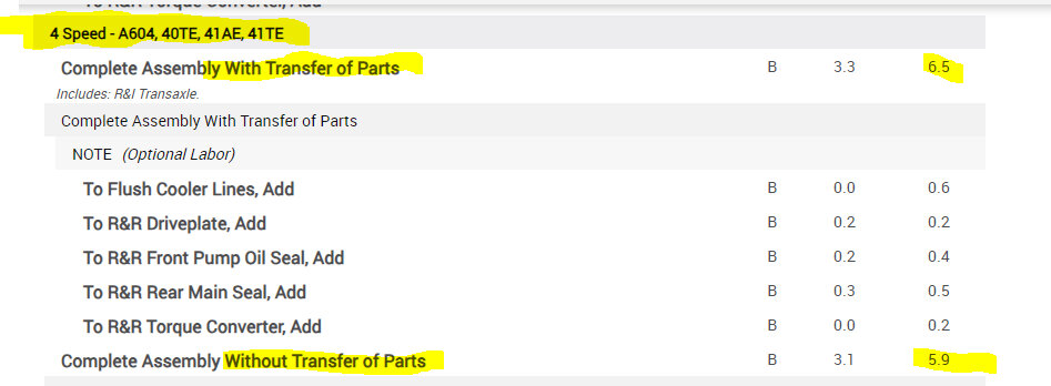

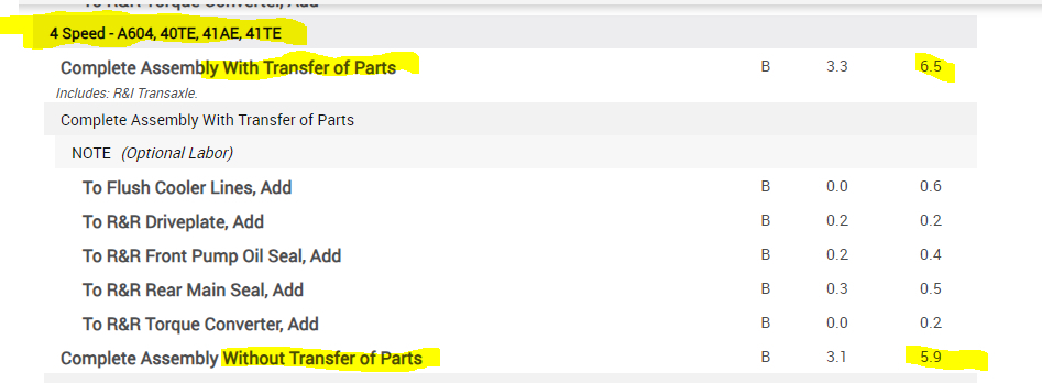

Finally diagnosed our transmission problem after a swap. After testing every possible scenario for the DTC P0733, P0734 I realized the RPMs shot up on upshifting to gears 3,4. The Valve Body Is Shot. I ordered everything needed but determined this is beyond my expertise level so will have a shop do the work (dealer has same hourly as the idiots who installed the transmission). I need to know what mechanic labor time is, can't find a simple answer online as usual. Flat Rate Time is okay.
Feb 24, 2024 at 2:35 PM
  • 110,194 POSTS
Two different transmissions may have been used. One is a three-speed and the other a four-speed.
If you look below, I attached labor rates for both.
Take a look and let me know if this is what you need.

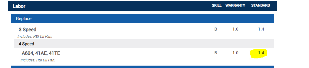

41TE/A604 4spd FWD.Thanks
Feb 24, 2024 at 8:34 PM
SANDSTORM1958
  • 35 POSTS
41TE/A604 4spd FWD. Thanks, but not what I needed to know. Only the replacement of the Valve Body.
Feb 24, 2024 at 8:37 PM
  • 110,194 POSTS
That's a much easier job. LOL I attached the flat rate below. Let me know if this is what you need.
See pic below.
