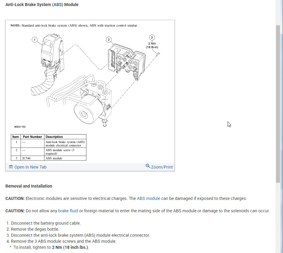

procedure to change out the ABS module?
55,000 MILES • 3.0L • V6 • FWD • AUTOMATIC
JHAMMER66
When I bought my used car the brakes we're slightly spongy but were tolerable but recently I hit a pothole and they became a lot more spongy making me believe that it loosened something at the time of impact that snuck air into the brake line. I've monitored the brake fluid level and looked for leaks and haven't seen any changes so I was going to get the line flushed, and since they're already working on the brakes and my rotors are shot I figure I'd replace those too. What would be the procedure to change out the ABS module?
Dec 21, 2015 at 2:24 AM
Here is a guide that will help with this:
https://www.2carpros.com/articles/how-to-replace-a-abs-controller
Below you will find the process from the manual that will give the detail that you will need to replace the module.
Please let us know if you have other questions. Thanks
