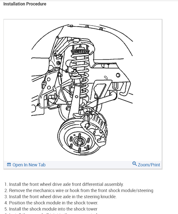

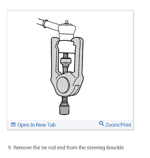

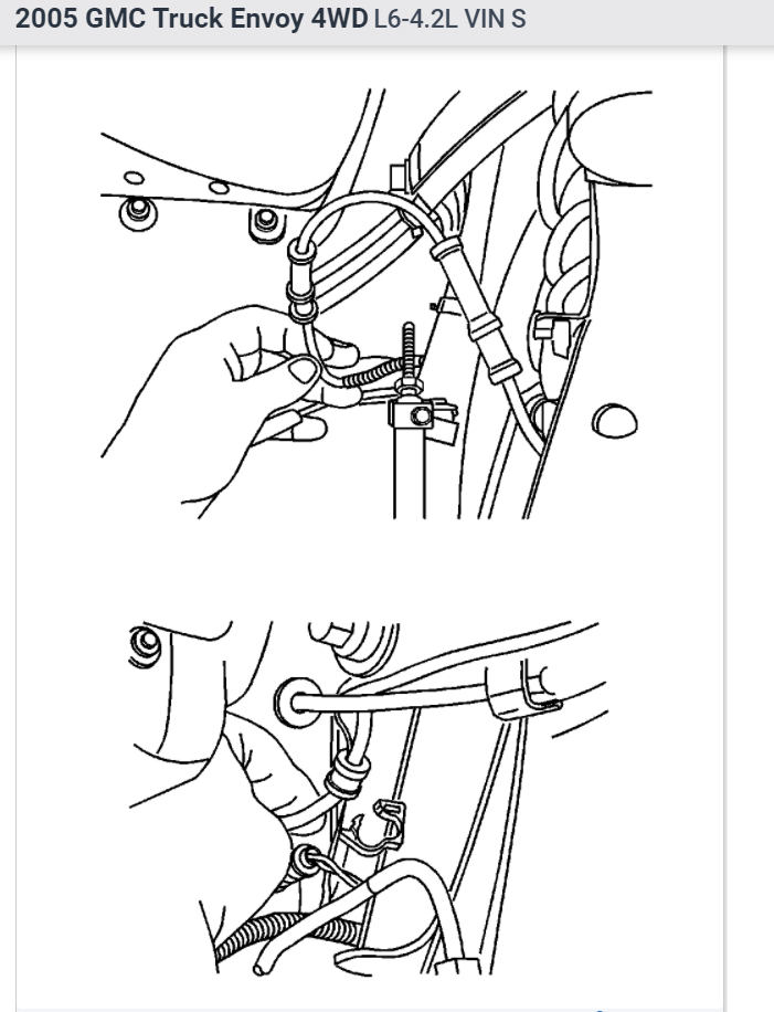

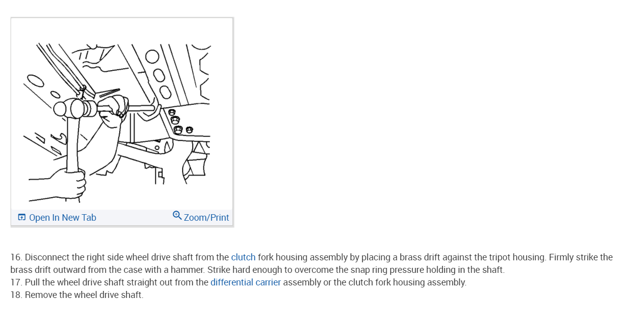

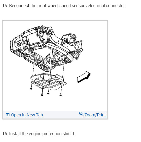

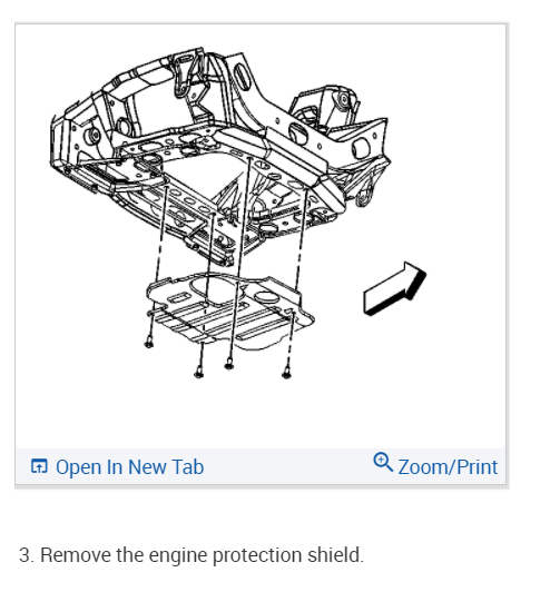

How many hours would it take to remove/replace front axle assembly. Can I get instructions?
Mar 13, 2022 at 5:51 AM
Experienced Mechanic
55,629 POSTS

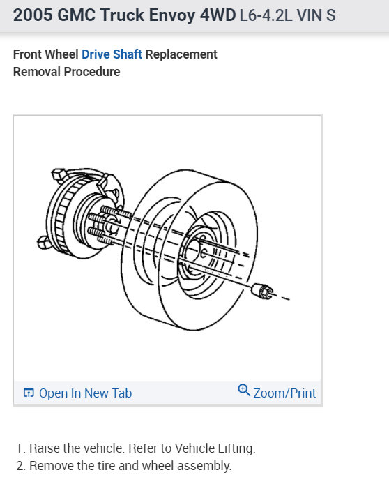

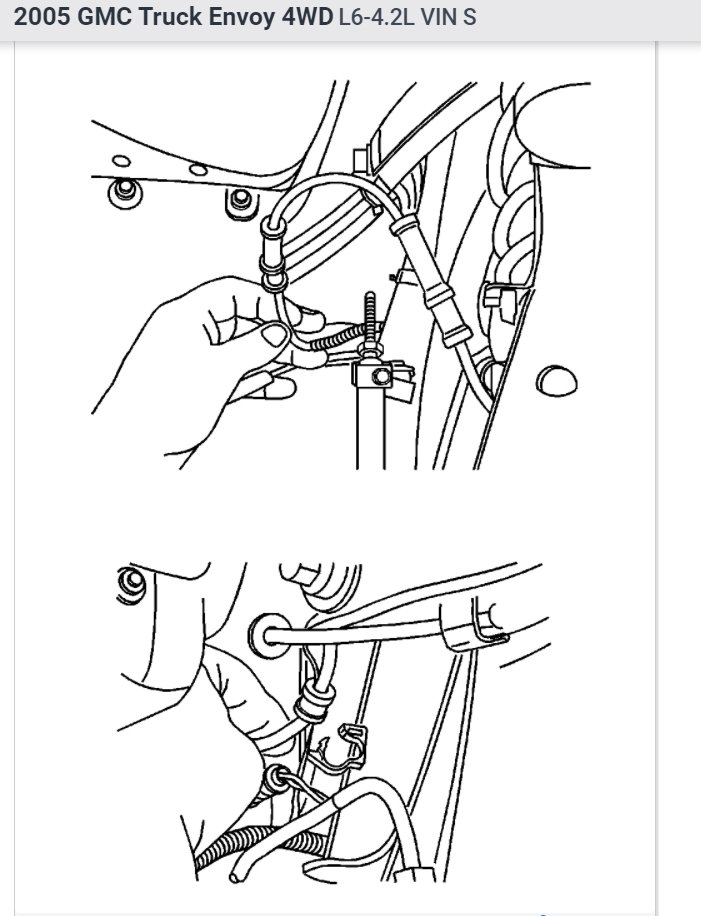

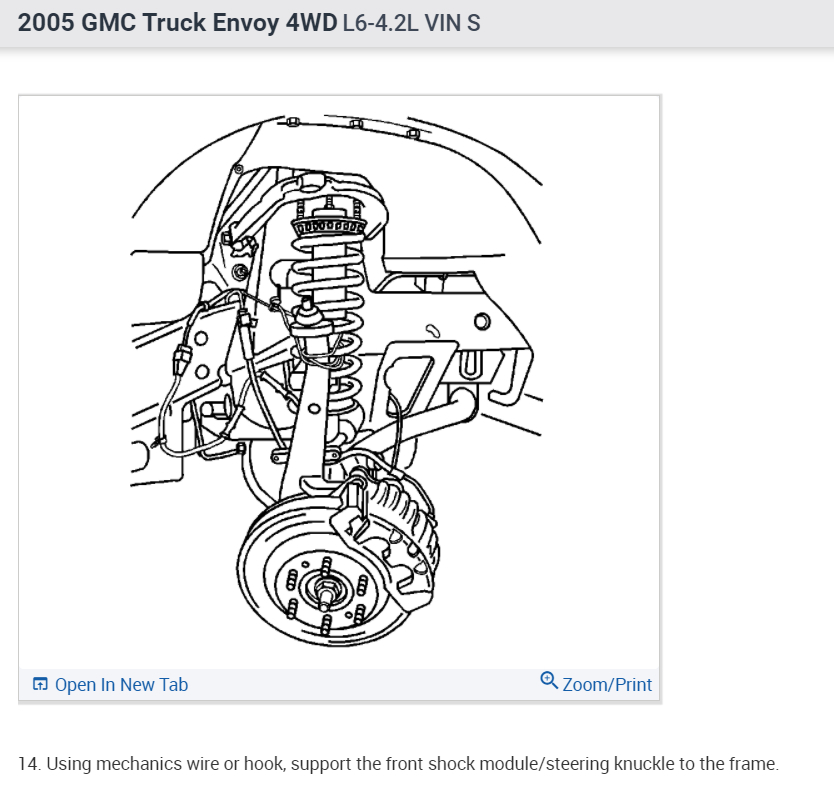

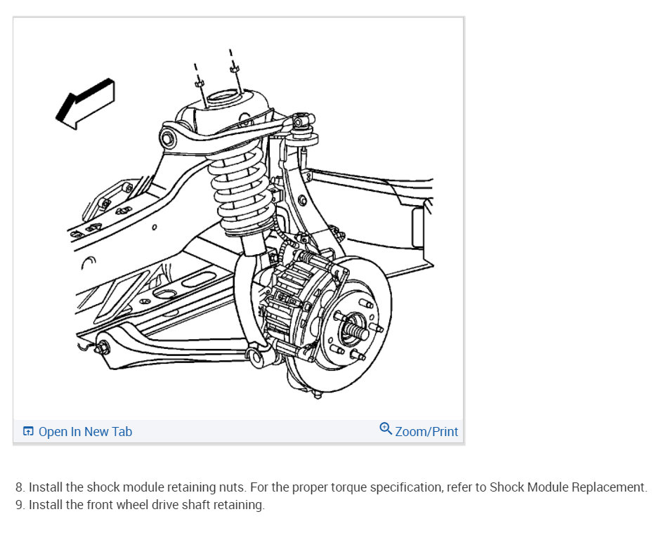

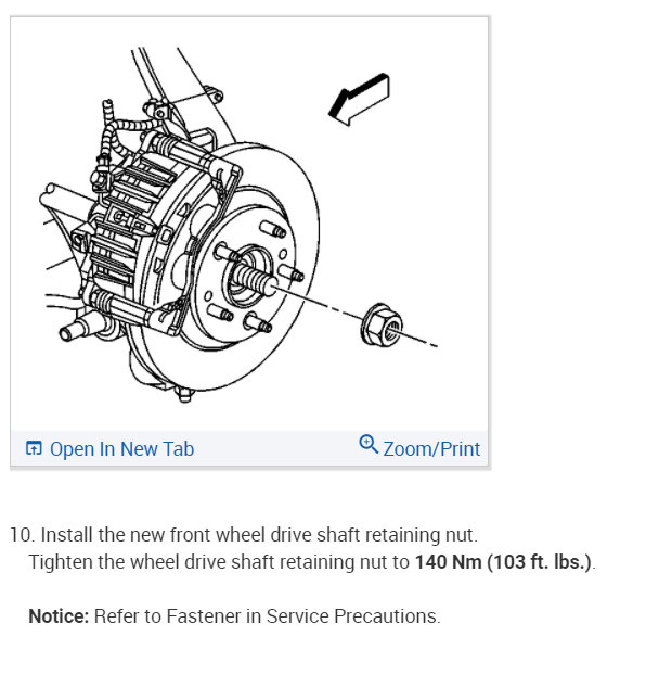

Here are the labor costs and the directions to do the job:
One Side 1.3
Both Sides 2.3
You will need to jack the car up here is a guide for that
Images (Click to enlarge)
