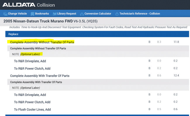

How many hours does it normally to remove and replace the transmission?
Apr 24, 2020 at 7:53 AM
  • 110,244 POSTS
I attached a picture of labor below. Check out the diagrams (Below). Please let us know if you need anything else to get the problem fixed. Let me know if that helps.

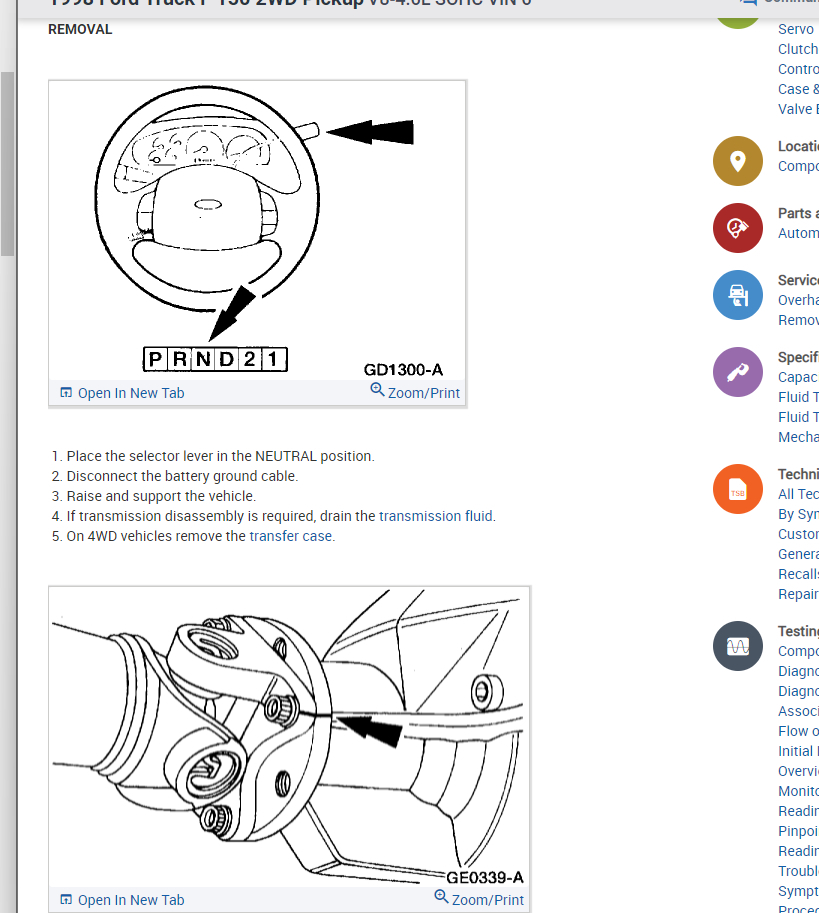

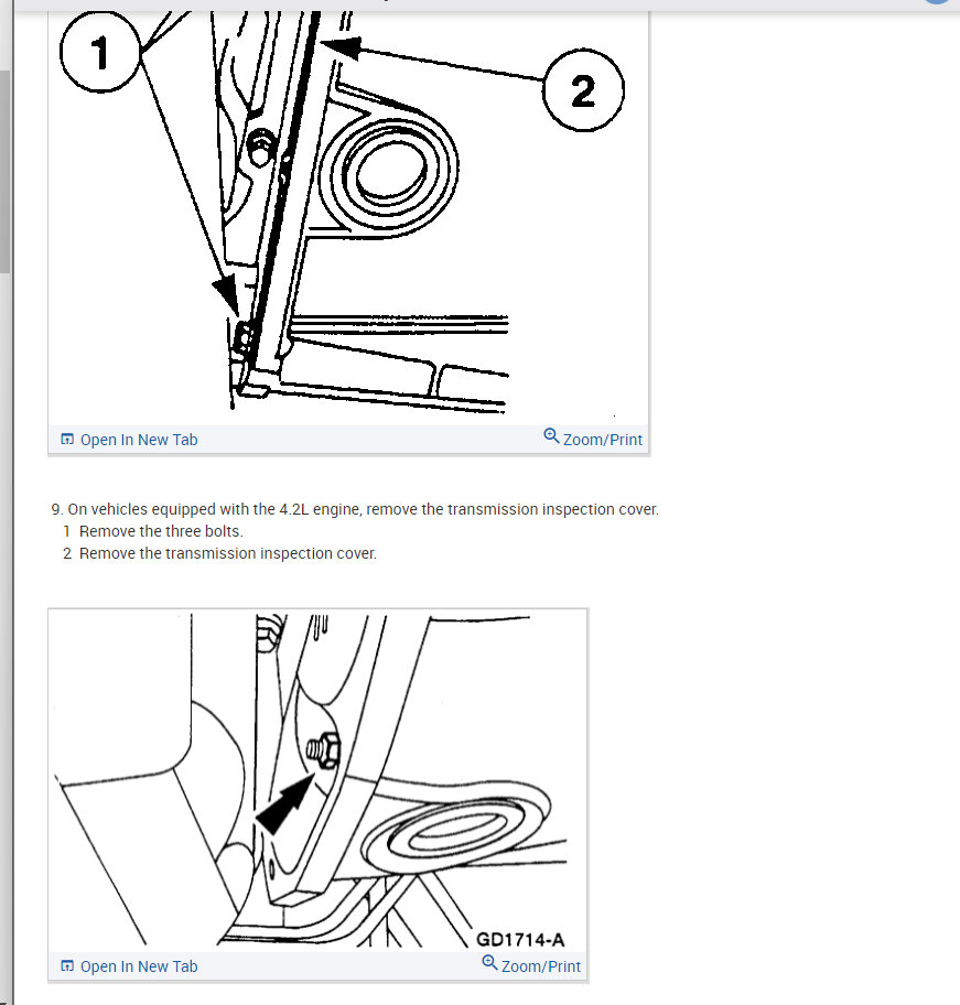

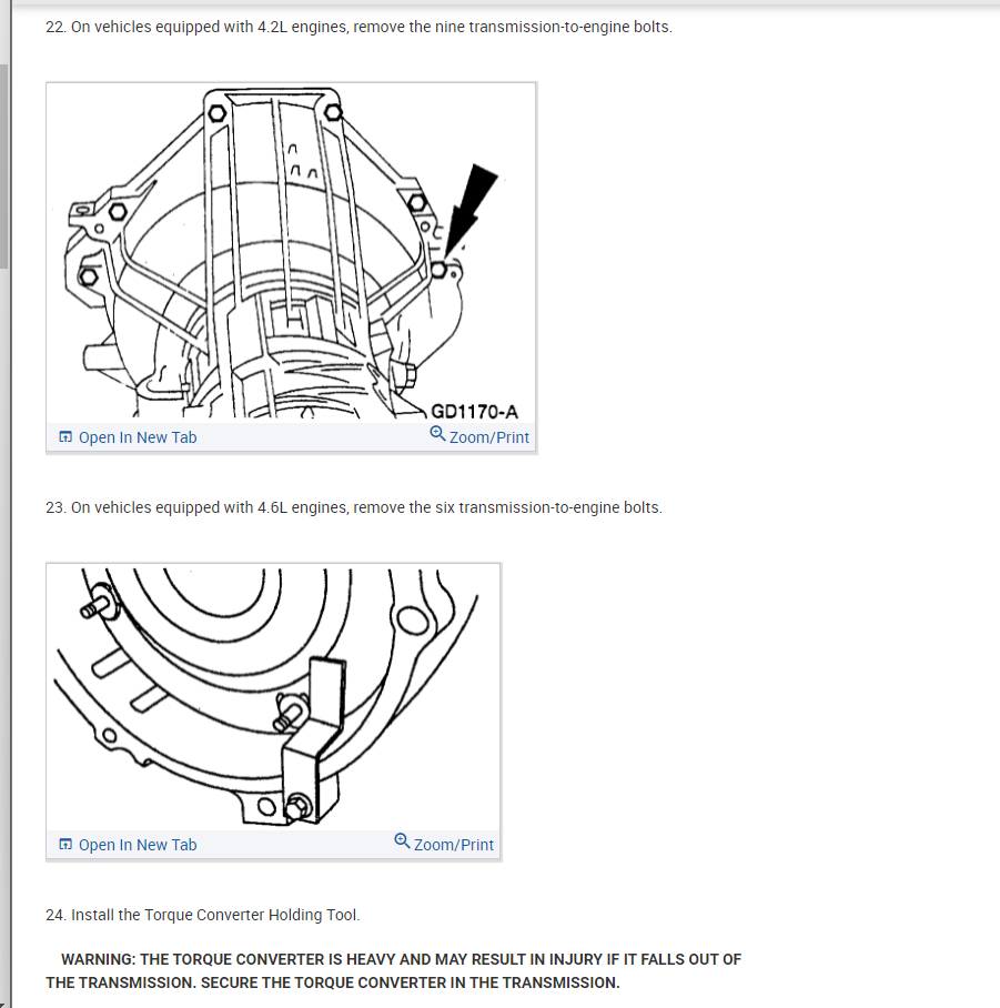

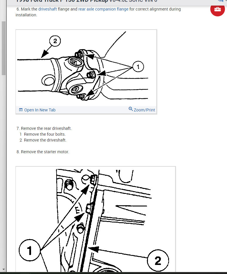

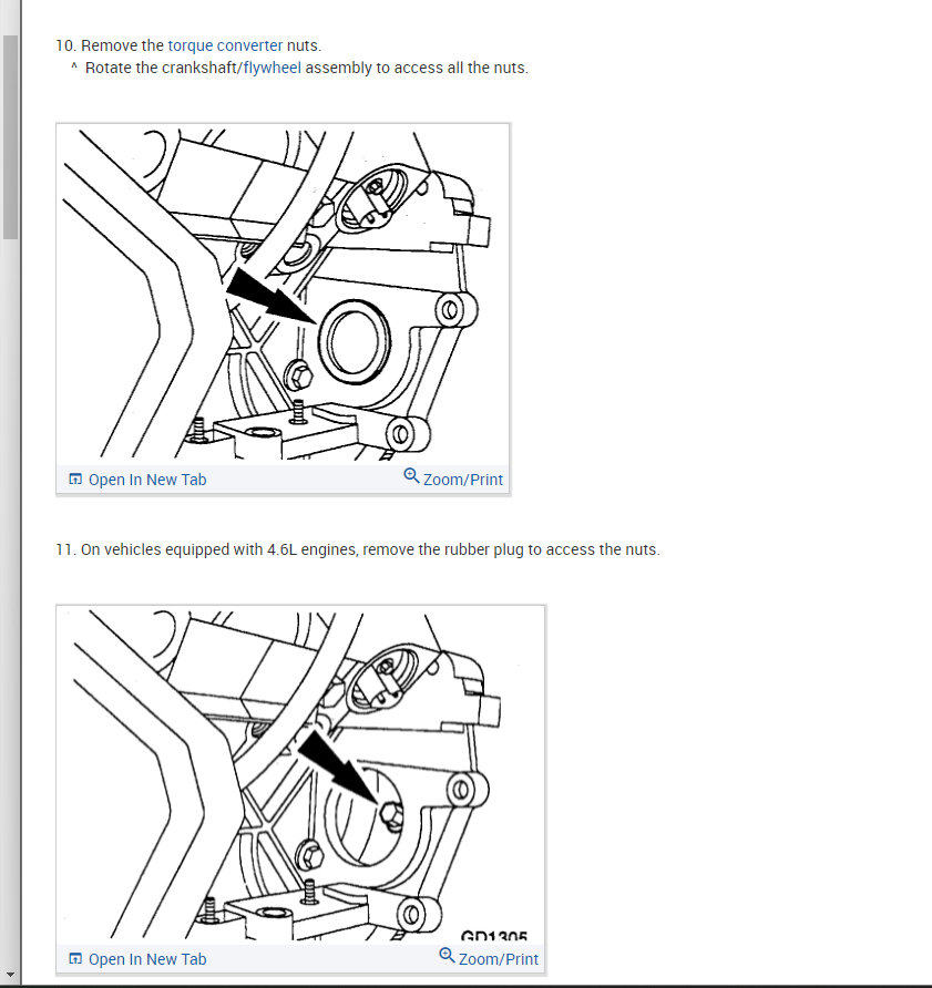

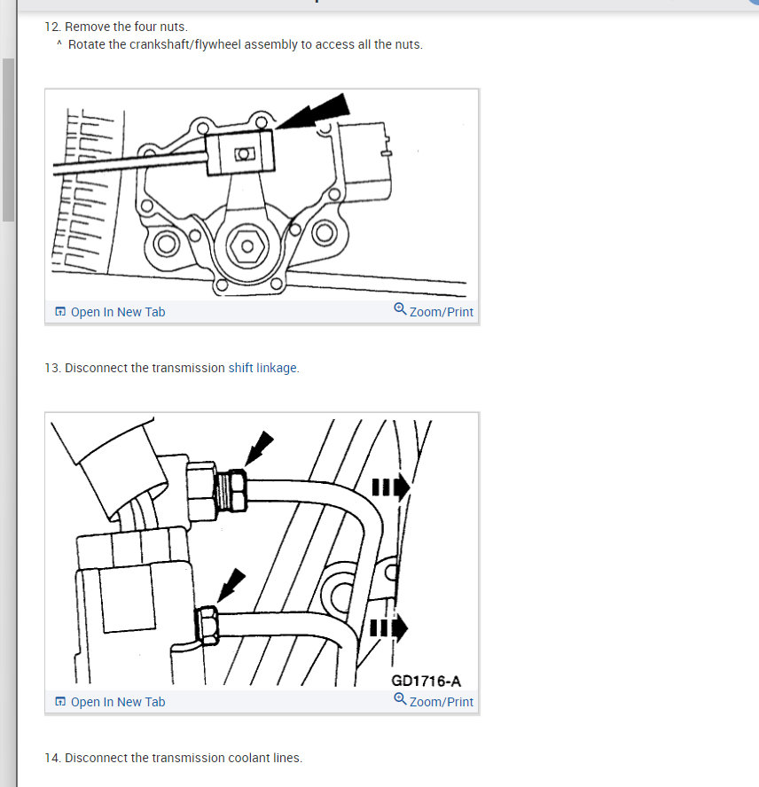

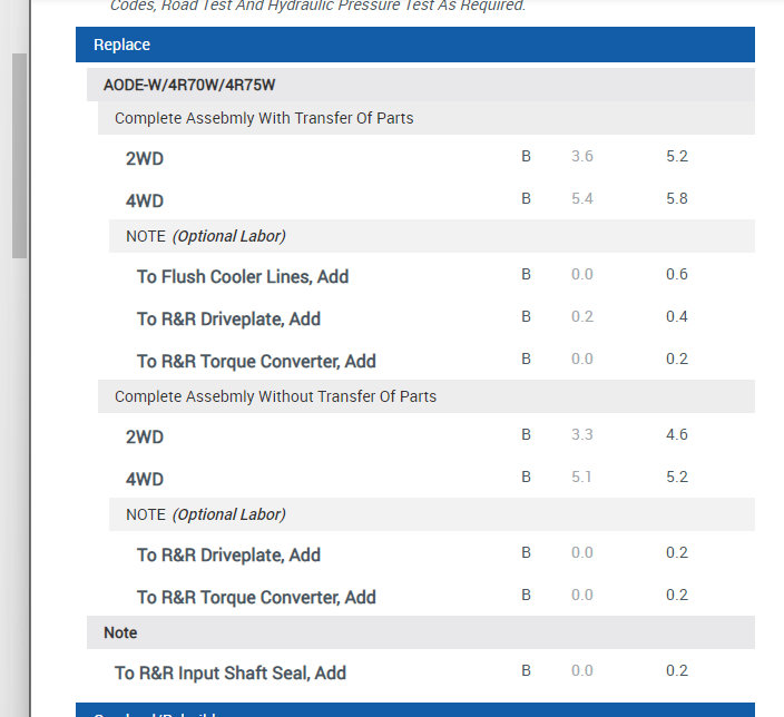

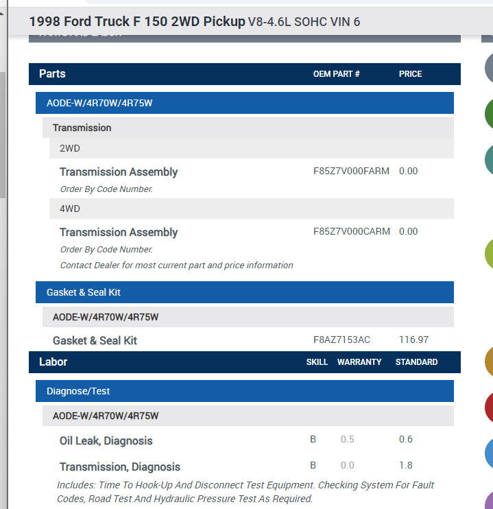

I am trying to figure out the labor hours to move and replace transmission in this truck. It is an extended cab 3 door truck as well.
Jan 4, 2022 at 7:22 AM (Merged)

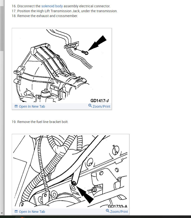

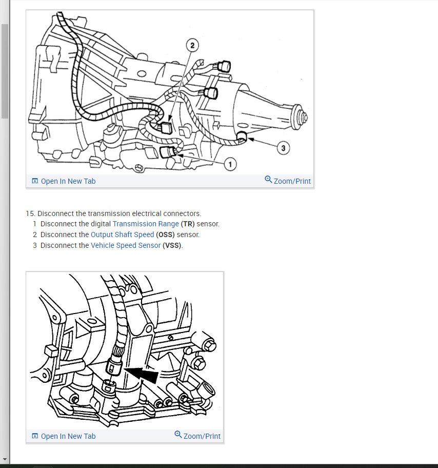

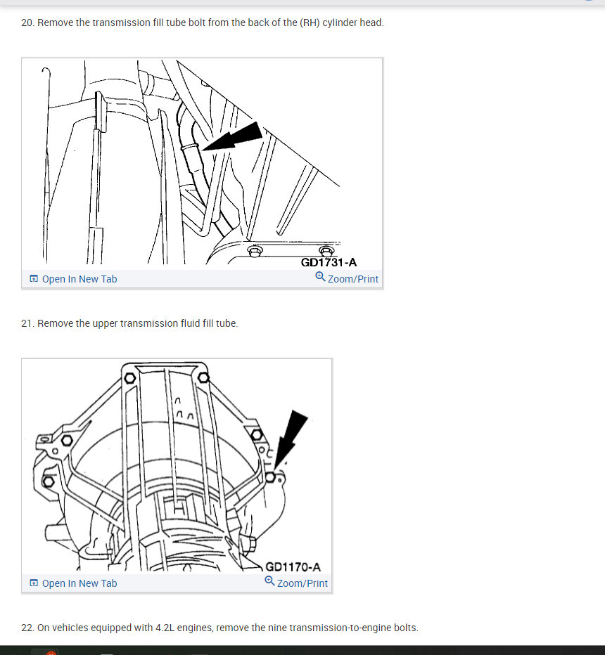

Here is a guide that will help with replacing this unit:
https://www.2carpros.com/articles/how-to-remove-an-automatic-transmission-rwd
I am also attaching all the info needed on part numbers of the units and the labor times. Lastly, I included the process on how to replace the unit. Please run through this material and let us know if you have other questions.
