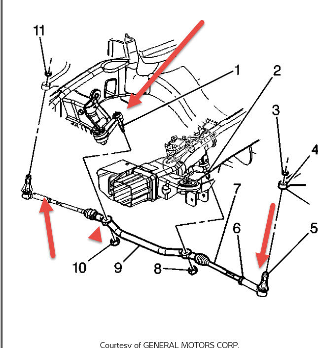

How to replace pit arm
Iner & outer tie rod
Idler arm
Sway bar links
Jan 14, 2016 at 12:44 PM
HMAC300
  • 48,601 POSTS
sway bar links are a bolt in/out thing for pitman arm you need a puller and for tie rod ends they will unscrew but if you get them wrong you will experience heavy tire wear quickly that is why an alignment is a must. you do need special tools for tie rod removal and install. you also need a puller for tie rod removal. arrow points to most components in pic
