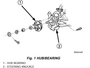

Knocking sound in front right when turning
2002 DODGE DAKOTA
200,000 MILES
DYLAN JACKSON 123
Not quite sure what is wrong, but I think there may be a problem with the four wheel drive on my vehicle (listed above). There is a loud knocking sound but only happens when I am turning it seems like, but I think it is in the front right portion of the truck. If anyone might know what is wrong please let me know. Thanks

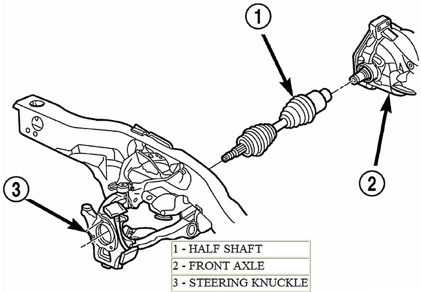

A bad CV joint will cause a clicking noise when turning. Take a look at this link. It discusses symptoms of a bad CV joing:
https://www.2carpros.com/articles/symptoms-of-a-bad-cv-axle-joint
If you find the joint is the problem, here are the directions for replacing the entire half shaft, which contains both inner and outer joints:
2002 Dodge or Ram Truck Dakota 4WD V6-3.9L VIN X
Vehicle » Transmission and Drivetrain » Drive Axles, Bearings and Joints » Axle Shaft Assembly » Axle Shaft » Service and Repair » Axle Half Shaft
AXLE HALF SHAFT
Removal and Installation - Front Axle Half Shaft

Remove hub bearing bolts and hub bearing from the knuckle (Fig.1).
Support half shaft at the C/V joint housings.
Position two pry bars behind the inner C/V housing and disengage the C/V joint from the axle.
Remove half shaft from the vehicle.

Insert half shaft stub through the steering knuckle and onto the axle. Verify shaft snap-ring engages with the groove on the inside of the joint housing.

Install hub bearing onto the axle half shaft and steering knuckle.
Install hub bearing bolts and tighten to specifications.

Considering the miles on the truck, if it has not been replaced, chances are that is the problem.
