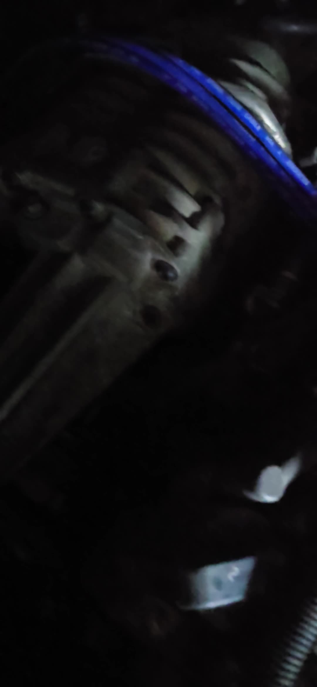

Getting a knocking sound, its not any of the pulleys took the belts off one at a time and ran it for a few seconds to be sure, sounds internal from the middle to right side of the engine. The car is high milage

Yep, I would see if you can hear which side the engine is making the noise and then remove the valve cover on that side. It sounds like a rocker arm is bad or you have a flat camshaft, see if you can find the loose rocker, you might need to "bump" the engine over.
