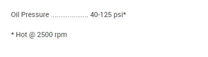

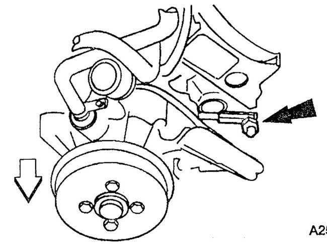

My car started making a loud knocking noise and I found out it was the rocker arms and push rods. so then I replaced them and after I did I turned it on and it continued making the knocking sound.
Apr 2, 2021 at 8:22 AM
Good evening,
I would have a manual test done to be sure you have oil pressure. It sounds like you have no pressure on the rockers.
https://www.2carpros.com/articles/high-or-low-engine-oil-pressure
You can rent the tester at a parts store. Remove the oil pressure switch and insert the tool.to perform the test.
I posted below the location and the needed pressure.
